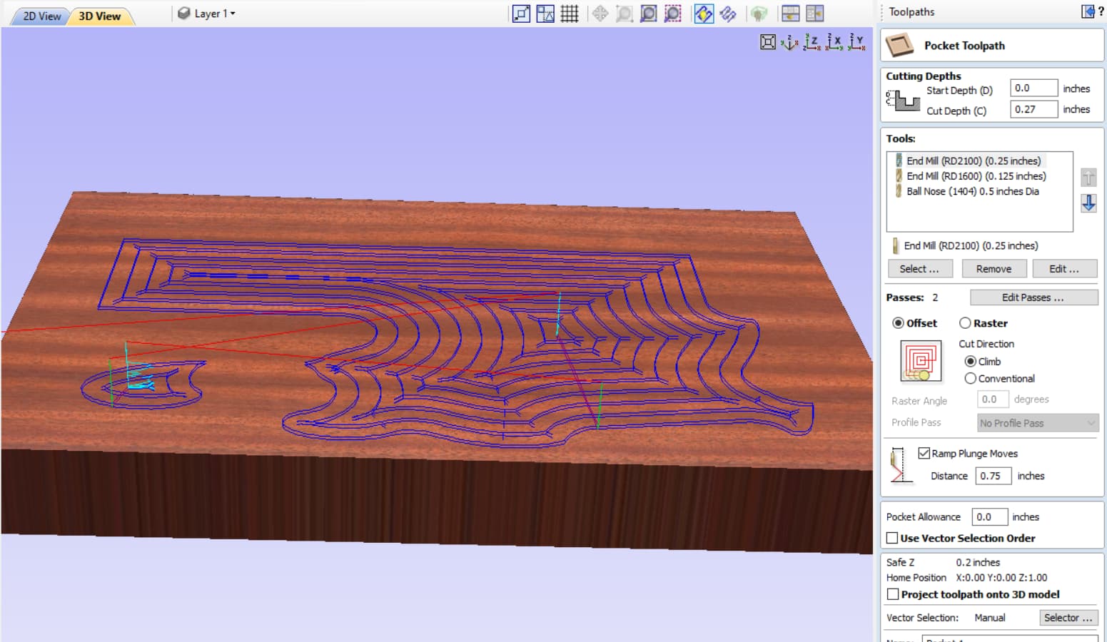

Is this a bug in Vectric or just me (ramp plunge moves)
Look I have my ramp plunge moves set to .75 yet the plunge in the middle of the cut is a vertical line but its worked on the plunge in the bottom left WTF. I have tried recalculating all paths but still no joy.
If you can fix, you are legend.

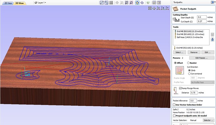

I reduced the stepover of your larger clearance bit slightly — 80% to 75%. But please don’t ask me to explain the math behind why this works. All I know is the issue arises from using a circular/offset clearance toolpath and the way Vectric calculates the corresponding spiral ramps.
Gift (fixed-ramp).crv (901 KB)
Alternatively, you can toggle the clearance path to raster mode and get normal ramps.
