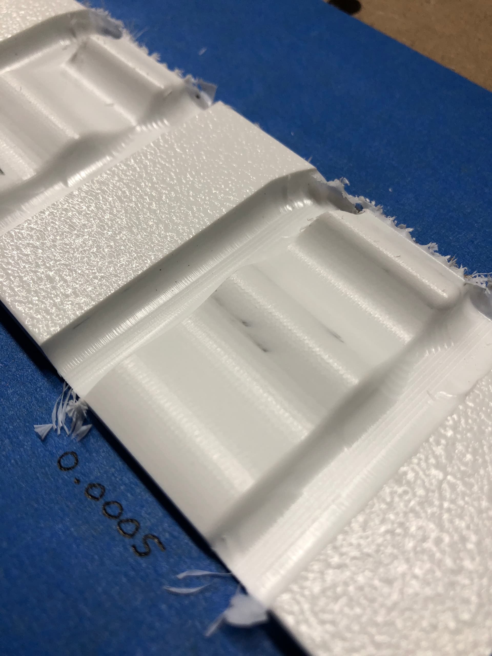

What I know so far:
1F uses the Buildbotics open-source controller which does not support ARCs. ARCs are converted to line segments by the controller, which obviously have a “resolution” as opposed to a true curved tool path. Short of changing controller, 1F has no realistic avenue to address this other than hope for Buildbotics to include ARC support in a future firmware release.
In the Settings screen, The Max-Deviation number dictates the allowed deviation from the true path the controller is allowed to make when converting ARCs to line segments. My machine was set to 0.05 out of the box.
Below are some tests I’m doing to find the ideal settings for my needs. I cut plastics so will be interesting to see how these numbers look in metals which will likely be more demanding.
4" Diameter ARC on XY Axis:
My “Benchy” for testing ARCs on Z axis:
I’m currently testing ARCs on all axis, so far the results don’t seem to be as predictable as the above tests. I’ll post some pics later on.
I’m sure there are other ways to work around this limitation. I’d be curious to find an ARC-to-Lines software that could possibly provide more control over the conversion.
Please share your results and settings you’ve found to work best for you.

OK so here’s today’s comparison, very happy with the new results!!
OneFinity “Out of the box” settings:
Max-Deviation: 0.05
Microsteps: 16
OneFinity Custom Settings:
Max-Deviation: 0.0005
Microsteps: 32
Z-Motor Max Velocity: 1m/min (Doing this due to some chattering on Z axis, may be unrelated to obtained results)
MPCNC/Marlin cutting a true ARC: (You can actually see the polygon resolution of the STL I’m using)
Really happy with these results! Some notes to keep in mind:
  • The 1F controller resets the Max-Deviation setting to 0.05 at reboot.
  • The Max-Deviation setting must be set before loading the GCODE as this is when the ARC conversion occurs.

This is where I’m experimenting the most:
@Tuvix72 My thinking is that a finer (.0005) max deviation setting in the controller won’t up-convert the lower resolution file of the coarser, built-in .002 post processor. I am thinking the max deviation setting will only down-convert or limit finer resolution files as it is a minimum/maximum (however a person wants to view it) setting. ie. 0.0005 programmed in post and max.dev setting of .005 would down-convert the finer post processed file too the controllers setting of .005 as this control setting threshold is violated by the finer program. Conversely a coarser .005 programmed post would remain that resolution if the setting in the controller was set at .0005 as the coarser .005 programmed file doesn’t violate the settings of the minimum/maximum threshold.
“My thinking is that a finer (.0005) max deviation setting in the controller won’t up-convert the lower resolution file of the coarser, built-in .002 post processor.”
But the post-processor is still generating G2/G3 arcs in the GCODE. The 1F controller is then going to convert those arcs (think vectors) to line segments (think raster) at the resolution set in Max-Deviation.
So when it comes to arcs, that last conversion to line segments is where the problems are introduced. The 1F controller does not modify or re-process linear code, so that resolution remains true to what the post processor generated.
Any way you can set your post processor to convert arcs to lines and generate a GCODE that requires no conversion by the 1F?
