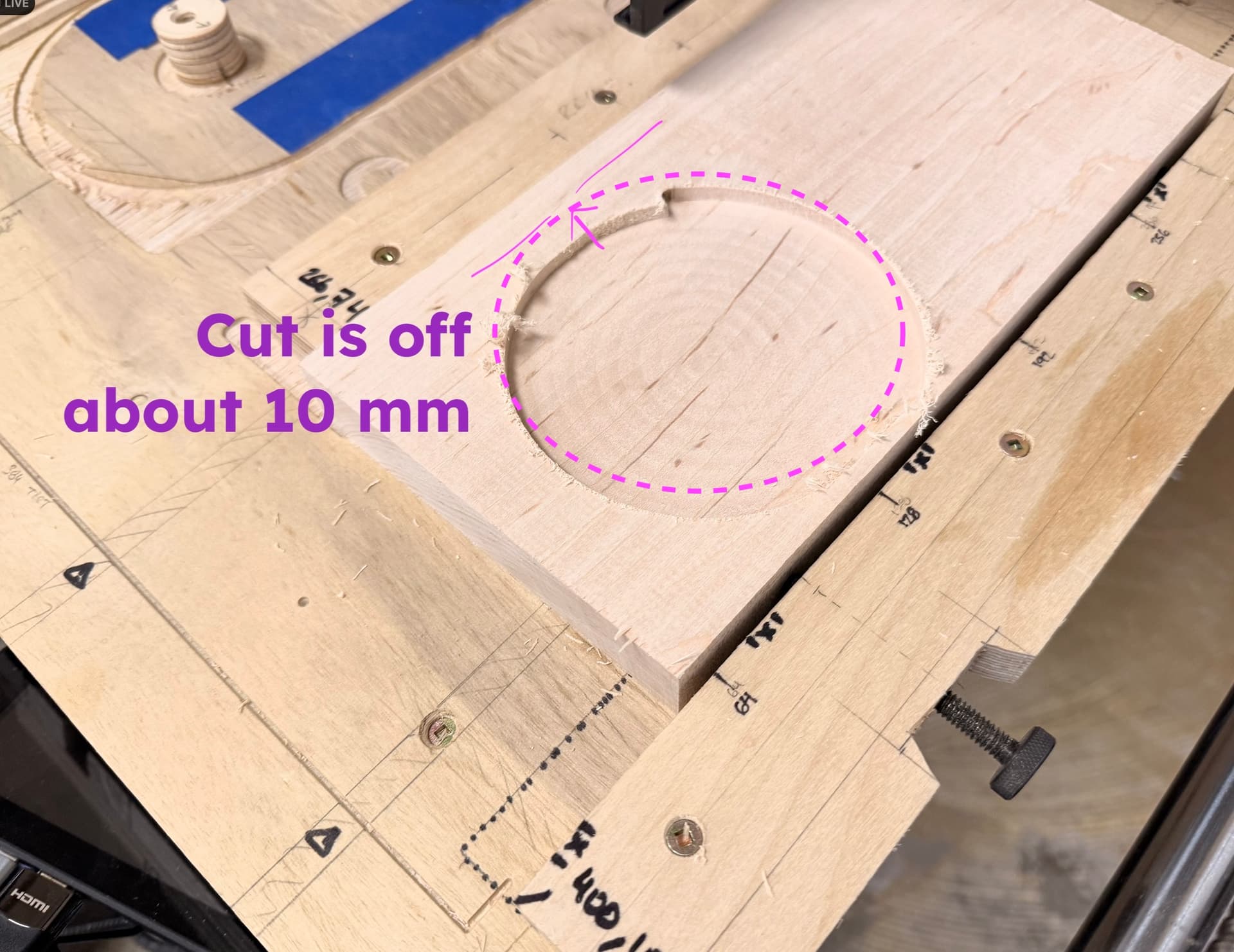

Machine losing track of X/Y, 10.8" touchscreen going blank/black/blue screen
I’ve been facing some odd issues lately. During a cut the machine will be carving 10-15 mm off from where it’s supposed to be. Intermittently the touchscreen will go black, or it will start back up with the blue screen. Occasionally the cut gets off course.

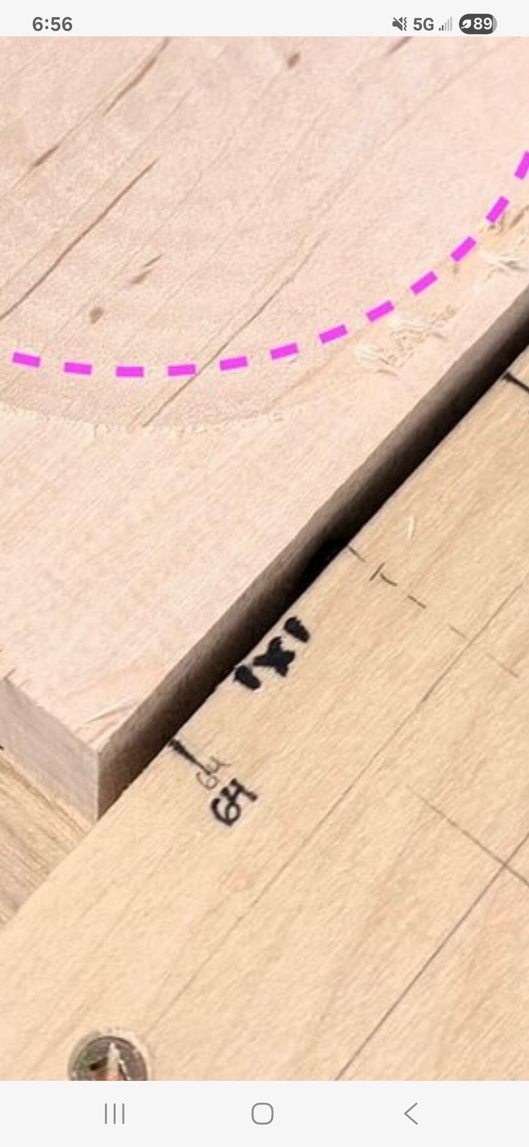

Unless you mounted it this way…..what’s this gap here?….
No, it’s supposed to be that way. I make wood blanks between 128mm-134mm wide. The left edge registers perfectly against a rail of my “spoil jig” (combo spoilboard and jig), the right edge is just a gap of whatever width the board is.
The problem was that the rail is exactly at 266mm from absolute 0mm. And occasionally the CNC lost track of the X or Y position and started carving well away from the rail.
I just ran another soft maple carving right now and going slower overall made a perfectly-registered cut. -shrugs- :woman_shrugging:
