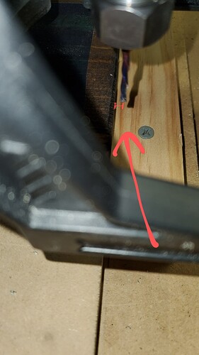

I’m not sure if this is the same issue or not, as I wouldn’t expect the machine to hit the end of the rail at 29 inches, but it does sound like something is stopping it from moving all the way to the opposite end. Sometime this is due to the two Y railes not being aligned, or when dust accumulates on the end of the rail, robbing you a couple mm in travel.
Try this, home the machine, then move the machine all the way back and right, then back home again. See if it comes back to 0 or not. If it doesn’t you’ve probably lost a few steps when reaching the far end of one or both of the axis. If that is the case, you can adjust the soft limits of the machine to adjust how far it travels on the axis. I have a brief part of this video showing the process:

Forgot to mention, I’ve also experienced loss of steps during cutting operastions when:
  • Trying to push the machine too fast on tight radii
  • Setting the Max-Deviation setting too high
  • Current settings on the motors was too low (also effected stall homing occasionally, especially on cold days)

having the same issue but mine is off by almost .5 and its the whole project. here is a photo it should of been centered but is is shifted to the left by .5 inches. cant figure out why it is doing this. and if I send it back to zero it is off by .5
