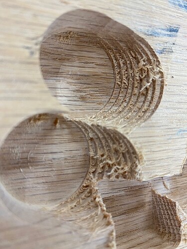

Has anyone experienced chatter when cutting an internal circle? I was cutting a concentric circle and a counterbore using a pocketing tool path and the machine starting chattering severely. I thought maybe a dull bit or feed too fast. I changed to a new cutter and iterated the feed speeds with no success. I did a test of a square pocket and had no problems? I have checked all fasteners and all are tight? NEED HELP!!
also the steps in the photo is the movement in the machine as it started to chatter.
Is it doing something like this? If so, it’s been discussed in a couple threads. Not sure if anyone has pinpointed the exact problem.
I was having the same problem when I was using the inches post processor from vectric, It was a pocket circle too, something like yours! Then I started using the mm one and the problem was no longer there. I was also using gcodes from Easel and there was no chatter/missing steps at all. Prior to that, I checked all my wire connections, a loose wire in the plugs can also make that happen.

We identified an error in the Vectric post processors that introduced chatter. Please delete your onefinity vectric post processors, restart your computer, then redownload the vectric post processors from here (we over wrote the bad ones):
and reinstall them to vectric. The issues of chatter in circles should be gone.

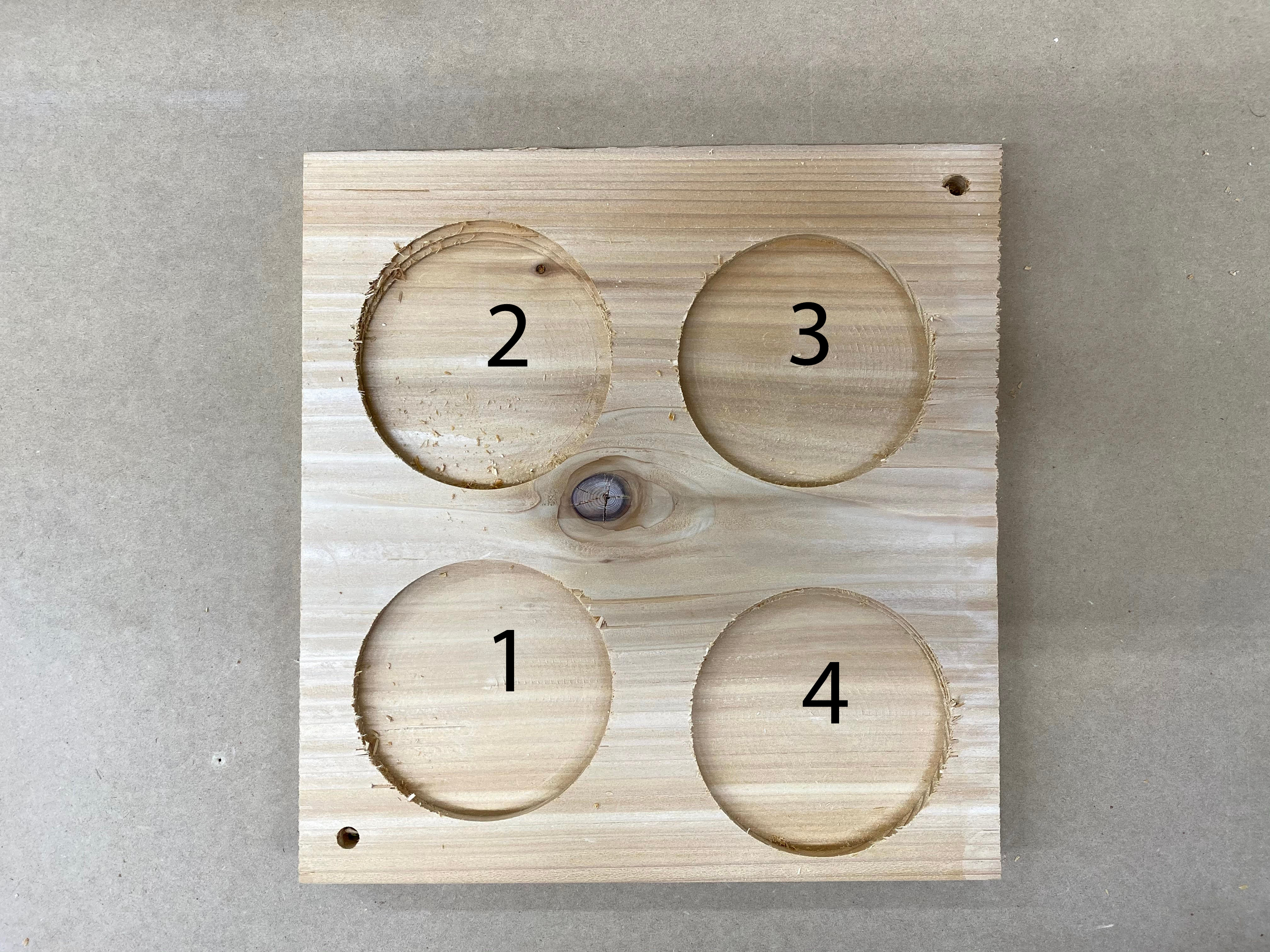

I had the same problem and solved it by going to raster cut with finishing profile. After reading this thread I downloaded and installed the new post processors and thought I’d give it a test. Using a piece of soft cedar I cut a series of 98 MM pockets 7 MM deep in 3 passes each as shown in the photo. Pockets 1, 2 an 3 were modeled in VCarve Desktop with the units set to metric; Pocket 4 had the units set to imperial. All were cut with a .25" upcut endmill with the router at ~13600 RPM, feed rate at 360 in/min and plunge rate at 175 in/min. Pockets 1, 2 and 4 used the inch post processor. Pocket 3 used the MM post processor. Pocket 1 used a conventional cut offset path. Pockets 2, 3 and 4 used a climb cut offset path. There was no chattering for pocket 1. However the chattering returned for pocket 2 when I switched to a climb cut. The chattering disappeared when using the MM post processor with a climb cut on pocket 3. The chattering reappeared when modeling in imperial units for pocket 4 and using the inch post processor with a climb cut. After all four pockets were cut, the Y zero point had shifted about 3/4" in the negative direction.
I reran my project last night using the mm post post processor in vcarve. I ran 8 different counter notes with no chatter.

I believe this issue has been resolved with the latest beta firmware update. @OnefinityCNC can you confirm this was addressed with:
“Reduce Max-Velocity from 12.75 to 10. Some machines lost steps with rapids being so high (mimicking bad wires)”
with the new post p and 106 beta, it should be resolved.
