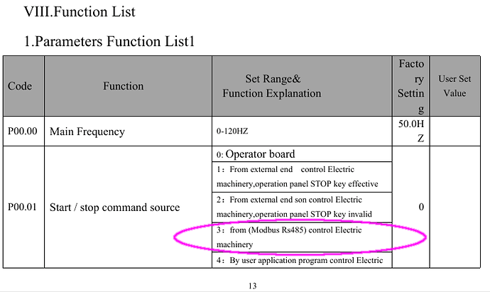

if you want the VFD to be controlled by Onefinity Controller via RS485/ModBus on the Breakout Board Adapter, according to YL620-A Inverter Manual, you will have to set “P00.01” (Start / stop command source) to “3” (“3: From Modbus Rs485 control Electric machinery”). I do not own this VFD, but I just had a look at the Manual.

If you set the parameter P00.01 like described above, and the Serial Communications Settings P03.00 - P03.04, you should be able to “Run” and “Stop” the VFD on the touch screen of the Onefinity Controller.
But if you have a spindle connected to it, be sure to have configured the other parameters according to your spindle manual!
Also to control Spindle speed (=frequency) by the Onefinity Controller, you also have to set “Frequency Source Selection” to “(ModBus Rs485) Given frequency”.

is the manual you show on the picture a manual that you own? Unfortunately, the YL620-A Manual available at buildbotics.com is obviously made using OCR with some errors. Your picture shows differences also. Would you mind to scan your printed manual (if possible using a flat-bed scanner)?

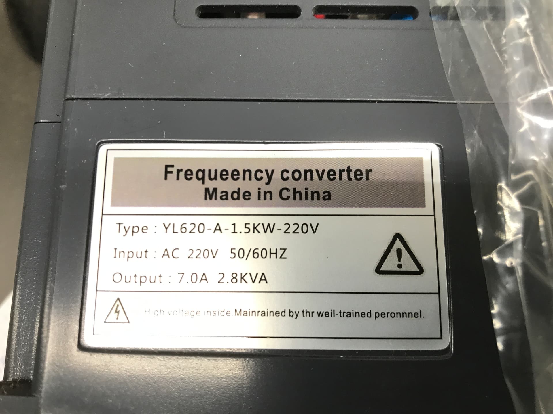

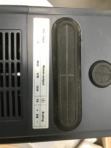

please would you mind taking a picture of your VFD’s Identification Plate? I dont’ mean the plate with the “YL620-A” on it or the one with the warnings, I mean the plate with the Manufacturer and the Rated Parameters, usually on the back, the side or the bottom of the device. I thank you very much!
That is all labels on case
Hey David,
Hah! I suspected that. No manufacturer.
I don’t think Yuyong industry is the manufacturer of these devices. They once sold them, but apparently no longer at the moment. At least not individually.

Are you sure you want all 32 pages. I don’t have scanner but could take photos like the two above.
