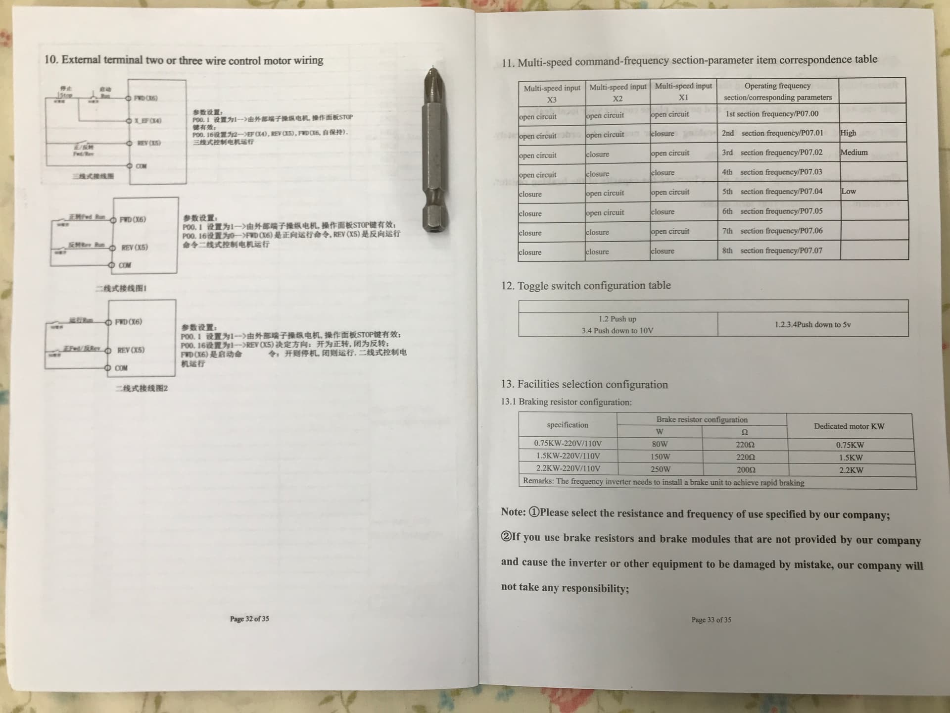

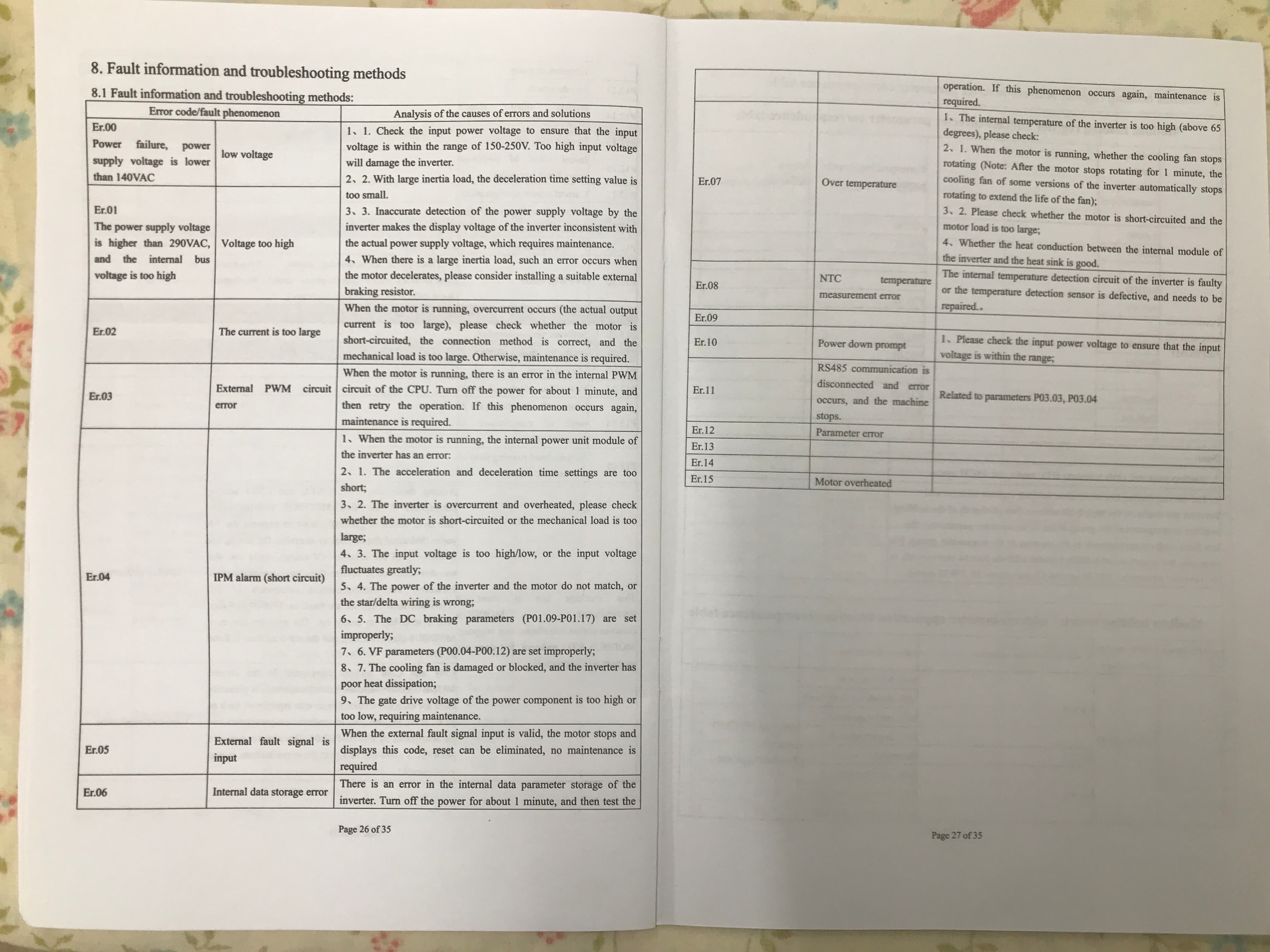

Maybe if you photograph the manual, maybe it can help. I’m not sure if it will, but the YL620-A manual mentioned above seems to be flawed and incomplete (cell phone photos would be great).

It looks like I need to take a photo of 32 and 33 again when I get back to the shop . So sorry about the poor quality of photos. I hope they help if you need so reshot just holler.

well we don’t have to win an art award :slight_smile: I can read everything but if you’re at it, pages 10 and 12 with the picture descriptions are a little unsharp. Thank you again!

Hey Gary,
this is a YL620-A manual from bulkman3d.com that I know but I did not use or cite from it since it neither seems to be original nor, as we have seen above, is identical to one printed that is delivered with a VFD.
As you can see, there are many modifications on that manual, first of all there is a column with user settings on the right that seems to fit a bundle offered. Some words are higlighted also.
On the other side, if you look at Dave’s photos, look at page 2 “Simple parameter setting” with three columns on the right for three possible user settings. This is an example for something missing on the version you mention.
Or look at parameter P00.16. Where are the explanations for 8.) like you can see it in the YL620-A Manual available at buildbotics.com on page 14? Also where are the explanations for P00.17-P00.20? There the bulkman3d.com version shows just a “##############”. So you see, this can be no reliable source, it’s not original nor do I know anything about the modifications.

I think you have it now, if not just ask I will keep the manual out for a couple days. I really hope this is helping.you ROCK!!
Hey David,
unfortunately it is a bit difficult though. Usually I’m used to pull very good quality out of everything, but it’s only when adjusting curves that I see that your JPEG compression artefacts are too high to easily read the letters in the table’s heading column with the dark background:
But don’t worry now, I think I can read enough information to get an idea and try to find out which options we need or correspond to other VFDs I know. It’s just that we would need better quality to show it to others.

The manual I am photographing is like that dark background and very difficult to read first hand .I’m sure the photos don’t improve on that problem

Hey David,
I just went through all images to see what I can read and what not:
I literally can’t read the table’s heading column with the dark background on page 2:
The print has very bad contrast, I know, but the reason that this photo is so poor is that the amount of compression artifacts increases with low light conditions. Please, could you make more light and re-do page 2/3?
Also pages 10 and 12 are unsharp (ipad not totally parallel to table). Please would you mind redoing them? Thank you!
Here is an example how enough light makes good quality, here page 19 on the right is good:
One question, did you change the picture size while shooting? From page 20 on they seem to have the double dimensions.
Anyway thank you very much! I think with this I will be able to have a reference that one can use.
