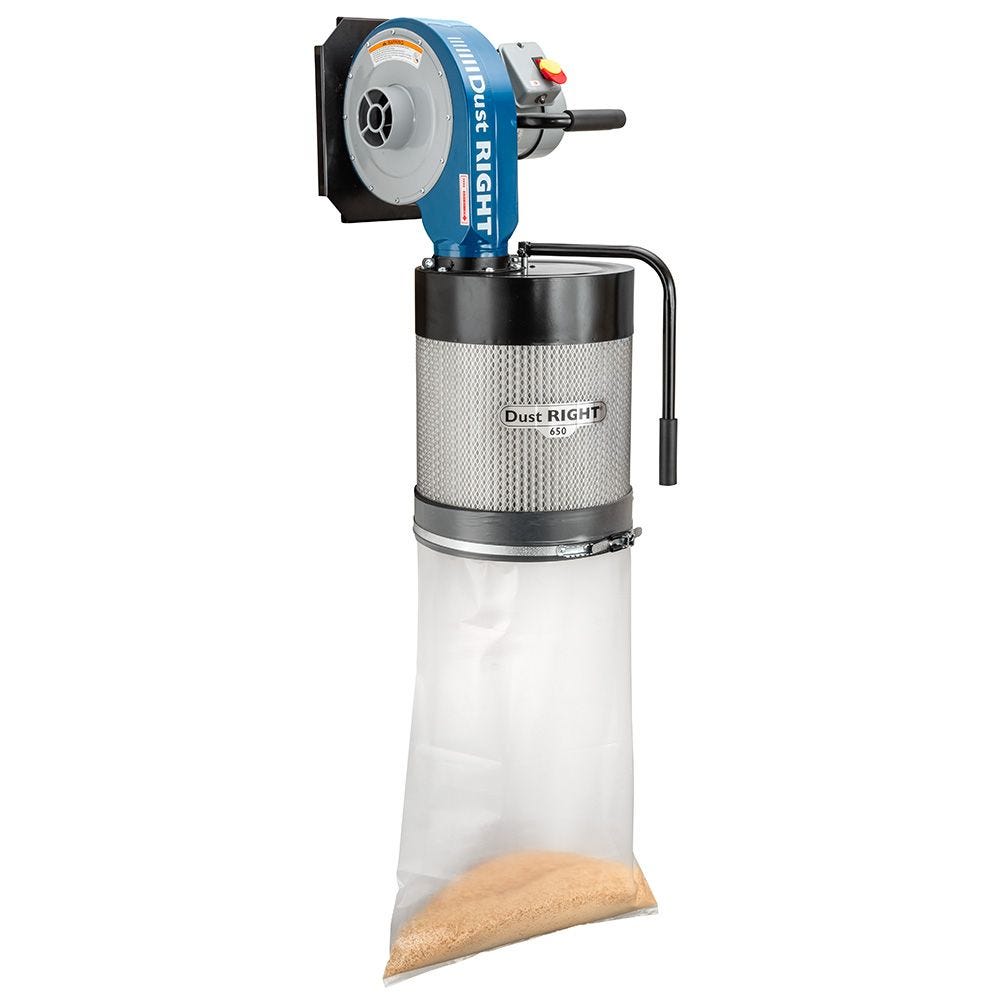

Ok guys this is the dust collector I went with
It’s 1hp, 7amps, 77 decibels, 1 micron canister filter, 537CFM, and a cast aluminum impeller for $459.
I have the much cheaper Harbor Freight version and had to add the pleated filter. You’ll like it much better than a vacuum. With a good boot it’ll suck all but the largest chips in. I mounted mine up high right next to the machine with a short section of hose between the filter and the vac so the filter is easy to get to and a little further out of the way. I think you’ll be happy with your choice.
You go from a 4” to a 2” hose or did you get boot with 4”?

That looks like it. Mine is black though. I got the filter from Rockler because I had a 20% off coupon and I was at the store. They come in two styles. One with the 4" hose mounts to the center of the top and one where it mounts on the edge of the top. They also sell one for a larger collector that will work but costs more.

One of the advantages of going with a pleated filter is that you don’t need a separator. The bottom of the filter has a clear plastic bag to collect everything. Even the dust the built in filter brush knocks off falls into the bag. While they are nice a separator eats up room and they reduce how much air the DC can pull. Plus the clear bag makes it real easy to see how close it is to being full.
