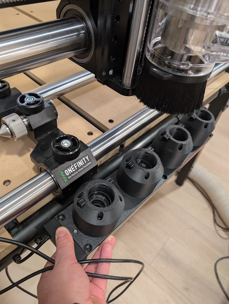

how about mechanically … will the rotary tail stock and the ATC base not interfere ?
I just received my QCW mount for the Easy ATC and it definitely interferes mechanically with the Rotary QCW mount. Not sure if I am going to use the ATC anymore. I wonder if Onefinity has a solution in mind.

or we find a solution to move the rotary up a bit (on Y axis), enough for the tailstock to clear the ATC support.
That was my suggestion with respect to following the alternative installation method described by Onefinity.

I know I shouldn’t assume, so I will reach out to them directly to address this oversight. I was explicitly told that the two options would work together when i purchased both with the QCW options. If they had to redesign they should have accounted for that. I am wondering if they are willing to provide spacers to the Rotary, an offset version of the plate that will allow for the them to coexist, or ultimately a refund for the extra funds/cost of the QCW hardware that was charged.

After the redesign of the qcw mount we realized they don’t work together. We’re working on some adapter blocks that will ‘push’ the rotary backwards a bit to clear. Once we finalize the design, we’ll post up the stl here for those to print.
Then we’ll get them off the be manufactured and put them up on our website.

Here’s a spacer block stl you can 3d print for those who already have the rotary qcw. it pushes the rotary back so it will clear the ATC.
In the future, the current spacer block that’s included with the rotary qcw mounts will be the combined lenght of the current short one and this extender so this issue will be resolved.
what screws we’ll need to attach this new spacers ?
They will need to be m4x60mm
