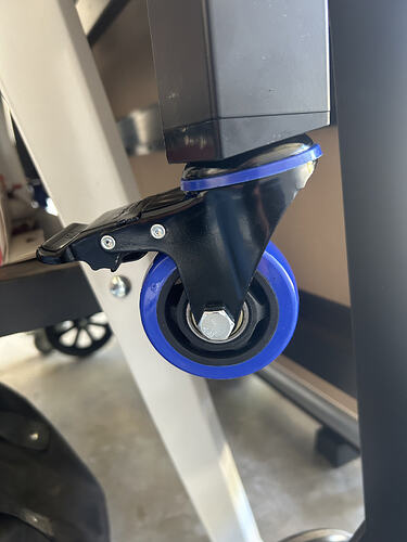

After finally finishing the assembly of my Elite Gen 2 WW with the rolling/folding stand (electronics still pending), the first thing that hit me was the weight. Getting it off the ground solo was brutal — I managed it a couple times, but never felt good about it, and I can’t always count on having a second set of hands. Since extending the legs requires lifting, I knew I had to find a better solution or the machine would just collect dust in the corner.
Inspecting the bottom of the legs, I noticed what appeared to be adjustable feet threaded in. I unscrewed one off with a 9/16" socket and found the stem was 3/8"-16 — oddly imperial for a machine where everything else is metric. A little digging turned up some heavy-duty dual-locking casters with the same diameter, thread pitch and a 1" stem, each rated to 400 lbs.
Here are the casters I got:
https://www.amazon.com/dp/B0DY598L1W?ref=ppx_yo2ov_dt_b_fed_asin_title&th=1
The casters threaded directly into the legs without any modification. The one thing I wanted to preserve was the stability the original feet provided — they have a lip that extends up into a cavity in the leg for rigidity. To replicate that, I made four spacers from some scrap oak: 1.75" x 0.375 with a 13/16" bore to clear the nut and washer (a 3D printed version would also work). A dab of blue Loctite on each stem, and they were locked in.
The result: my WW rolls effortlessly around my small shop, and with all four casters locked and the legs set to permanent open and locked, the machine is solid. There some minor micro movement , but that is to be expected with casters. I’ll know more when I do my first test cuts, but for now, everything looks good.
This worked for my setup — your mileage may vary.

When this caster is in the raised position, obviously, the stand is off the floor. When you lower it, does the stand come in contact with the floor? My only concern would be the lateral force on the pivot point of the caster. Can it handle that much weight?

Okay, I changed my mind. I’m trying something else. I ordered some leveling stem casters.
They only came in 1/2" and m12, so I am going to put in some m12 to m10 reducer bushings and 2" m10 threaded rod. I should then be able to screw them into the m10x1.5 leveling feet holes on the bottom of the legs.
