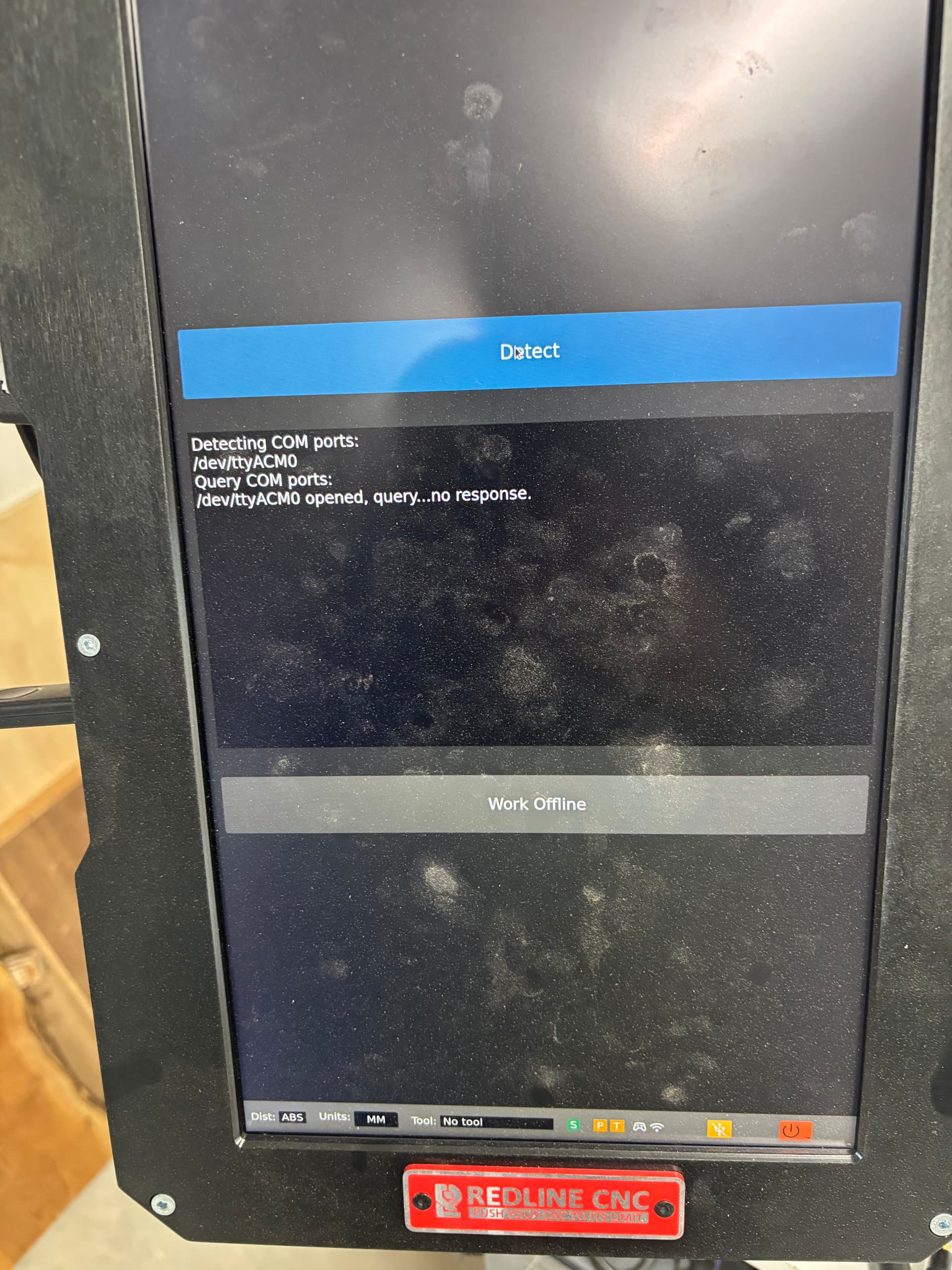

Stuck! When I click detect nothing happens.
USB disconnected from back of screen to RTX motion controller?
No machine was working just fine till I updated.
Try rebooting and triple check your cable.
Reboot fixed it. Thank you! Didnt want to reboot it and it cause me not to be able to boot it again

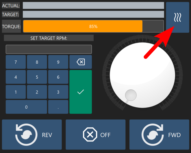

Great! Glad a reboot fixed it! Have fun with your ā€˜bacon’ button :slight_smile:
please explain the ā€œbaconā€ button.
Click the download button, it explains it on the download page.
That is a awesome QoL upgrade. Bacon button is awesome

It would detect an update, I would select to proceed, it would download 21%, the Z stepper motor would click, then the system froze. I powercycled everything, VFD, Controller, this included removal of the power cables and letting it sit for 30 seconds.
After this step, when I went to update I had a completely different experience. It opened a window that I didn’t have before, with usb in the top window, and the file in the bottom. Basically a file system window. I selected the update and it downloaded. Went through some steps and said click close to apply. I did so, it rebooted and went through the upgrade.
It then said there was a COM error, which gave me the option to detect on top, or to cancel on the bottom. I selected detect, and everything came back online.

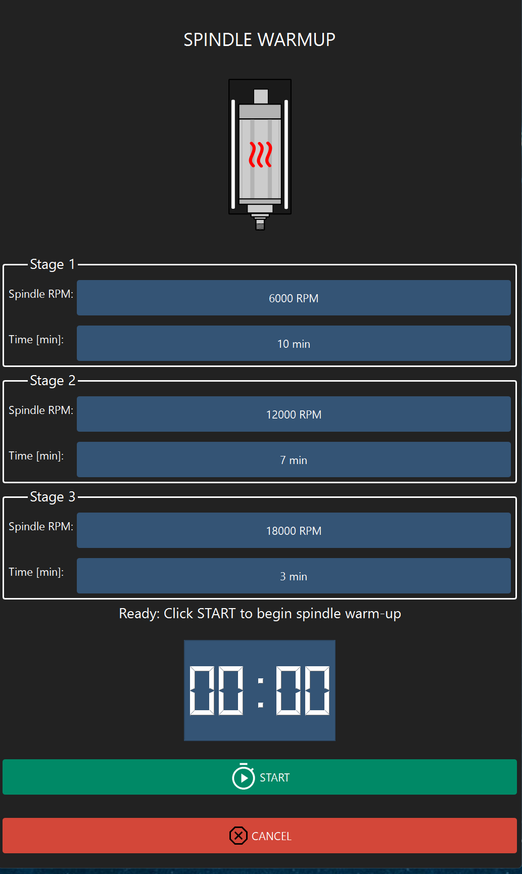

I did notice the parameters for the bacon button spindle warmup routine that the dwell parameters were different than the previously published one so I’m assuming these are the new recommended run times. Might be good to go back to the old post and update the parameters so the doc is consistent.
