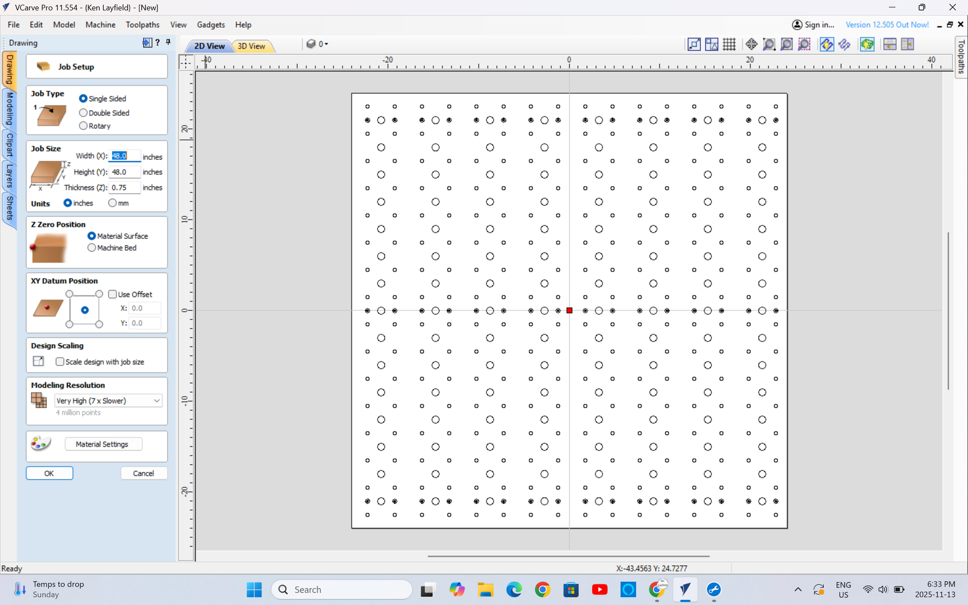

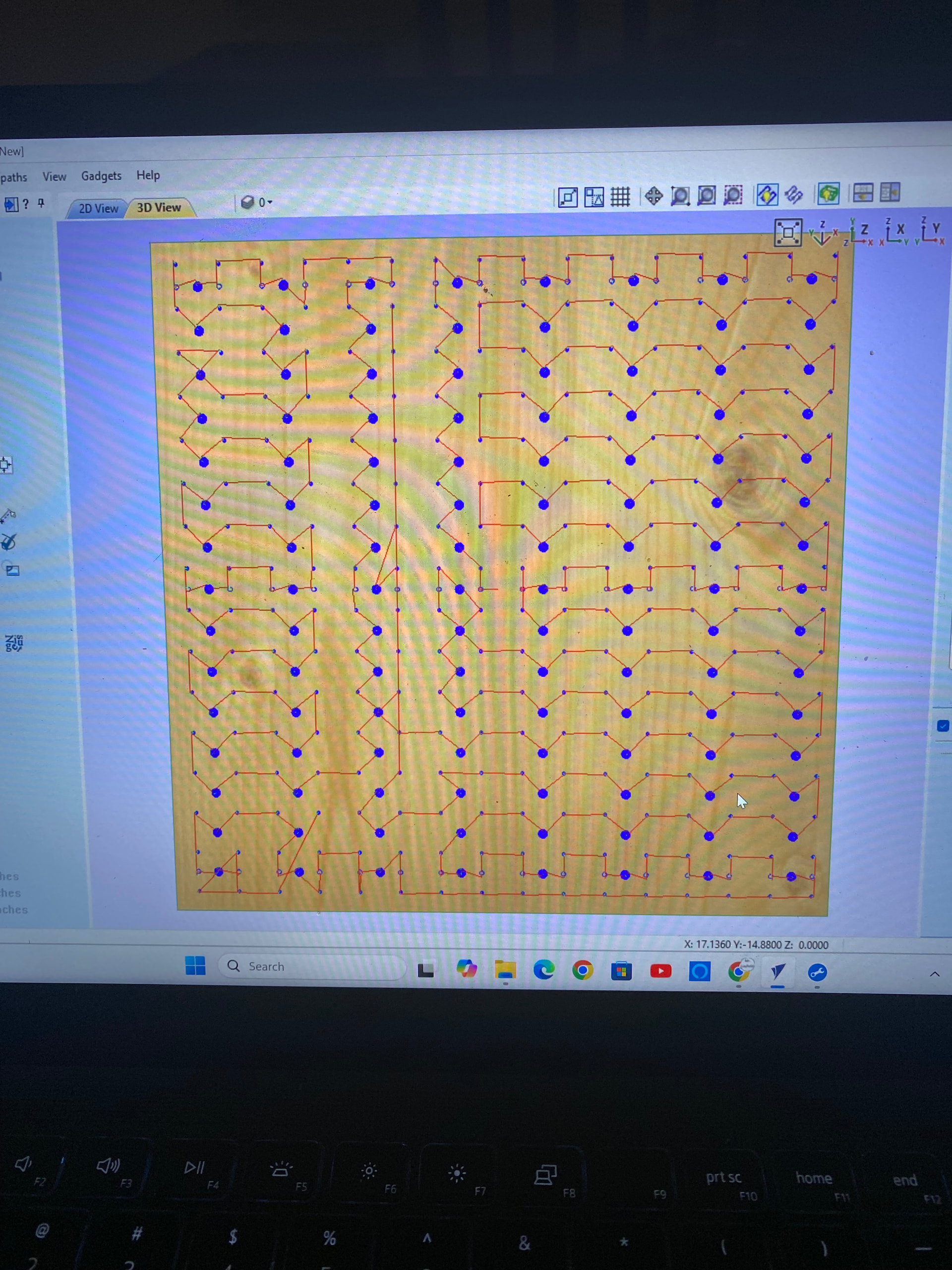

Hi everyone,I’m running into a positioning issue in Carveco Maker and could use some guidance.What happens:
  1. I import my 3D file (.stl/.obj/etc.) and open the relief.
  2. The model appears red in the 3D view, shifted 1 inch too far to the left.
  3. When I try to post the toolpath and start the job, I get:
    “Exceeded X travel by 1”
What I’ve tried:
  • I manually dragged the model to the right in Carveco Maker.
  • Recalculated toolpaths and re-exported G-code.
  • Result: Still red, same error on the machine.
Setup details:
  • Material block is set up correctly (size matches stock).
  • Machine bed limits in Carveco match my CNC (X travel confirmed).
  • Job origin is set to center (tried lower-left too – no change).
Question:
How do I permanently shift the model 1 inch to the right so it fits within the machinable area, turns green, and allows the job to start without the X travel error?I suspect I’m not updating the actual job origin or toolpath bounds when I move it. Dragging clearly isn’t enough — what’s the correct workflow

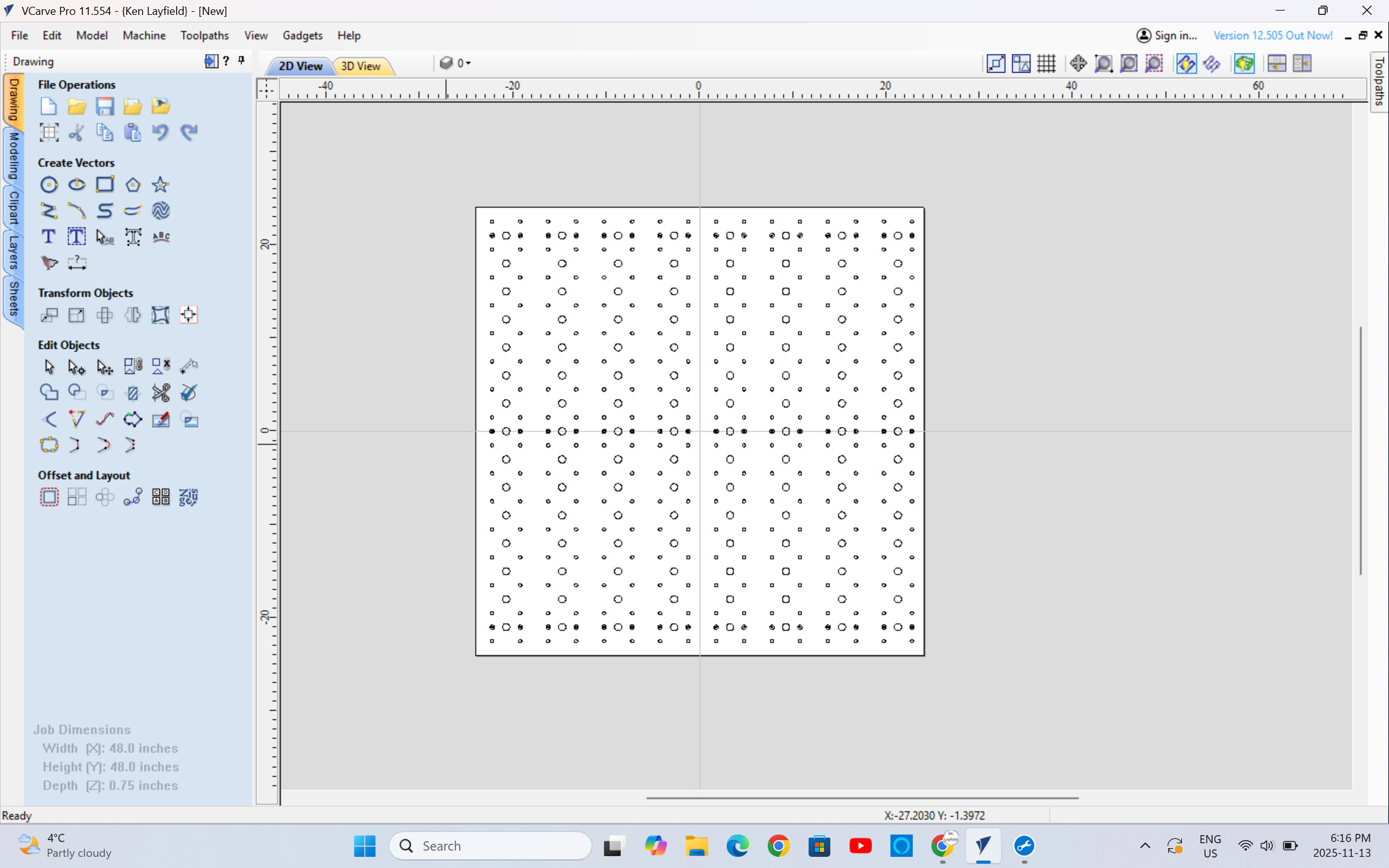

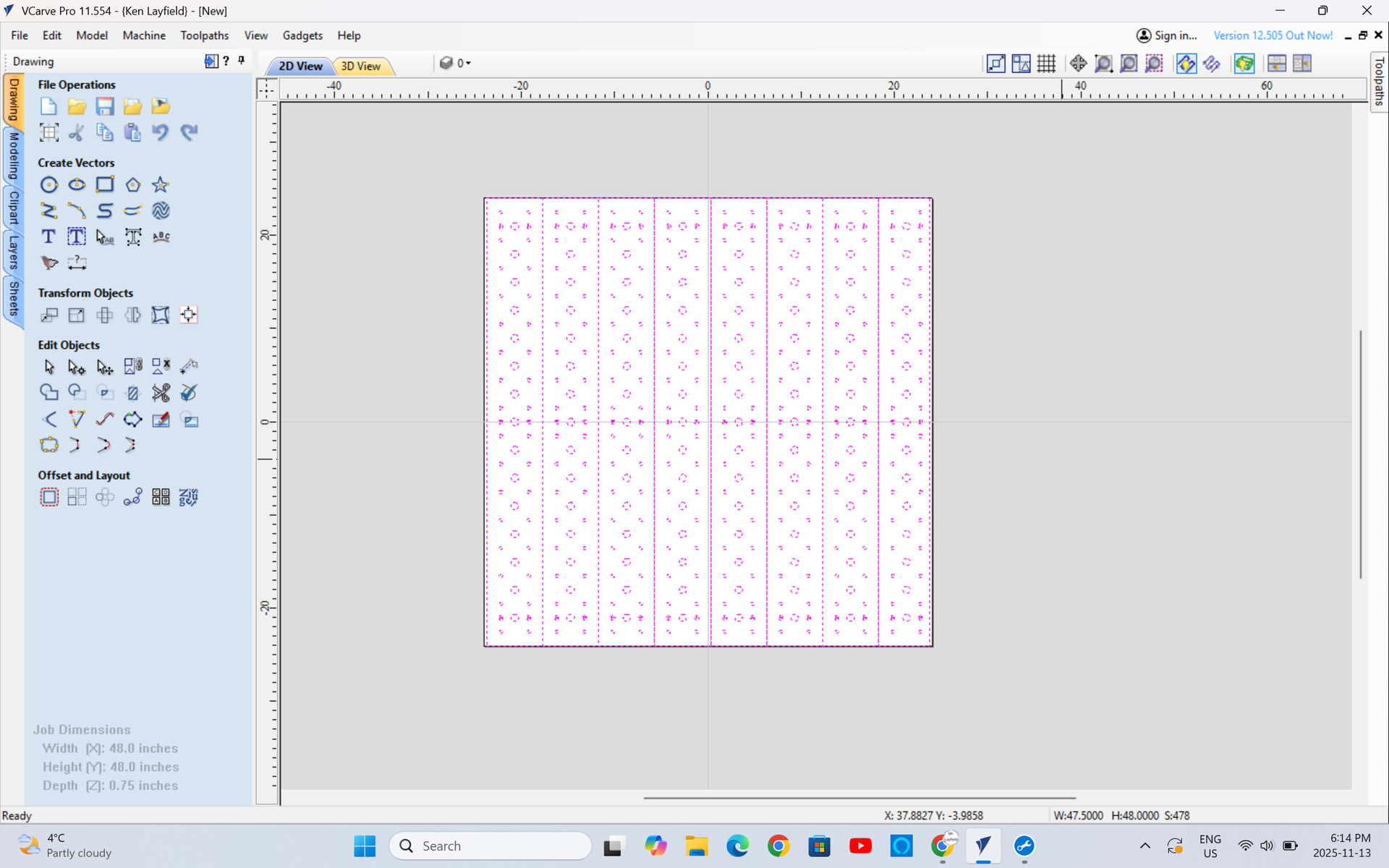

Try this-
Bring the dxf into a 48x 48 work area
Ungroup the vectors and delete the outer lines
Then select the vectors and toolpath, if it works then the outer lines were outside the machines limits
I did that lastnight, I was thinking the same but no luck :confused: but thanks for the advice Ken always thankful for great ideas.

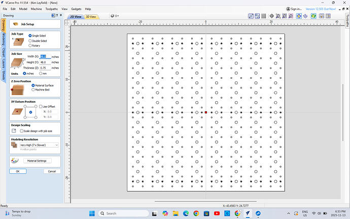

That’s too bad

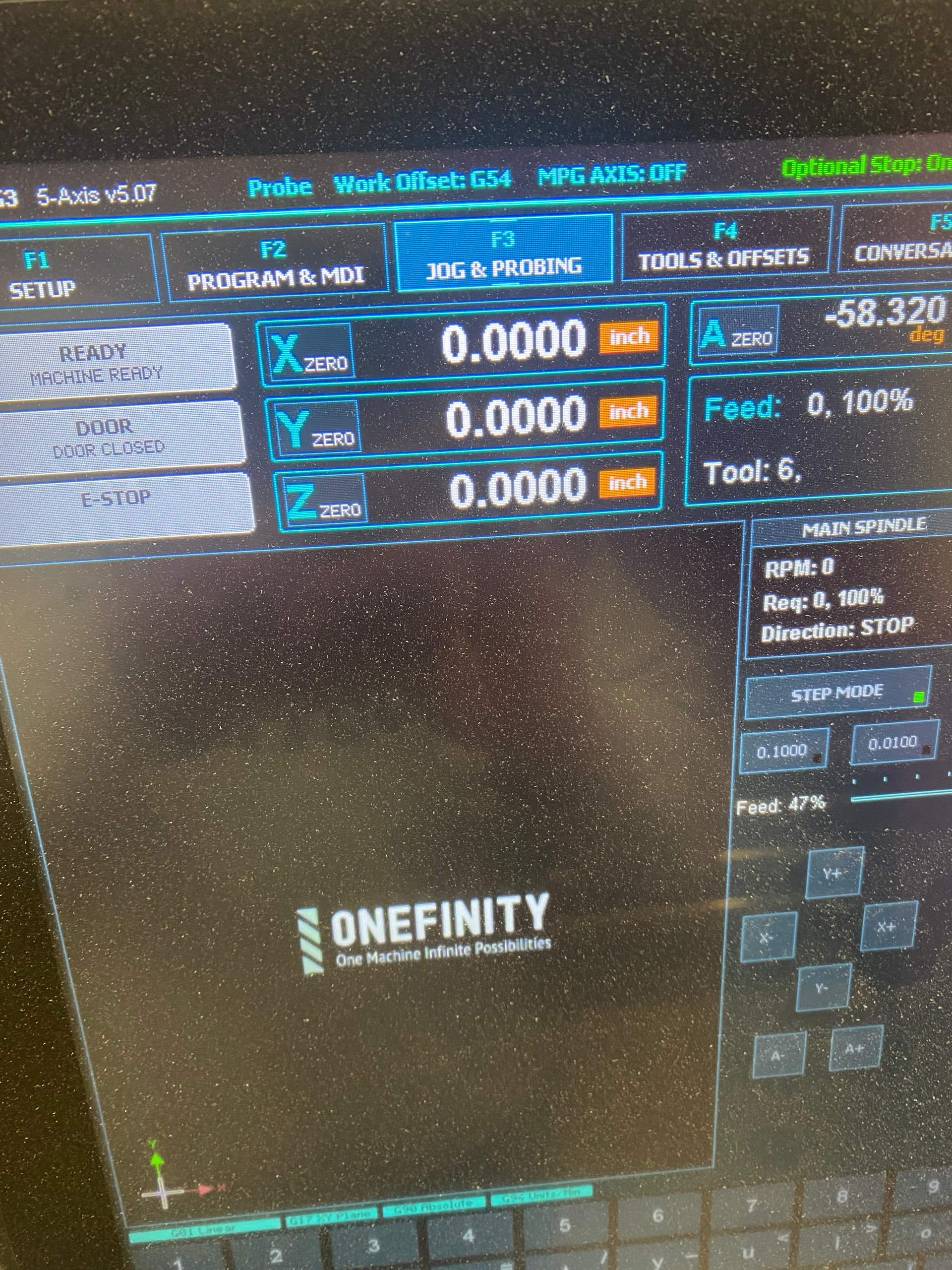

The last thing I’d check for is the XY Datum (see left of screen)
I know you said you are in centre but is there any offset checked?
Is the tool being used for any of the edge objects wide enough that it will result in a cut outside the machine boundaries? For instance, when surfacing a board you can’t run a big cutter on the edges of the board because the diameter of the cutter head means it will cut outside the machine’s travel limits even though there is physical room for the cutter head to fit without whacking the rails. Something similar might be happening with those holes along the edges.
Also, after homing the machine and setting x & y zero, run the router all the way to the outside edge of the machine and check to see if that matches the file’s material size (or is larger) and the coordinates match the machine’s defined size in the config (& is as big as or larger than the project’s size).
No it’s a 1/4 end mill so no it will never cross the barriers. Ive deleted the planks outline so it would just be the holes inside. Thanks Jim .
@OnefinityCNC still hoping for the answer but haven’t seen anything from you yet. :face_with_monocle:

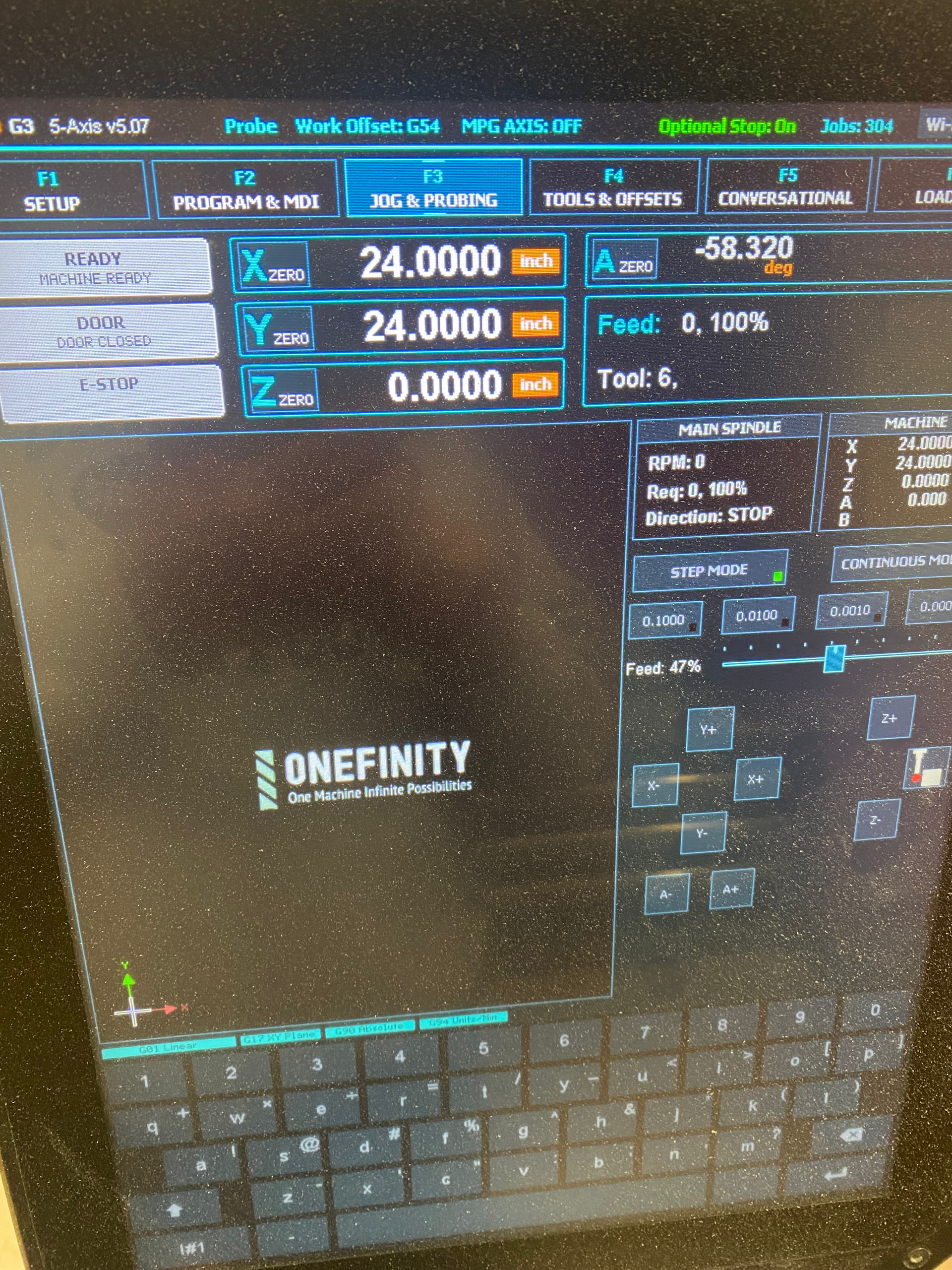

So I loaded the file minus the outside lines from your dxf for an air cut
I homed my machine then moved it to the centre
Then set work zero
Then ran the file and it works
So I think it’s a machine co-ordination problem
Ken i tried it from the middle and yes it will run. Before I do anything I want @OnefinityCNC to tell me what i have to do to fix it. Do they still help people on this forum?
