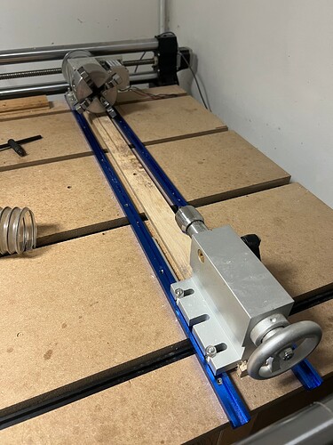

I bought this one: https://www.amazon.com/Engraving-Rotational-Tailstock-dividing-K11-80mm/dp/B07N2QQ6S5/ref=sr_1_2?crid=2HWDXIQ6R260L&keywords=rotary%2Baxis%2B4%2Bjaw%2B80mm&qid=1701542721&s=industrial&sprefix=rotary%2Baxis%2B4%2Bjaw%2B80mm%2Cindustrial%2C135&sr=1-2&ufe=app_do%3Aamzn1.fos.17d9e15d-4e43-4581-b373-0e5c1a776d5d&th=1. I later put a 4 jaw chuck on it, and swapped the motor for the little 1.2Nm Masso motor.

It was a pain in the ass to get the 3 jaw chuck off. There’s a few bolts and then it is just pressed on, but mine was very hard to get off.

Or you can buy the z motor with a brake and reuse the old z motor on your rotary.
That is, if you are using the same rotary. I tried the larger motors and they interfere with the jaws and potentially the stock because they are too long.
I’m not very concerned about the power supply though, even with the larger motor. I think you’d be fine with the stock one and worst case you’d blow a fuse. I suspect you could use a 4A fuse and be totally fine also. If you were really worried about it you could upgrade the power supply to a 450 and be super safe. But that’s not even a concern unless you want to spend more money or a more powerful motor than you need and can mount it on your rotary without interference.
The 1.2 fits perfectly with the 80mm chuck. If the 100mm fits it would be SUPER tight. I have t tried that.

you could re-use any open-loop bipolar stepper, but for connection to the Masso G3, you would need to buy an external stepper driver like this one, or this one for closed-loop functionality. Masso G3 supports all kinds of steppers and stepper drivers.

That first one is the 100mm version of my 80mm. I hadn’t seen the second one. The motor mounting that way is great.
In the end, I suspect. you’d be fine with an 80mm version anyway, which would easily clear. They both use the same 65mm tail stock, so you’re limited to small diameter stock anyway, unless you raise your system up.

I used about 1’ of cable that is hard wired into the motor, and an 8 pin molex so that I could easily disconnect and remove the rotary assembly as one piece. My cable is permanently run through the inside of my table so I can’t easily just disconnect it from the back of the Masso.
I used heat shrink the ends to keep the connector’s boots squeezed tightly together.
You’ll also need a 2.2k Ohm resister and a 10k Ohm resister. I wired those both inside clear heat shrink so I could easily see what they were down the line.
It’s also cleaner to use ferrules like ( Amazon.com) to terminate the ends of your wire.
If you have the molex connectors, pins, crimpers and boots I think you’re set.

How much adjustment room is available on your motor mount? According to the pics on Amazon, your rotary has a 350mm belt. If you had a longer belt (355 or 360mm), do you have adjustment room to slide the motor away from the chuck, rather than filing down mounting bolts?
Not sure if you’re using the same rotary as Adam, but the motor mounted in his picture would be able to slide and still tension a larger belt.

Alarm needs the 10k Ohm resistor, as shown here: MASSO Closed Loop Stepper Motors
The Enable needs the 2.2k Ohm resistor. Similar to the stock Elite configuration, I put mine on the motor end, under the cover.
1F didn’t follow the Masso recommendation for the Elite’s Enable/E-Stop wiring, and I followed their example when configuring my rotary, so every motor is similarly configured.
Here’s a photo of how I connected the Enable wire inside the Masso.
I just added the red wire to the a ferrule with the dark green line that connect into the Masso’s E-Stop. The other side of that white terminal has a bundle of dark green wires that go to the other motors’ Enable pin.
