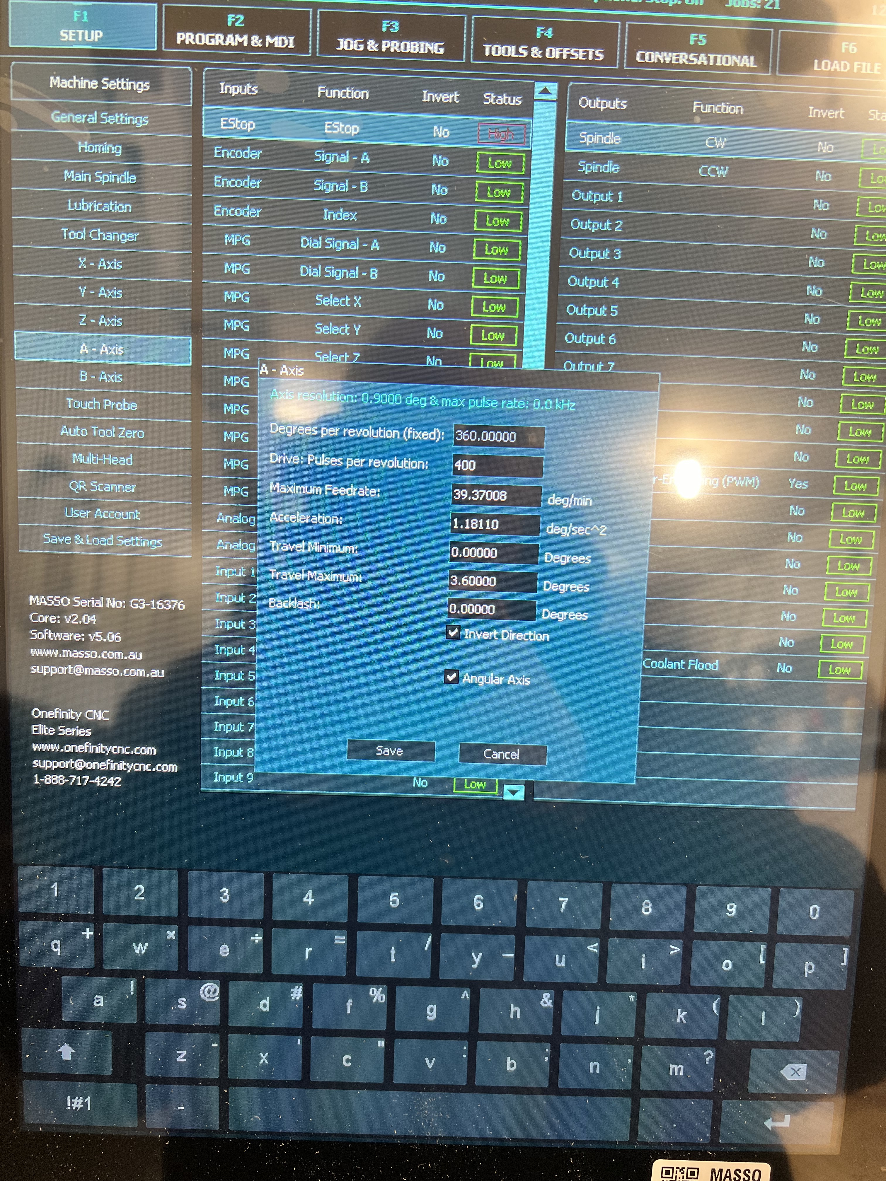

Just got mine all wired up 10k Ohm resister on the alarm and 2.2k Ohm resister on the enable. Is there anything else that needs to be done to enable the a-axis? I have gone in and activated the input on the setup screen, still nothing.
Motor powers up, but get no rotation.
Have you configured the new ‘A’ axis motor in the F1 window?

Also, are you using it like a lathe or more like an indexer? That will influence the settings and they would/may differ from the screenshot example.
That got it moving!
I am using it as an indexer (I’m pretty sure).
Would like to see what others are using as values (Elite), (6:1) ratio

I think you need to allow much more travel in you min/max travel. I think mine is -1000000 and 1000000
Yes it does get power (green light is on), but did not spin. I updated the Travel maximum to 60,000 and that got it going, will try upping it to -1000000 and 1000000.
Do you mind sharing your setting when you get a chance?
I have 4800 pulses per revoluion
maximum feedrate of 42000
acceleration of 180
min travel of -1000000
max travel of 1000000
backlash 0
You’ll want to confirm that you have your pulses per revolution correct for your setup with your motors and however you have the dip switches set.
What are your switches set to to get the 4800 pulses per revolution? Mine are all on, so it is set to 400 per their data and how onefinity set them from the factory. When I use the 400 in the A Motor set up it doesn’t move. When I change it to 4800, like you, it works, but not correctly (is stretched). Is that value a calculation based on a calculation of the pulses per revolution (400) and something else (gear ratio, 6:1)? I am guessing it is a calculation since 4800 isn’t a value in their table for various switch settings.

I think my motor is set to 800 ppr. I’d have to verify to be sure, but I think all of mine are set at 800 since I installed the pendant.
I think I recall the A motor not turning with the pendant on 1X unless I turned it quickly. I’m not sure how that would translate on the touch pad.
Thanks I have pendant too and that is the issue with that as well, I will update to 800 too.
Back to the 4800 how did you get that figure for pulses per revolution on the A motor?
I believe all motors are are supposed to be set to the same ppr, although, I’m not sure why Z and A would need to be the same. Did you already have your other motors at 800?
I actually had it at 9600 at first. I thought that was correct, but I noticed that with that setting, the machine was making two revolutions when it should only make one, so I cut it in half. I must not have initially accounted for 800 ppr on the motor.
I didn’t touch it when I removed it from the z axis (replaced with the brake motor), so it is still 400 like all the others. I will try 800 on all motors and update the F1 settings on all except A, leaving that at 4800.
Looks like it’s all good now, thanks for your help!
