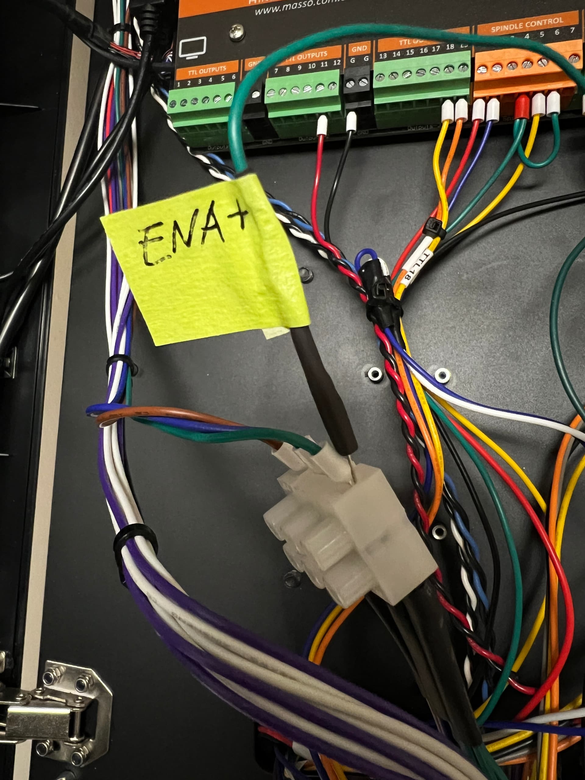

Hi Adam, or someone else knowledgeable,
could you please check if my wiring looks
correct?
The four A axis cables S+, S-, D+ and D- are certainly correct.
I am not sure which input port to use for the ALM+, so right now it is in input port 24 although that is most likely not correct. The 10 Ohm resistor visible between the input 24 and the power.
I believe the ENA+ to be correct as well. The 2 Ohm resistor is under the black shrink tubing partially covered but the green tape.
Also the power cable (the connectors are on back order, so this is temporary), I do not want to mix up power and ground:
Is that a 10 Ohm resister? It should be a 10,000 Ohm resister. It’s huge compared to what I have installed. Also, the resister on the enable wire should be 2,200 Ohm, not 2 Ohm.
I can’t see how your enable wire is connected from this picture.
EDIT: I think I can barely see the resister connecting into the terminal along with the dark green wire.
Your wiring seems correct except that the resisters may be the wrong ones.
You will specify the A axis alarm input in your setup. It doesn’t matter what one you use as long as it’s not used for something else.
Hi Adam,
Thanks for pointing the resister mistake out, I just ordered the 10K Ohm resister. The other resister is actually a 2.2K Ohm, it is under the black shrink tubing, so that one should be fine. I just stuck it together with the green cable.
I still believe the Enable to be correct, I followed your wiring example from post 86:
Ok, got it, I will configure the A alarm in the settings. I should be running in two days, once the correct resister arrives.
Many thanks for all your help, very much appreciated!

I assume you booted up with everything connected. Did you notice what lights were on on the motor at that time, before doing anything? What did the lights look like when you pressed E Stop? Then, when you released it?
From what I could see in your pictures, it looked right except the 10/10k ohm resister issue. We couldn’t see the motor wiring, or the 2.2k ohm resister.
When I did mine, I took baby steps and checked everythign with a multimeter as I went along.

One other question I have about your wiring is if your polarity is correct to the motor? You should see +36V at the motor. I’m not sure if you have the wires reversed or not. Looking at this picture, I suspect you may have this end of the reversed, and if you put the red wire to the 36V terminal, you probably have it reversed. Please check it with your cable with a multimeter before connecting it to the motor.

Thanks Adam
I am indeed a woodworker and have no clue about electrical wiring. So my mistake was that the wires of my multimeter were switched, which led me to wire the motor wrong exactly as you assumed.
Thanks Toronto, I added a shrink tube to the resistor. I will also get all proper connection plugs and rewire everything.
The A axis is indeed turning.
