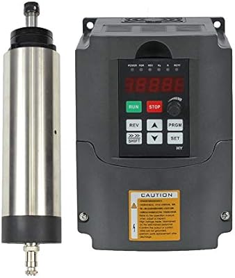

it can only mount a 65 mm spindle or router. that limits to the makita or carbide create router, i think one of the harbor freight, and the 65mm spindle in 1500 watt 220 volt, and 800 watt 110 volt spindles. i’ve got the 1500 watt 220 volt aircooled on mine and it works great. I also own the 110 800 watt water cooled and it is good on my shapeoko, but I like the more power on the onefinity due to teh speed, but I’m not sure you would ever need the 2200 watt. it is a lot heaver and larger than the 65 mm spindles. (i’ve got one on a 4848 cnc4newbie and it is a much larger heaver machine.
@laynemims - you happen to have a link to your 1500 watt model? Though 220 might be deal breaker for me in my office…
amazon for 220. i really like this spindle.
here is 1.5 kw 65mm water cooled for a little more money, but could use existing 110.
Guys, had a bummer Christmas moment today when I found the Mysweety water cooled spindle I got for myself was the wrong size, 80mm, instead of 65mm. And the ones you mentioned are unavailable on Amazon. Here’s my two Qs:
  1. Do you know of another available option for a water-cooled spindle for the Onefinity?
  2. Apart from the spindle needing to be 65mm are there any other restraints or requirements I need to consider?
