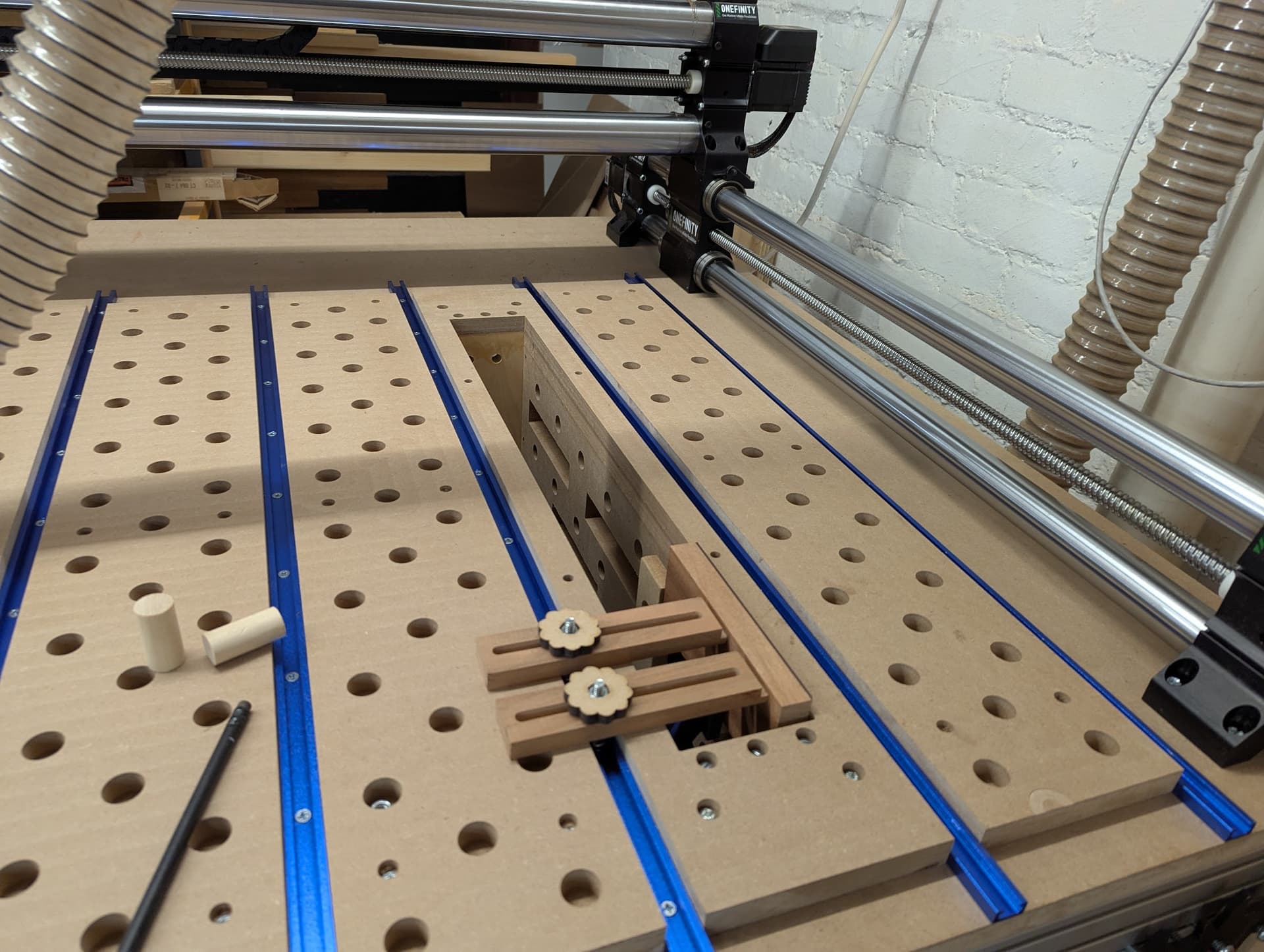

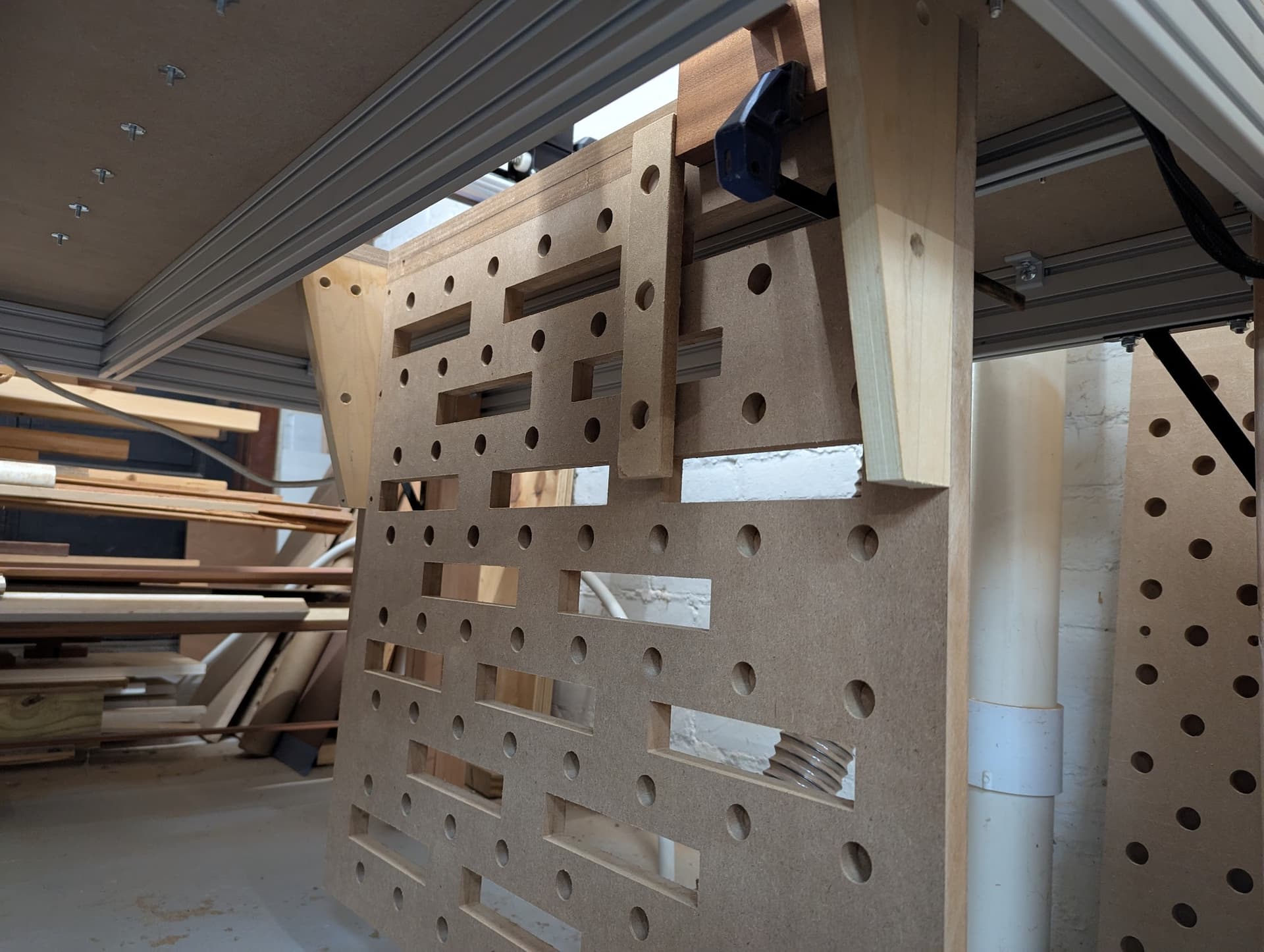

I have been trying to figure out how to do vertical clamping on my Elite Foreman. Any tips you can share with me?
Here’s my version - replacing one of the panels in my spoilboard and cutting a slot through the table top. The suspended vertical table has slots for clamping and dog holes for alignment.
This is awesome. Kind of what I have been picturing in my mind on how to do it.
