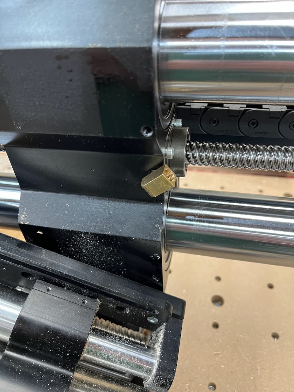

I have an Elite Foreman and can’t believe the difficulty in adding oil to the X rail that requires removing the Z rail to access the port. This just seems like a design flaw that could easily be fixed. To remedy the issue, I purchased some elbows and cap screws. The elbows screw into the oil port and are small enough to not interfere with the Z rail. The Cap screws cover the port and are easily removed to add oil. This allows lubricating the machine without having to remove the Z rail and was very inexpensive.

To be honest, I didn’t do an exhaustive search since I was just trying to see if this would work - and it does. The cap screws were a little long so I cut them to length and chased the threads but that isn’t necessary, It was my personal preference. The elbow is an M6x1 male to M8x1 female. I wanted M6x1 fittings on both sides but was unable to find that so settled on this. I’m sure you can find these on Amazon but I got these on AliExpress because I could buy smaller quantities.
Elbow: https://www.aliexpress.us/item/3256802804208836.html?
Cap Screw: https://www.aliexpress.us/item/3256803973360295.html?
M8x1 Die: https://www.aliexpress.us/item/3256806173154283.html?
I also printed TPU O-rings of various heights so that the elbow would be snug in the direction that I wanted it to face. Most any O-ring should work or may not be needed at all.
Good Luck!

And then an M8 cap screw I assume? Do we know what length?
It requires M8 x 1 cap screws… those are not the customary thread pitch for M8 cap screws. It’s a pipe-thread pitch.
So I ordered some of these from Amazon. I’m pretty sure they’ll work fine.
uxcell Stainless Steel Inner Hex Head M8x1 Pipe Fitting Plug with Seal Ring for Terminate Pipe Ends 2Pcs

I received my parts from Amazon an did the installation today.
The plug is a little too long which causes it to bottom out in the hole before the O ring touches. I really don’t think it’s going to be an issue. I’ll keep an eye on it and if it weeps oil, I’ll pack a few plastic washers between the O ring and the head of the screw.
Here’s a pic with the plug as deep as possible:
I added some teflon tape to the threads:
And installed it at a 45 degree angle:
Pic of job complete:

If you have a 3d printer, you can print a new gasket out of TPU much thicker.
