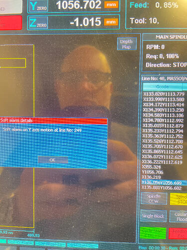

Hi, I have been hitting a soft Y error right within the working area.
I can joggle the bit all over the area with no error.
Even a dry run will stop.
I have tried swapping serví motors but error is consistent.
Forman elite with Masso.
Any idea will be great.
Looks like your part is running on the exrteme edge of the Y axis and is not square, so its running passed the limit. Move the job origin to the middle of the table and see if that helps
Ken5, thank you for taking the time to reply. Here is my dilemma, it stops right where the ‘+’ is, so technically it did the back of the “T” without any issues, but it stops right in the internal part of the T ( the one closest to the center of the wok piece, the frame is cut already too.
I try re-homing it, re-squaring it, and moving the motor around, but it’s doing the same.
I am lost on what to do next.

I’ve noticed Masso reads ahead and throws a fault if the spindle will go out of bounds in the future. It doesn’t mean the current position is out of bounds. It means the spindle is expected to go out of bounds later.
Mike is correct. Masso reads ahead so it’s not stopping on the problem line, it’s stopping before the problem line.

It was a tile that the overlap on the top part put it outside the work area

I ended up just removing lines from goose and the error was like 5-10 lines ahead of where the machine was cutting.
