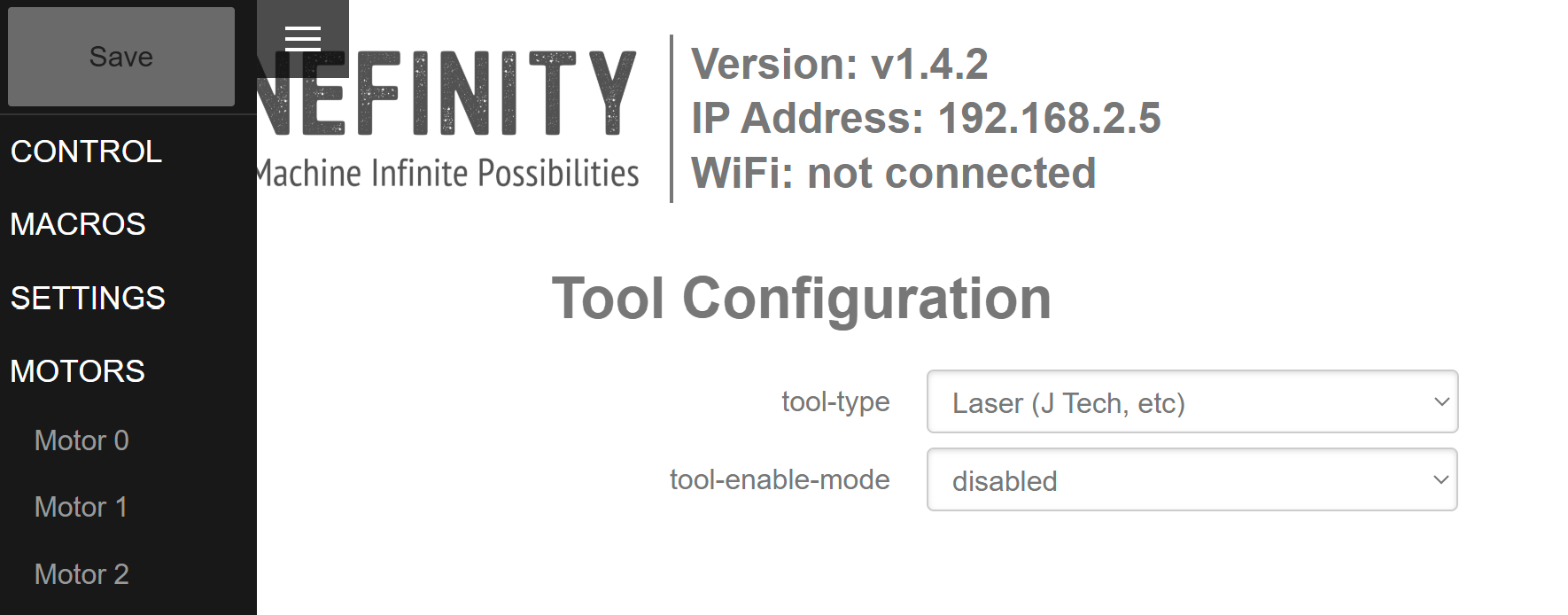

I noticed the speed value was fluctuating while running a laser program today. Is that expected? other than the initial S100 and the final S0 in my gcode (attached) there are no S commands to correlate
Ellie_Laser_10percent.ngc (451.4 KB)
Yes, it changes speed (laser power) in relativity to actual speed of machine travel. This is expected and normal for the laser to work correctly.
That makes sense. Thanks
