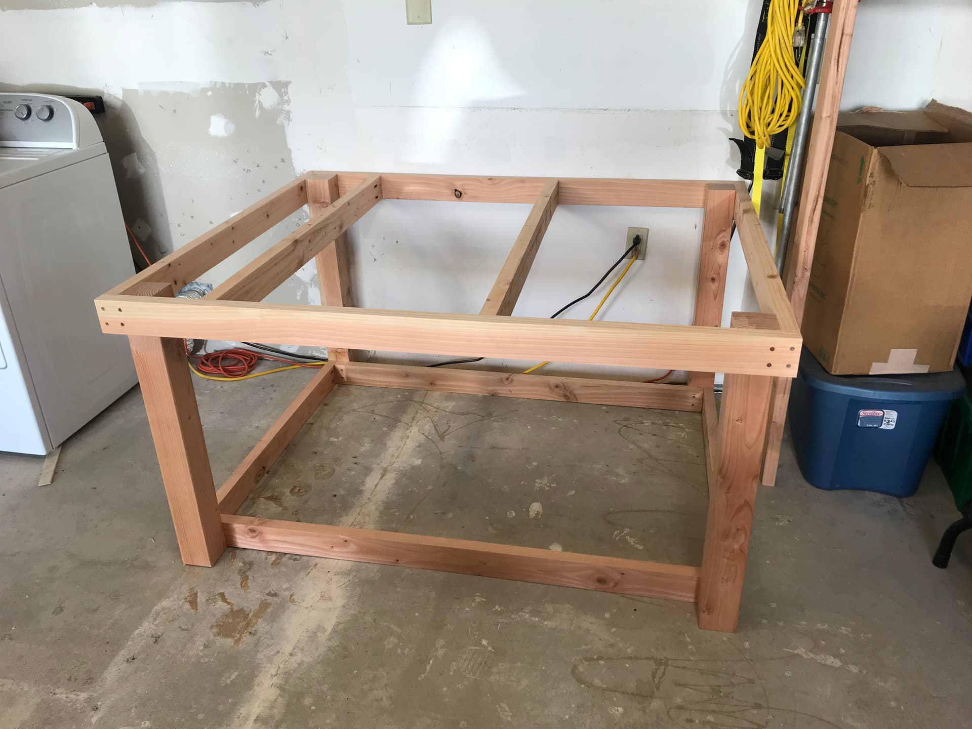

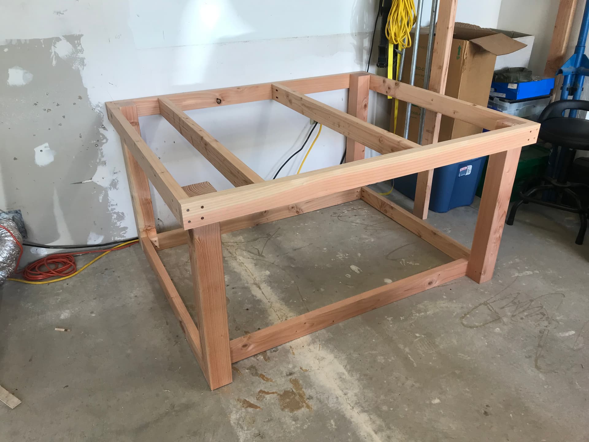

Got the frame of my table complete, simple 2x4 and 4x4 construction. 60" W x 49" D. I’m hopefully receiving my machine in the next week or so (#16718). I’m planning on going with 3/4" MDF for the top, then another sheet inside my enclosure, and then there will be the spoilboard. You guys think the should be sufficient stability wise?

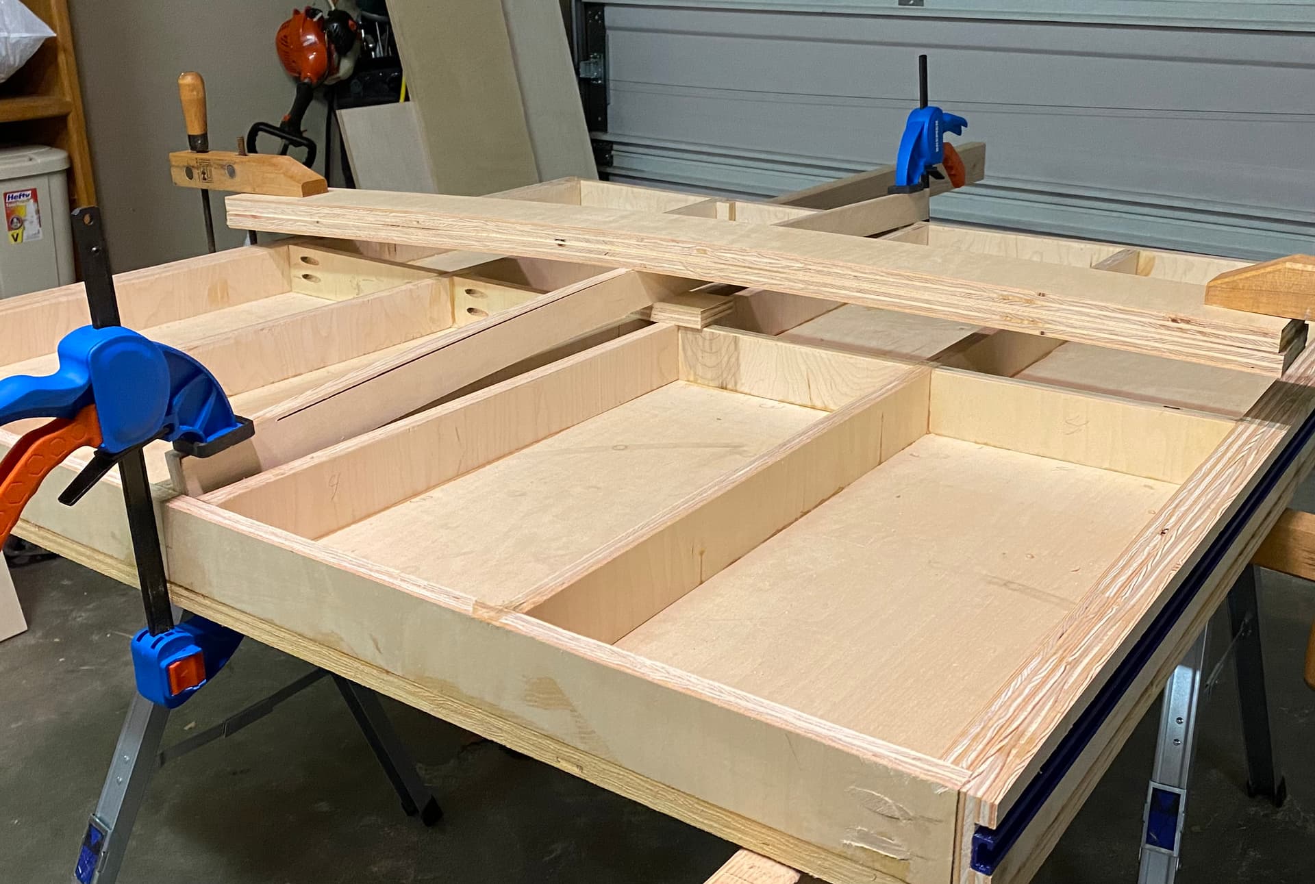

For my modified Fisher portable, I assembled a torsion box with the internal structural matrix glued and screwed (Titebond III & 1 1/4” pocket screws) to a 3/4”x48”x47” sheet of maple plywood. Clamping of the matrix internal cross members was accomplished by cantilevered plywood beams, center blocks and screw clamps. Each section in the pic was further subdivided by 3/4” ply cross members for a total of 24 structural cells in the torsion matrix.
Once the glue cured a day, the opposite table sheet was glued, similarly clamped (thank you Archimedes) and fixed with 1 1/14” brads. This surface is the alternate work surface opposite the OF surface.

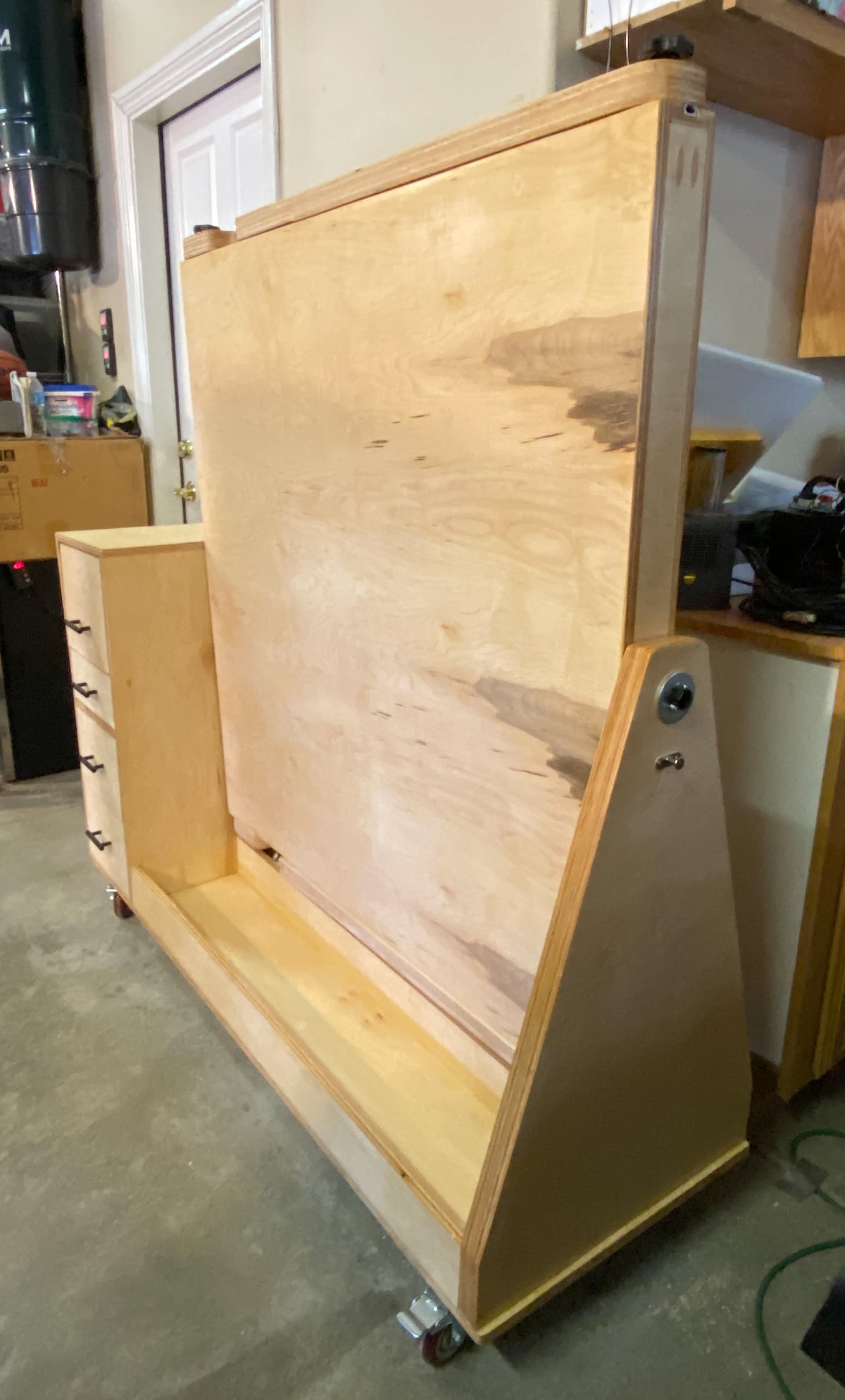

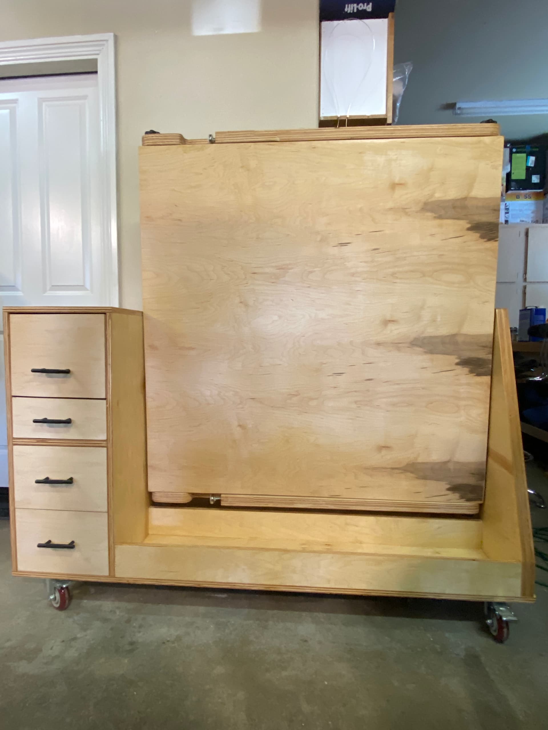

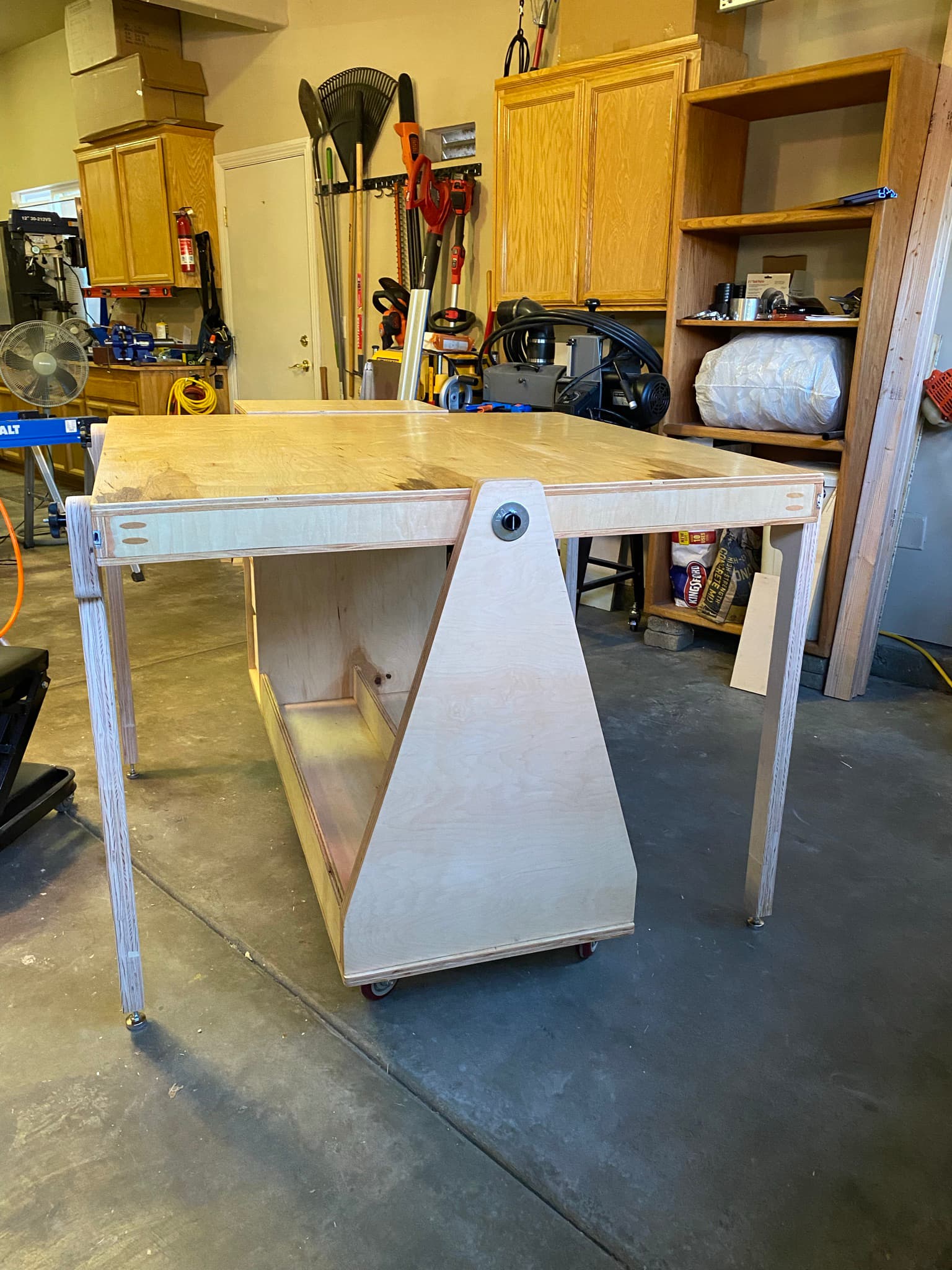

Has anyone done a Fisher Table with an enclosure over the 1F?
I like the flip style table for storing the 1F vertically and the added work surface but will need an enclosure for noise and dust. My new shop will be smaller and it would be really helpful to do this. I’m playing around with some drawings to make it work but the total weight concerns me.

Get some diagonals in there
