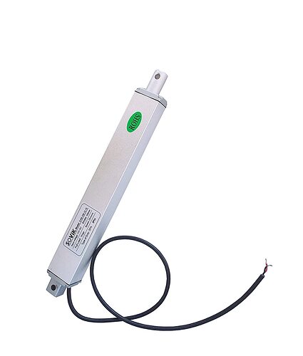

Great work! I have a few boost gates in my shop but i only motorized the one i have installed for my CNC. I bought the gates to save time - they’re the ones everyone knows, some metal some plastic, they work ok, but not great. The plastic ones seal better but they are hard to move, and the metal are leaky but seal better with suction.I do like yours though! Looks like taking the time paid off with better and cheaper gates. I had motorized the gate for the cnc using a geared motor i had laying around, fitted with a small pulley around which i wrapped a steel cable connected to both ends of the blast gate slide/valve. Works well but adding the travel limit switches and another one for the dust collector control, came to a little more messy assembly than i would like to see.
I really like your linear actuators. I looked at those before and they were pretty costly for my budget.
What model and store you got them from?
Thanks. I initially attempted to use some small linear actuators I picked up from AliExpress, but that didn’t work out as well as planned. Ultimately, I went with these:
They are a good tradeoff of speed and power for what was needed in this project, and the limit switches are already built in. Many of the actuators in this class were too slow at half this speed or less, and way stronger than needed.
You are correct, they were not particularly cheap — roughly 3-4x the cost of the AliExpress actuators I wanted to use initially. But when compared to the cost of an IVAC system (which was my alternative), I was still able to save a significant amount by DIY, particularly at the scale of my system.
I have only been using them for a couple weeks now, but everything is working great and it’s so satisfying. I wish I had done this ages ago.

These actuators look nice, but are indeed more costly than I could afford to invest for my whole home shop. However, I am tempted especially given the fact that they integrate limit switches, I think that they come really close to worth the expense even for my budget. There’s a lot to like about them, things I didn’t think of considering before I got to actually build a couple of motorized gates using discrete components. Just judging the labor these actuators are saving from not having to install limit switches and tweak their positions, wire them all with the motor (cut, strip, solder, route, secure all wires), had to make and attach a motor bracket to the blast gate and mechanically link its axle to the gate. All these operations indeed fairly simple and easy to do but there are many and they add up to a fair amount of time spent. The second aspect where these actuators shine is the fact that everything is enclosed for much better dust protection, leading to better reliability.
So yeah, I think I will get me at least couple for a good start to only build the blast gates I use the most, then we’ll see.
