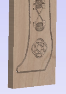

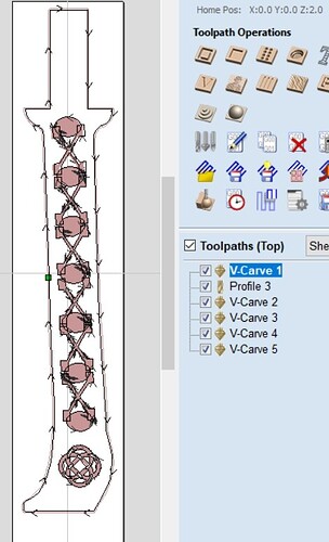

Ah, but the toolpaths are in the file you sent, they’re on the Top side of the drawing (your file came in as the bottom side). Here is a screenshot of them (3rd picture). Except for Profile 3, all have a depth of .075. Profile 3 is your outer cut of the handle.
Your file as you sent it only cuts on the Top side of the drawing. When I switched it to the Bottom side, there were no toolpaths to cut.

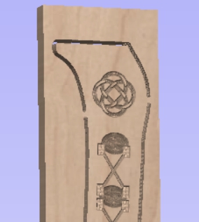

As drawn, it cuts fine on the one side. Your complaint was that it was cutting all the way through on the opposite side (in the 3D view). But I don’t understand how you were getting it to show cutting on the other side when you didn’t have any toolpaths on that side. When I copied the drawing to the other side (1 layer at a time), and created toolpaths, then both sides cut fine.

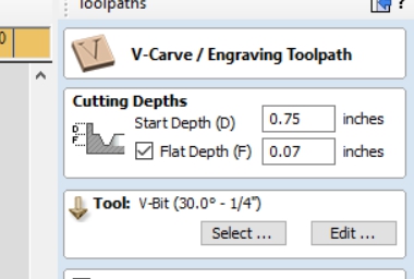

It’s cutting through because on the bottom side, you have two toolpaths (V-Carve 6 & 7) that both have a start depth of .75 (see picture) so you’re telling the program to lower the bit all the way through the wood, then start the cut. If you make the start depth 0.00, then it would cut fine. I hope this helps.
Note, these 2 toolpaths were not in the file that you sent me to look at.
