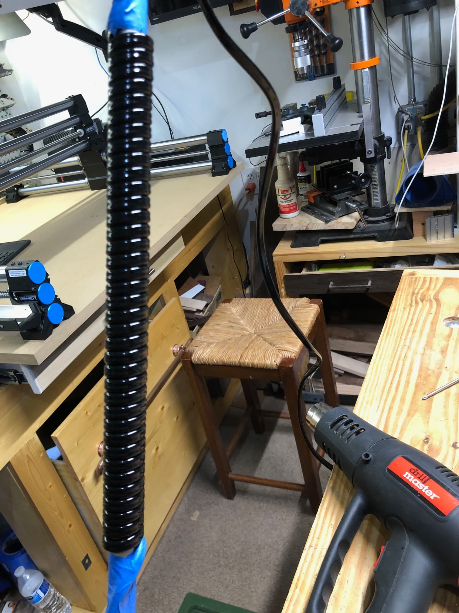

For anyone interested in DIY the coiled cord. It’s not that complicated and cost effective + custom length as you really need it. I bought this cord https://www.amazon.com/dp/B0CGHF2BSD?ref=ppx_yo2ov_dt_b_product_details&th=1
and coiled it up per those instructions: DIY perfectly coiled cable guide
and the end product is here:
Just heat the cord long enough, in my case at least 5min on high setting on the heating gun, 1 inch away from the cord, all around.
I knew this could be done, as I coiled optic cables for my underwater flashes before :slight_smile:
