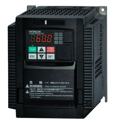

Is anyone else using a VFD that are not from pwncnc or Huanyang? And what are your thoughts on the pros and cons?
I am using a vfd (Mollom VFD 220V 2.2KW 3HP 9.6A… https://www.amazon.com/dp/B0BM5RRX9M?ref=ppx_pop_mob_ap_share) on another piece of equipment. Based on it not being a certified ul device (ie:affordable) I only leave power to it when I am using it and in the shop.

that’s a good price:
https://www.wolfautomation.com/vfd-3hp-200v-single-phase
Some other offers:
https://octopart.com/wj200-022sf-hitachi-27546340
See also
Note: Hitachi WJ200 is practically identical to Omron MX2 (PDF Manual). This means all settings for Omron MX2 you find in the forum also apply to Hitachi WJ200 and vice-versa. The only difference I could find is that the Hitachi offers 0–400 Hz while the Omron offers 0–580 Hz.
PS: The Hitachi WJ-C1(-022SFE) supersedes the WJ-200(-022SF). It is downward-compatible to WJ200.
Product Update: Hitachi WJ200 Series

The WC-J1, is this drive compatible with the Masso controller?
Hey hyspead,
yes of course. Masso does not support controlling VFDs by Modbus like the Buildbotics Controller does, but it controls them by the 10 V analog voltage for SPEED / digital input terminal for RUN/REV/STOP. This is supported by practically all VFDs. See Spindle VFD examples – Masso Documentation and Hitachi WJ200/Omron MX2 wiring to Masso GX12 6-pin connector.
