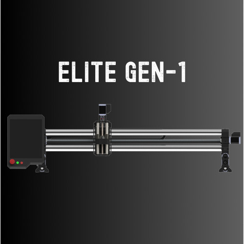

2025 Release
Gen 1 Elite — Redline
The Gen 1 Elite Redline Series comes standard with the closed-loop RTX-1 Realtime Motion Controller, paired with the Redline 15" HMI Screen.
Together, they are commonly known as the Redline Control System.
Redline 15" HMI
Realtime Closed Loop Controller  | RTX-2
2023 Release
Gen 1 Elite — Masso
The Gen 1 Elite Masso Series comes standard with the Masso G3 Touch Advanced Controller.
This controller was used on the original Elite Series before the release of the Redline Control System.
