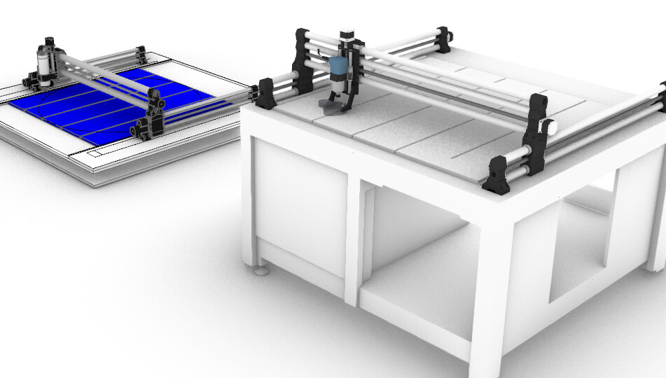

Who has CAD Models?
Before posting, I searched, and cannot find accurate STEP files of the machines and accessories?
I did mention I’m a draftsman, but gone are the days of paper dimensions. We model everything so we can CNC parts.
As I prepare my shop to receive an Elite, I would like to have my table built, and I have access to a CNC I can use to build it…
Who among us has 3D models of the whole or any single parts?
Thanks!
Thanks for the prompt reply. You know exactly what I want: accuracy. So you waited until you had the machine in hand to build a table.
I’ve got a lead time on a pick up truck, then the lead time on the Onefinity; I could be designing and building in the interim. ( I will anyway, and share the step files I make with you guys)
I just got good dimensions on the T-track, which I’ve never used before, so as I go along I’ll make step files of what I design, and beg for guidance. Thanks again.
The one I used seems to be no longer available. It was X35 anyway but the footprint is the same. I have the fusion file if you want it.
This one seems to be very detailed. Somebody took a lot of time on it, so there is a good chance they did it right. If i get a chance I will measure it against my X50 woodworker.

Here is the fusion 360 file if anyone wants to grab any parts. Fusion
Here is the step file of the same thing:
wallMount2.stp (11.1 MB)
Okay, I’ve only had time to pull the step file into Rhino3D, explode the blocks into parts, and check the dimensions of the rail: 1.378".
35mm x .093701 = 1.3779535 on my pocket calculator.
I call that a win.
Thank you very much.
I have a sketchup model of the Elite Foreman 48 x 48.
CNC Table 2.skp (1.4 MB)
Beautiful! Finely detailed. You even threw in some table ideas. Thank you.
