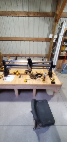

Having the ability to reach into the table is the reason why my machine table is 25 inches off the ground. I just need to get that video out so everyone can see it.
One issue I had is the y gantries are only sitting 1/8 of an inch off the table… My Opinion should have been a 1/2 inch or instruction to cut out the table beneath it. Wood sweals and mine did and it got stuck. So I had to build lifters out of Birch Plywood. All explained in this weeks video.
Hey Lawrence,
if it’s a mp4, you can upload here with the “upload” icon in the message compositor top tab row.
It is really big - I have a few things left to do and then it will be on my channel. Lars Workshop. Here is a picture
There will be a canopy over it. 1. protection, 2 sound, 3 I live in Ohio and need to heat the system over 40F if I am going to use this winter.
