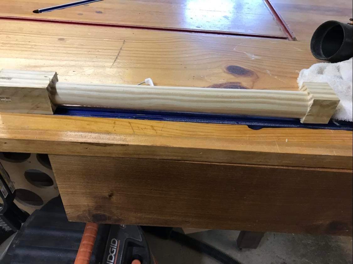

After setting everything up I did a 2”x8” ballister. The rounding toolpath was 24 minutes. The 3D finish was 1:20 minutes. However when I sent the toolpaths to the machine here is the time shown.
  1. Rounding toolpath 25 minutes. That is OK.
  2. 3D Finishing toolpath. 21 hours. WTF?

toolpath timing in vcarve is an estimate so broad, it covers every CNC in exisitance. You need to adjust the ‘scale factor’ to get it closer to what the controller says it will be.
The Post Processor was based on the 1F. What do you mean “scale factor”?
"The inaccuracies generally come from the acceleration / deceleration of the machine. We do take account of the rapid moves and you can enter the rapid rate for your machine on the form.
However if we tell a machine to move at 200 inches / min along a 200 inch straight line the machine will probably take pretty close to a minute.
If instead of a straight line we ask the machine to cut say a gear wheel with a total circumference of 200 inches, the machine is likely to take considerably longer. This is because the machine will have to slow down to go around the tight curves of gear tooth profiles and will probably never reach its programmed speed before having to slow down again for the next change in direction.
The scale factor in the programs let you approximate this slowdown for your machine, but it will vary depending on the type of work you are doing. Many people will use one scale factor for simple 2d work and another for 3d or VCarving. The best way to calculate it is just to take a note of estimated and actual machining times of a period of time.
For machines where the controler provides an estimated machining time, these should be more accurate as the controller can determine where the machine is accelerating / decellerating and take account of this."
