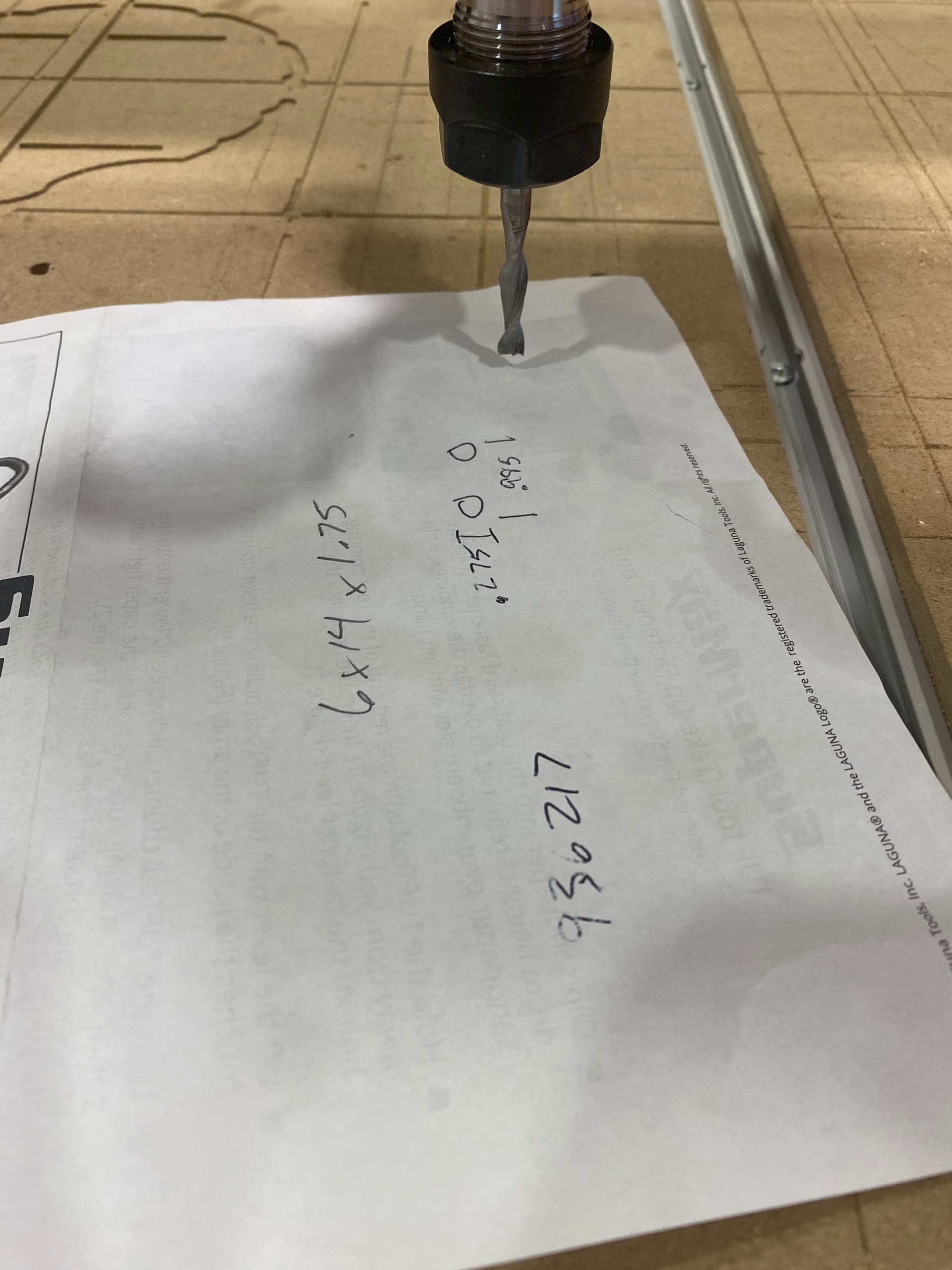

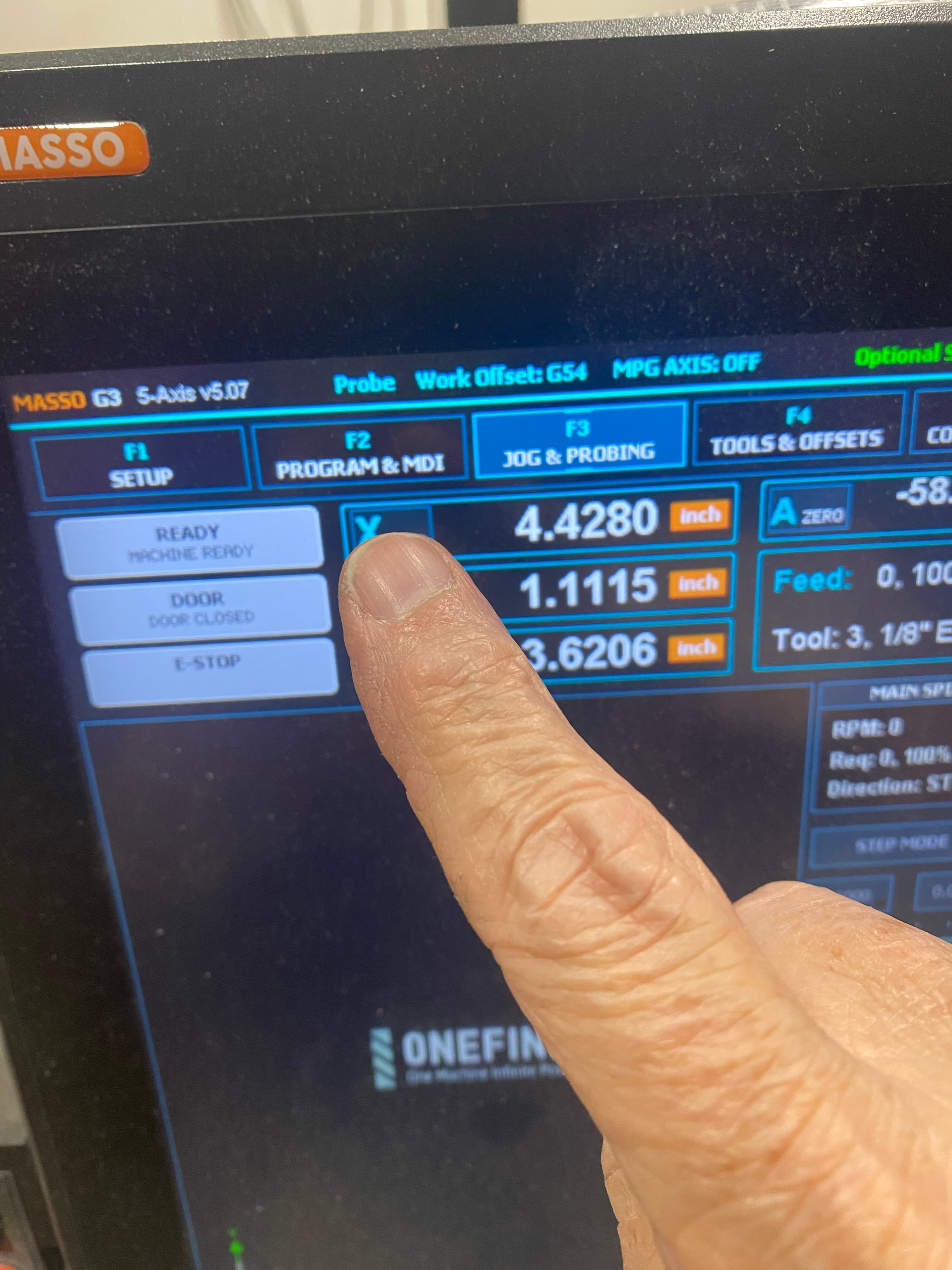

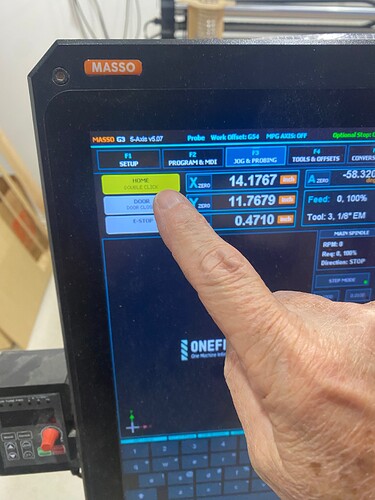

Home your machine

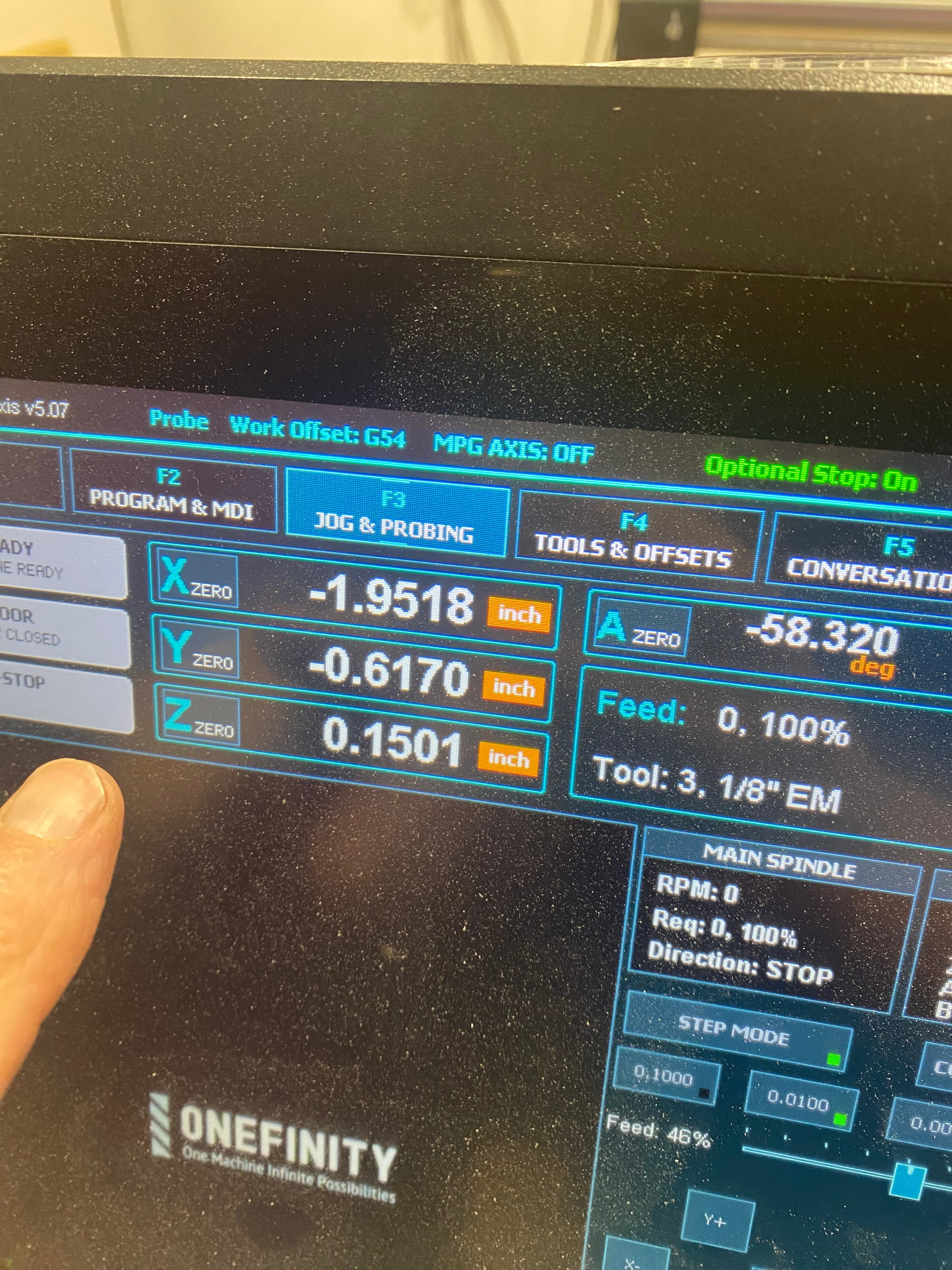

Move the router using the x and y button set to continuous
Zero out the x and y by tapping on the button
Lower Z axis down to a thickness of a piece of paper using step mode

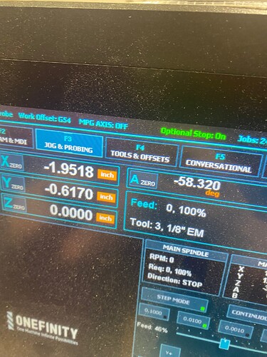

Press Z button to zero out
Process complete
