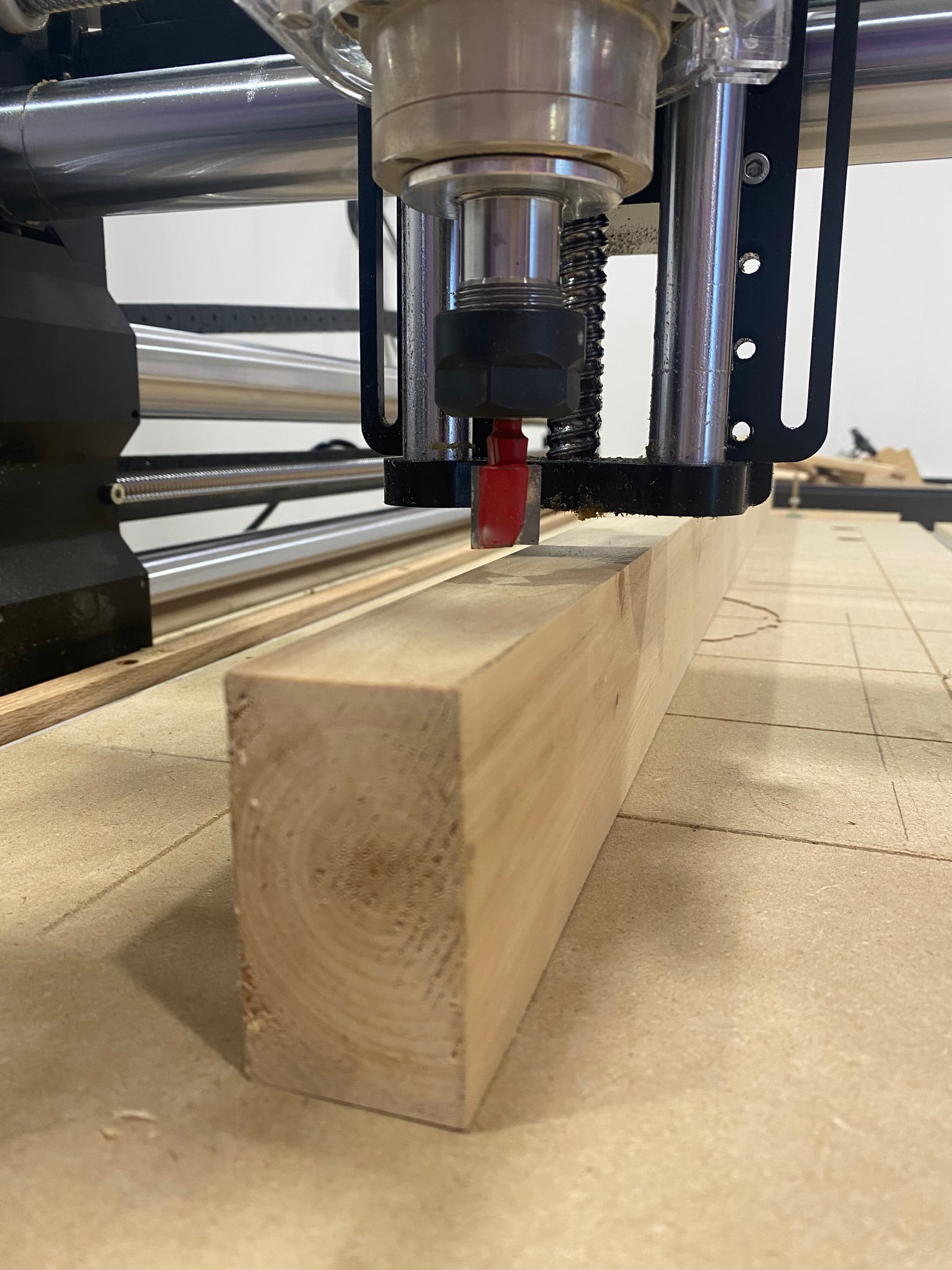

I homed the machine
Manually measured table surface Z distance with a piece of paper set it as zero
Used the probe to measure a the thickness of a piece of wood
Then I measured the distance the bit was from the table vs the control panel not even close
See pictures
Yeah I never figured out that tool configuration thing. They never matched up between the Masso and Vcarve toolbase.
I don’t think the thickness of the plate is the problem. The physical measurement from the table to the bottom of the bit is much larger than registered on the screen. Approx. .6" Remember I manually set Z zero.

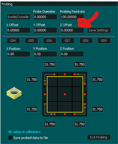

Id suggest starting a job and when you go into the probing menu check your Z offset and make sure it matches what you measure the thickness of your block to be. If its wrong update it then click save settings.
These are current settings
Should they all be 0
I wonder if they might be the settings from the rotary I did follow the manual to revert to 3 axis however
They should not be 0. That Is your problem right now you have the z set to 1.37 inches thick. Take some calipers and measure the thickness of your probe plate in inches and change your Z offset number. There is no way your probe is over an inch thick
This picture is the rotary prob settings. When you go back to 3 access you need to change back to the three axis probe settings as well. Unfortunately, MASSO doesn’t have an easy way to switch back-and-forth but our upcoming Redline controller will. It’ll be much much smoother to switch back-and-forth.
