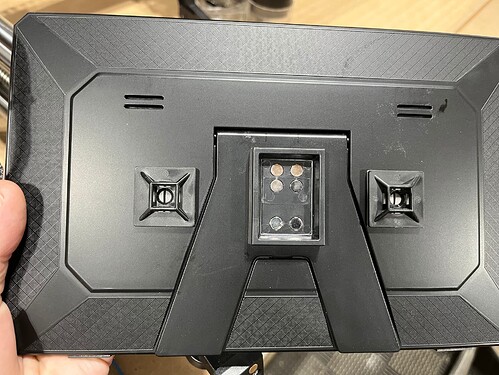

I’m exploring options for replacing the included bracket from Onefinity for my 10" monitor.
Does your 10" monitor have the built in bracket receiver piece similar to mine?
If so does it interfere with the KABCON stand?
Thanks
-Chris
Hi Chris,
Here’s a pic of the backside of my monitor. I have it held in place with double sided foam tape.
The stand has a round hole in the middle, but it isn’t big enough for the monitor bracket.
As you can see, I had to take a Dremel to cut a little of the material out for the monitor to fit.
My monitor didn’t have the 2 square tie wrap mounts on either side of the stand, which yours has.
If they can be easily removed, you should have no problem mounting the monitor like I did.
Hope this helps.
Phil

Thanks Phil,
The 2 square tie wrap mounts were my doing, just to keep the monitor secured better to the bracket. Thanks for showing a picture of the back of the stand.
-Chris
