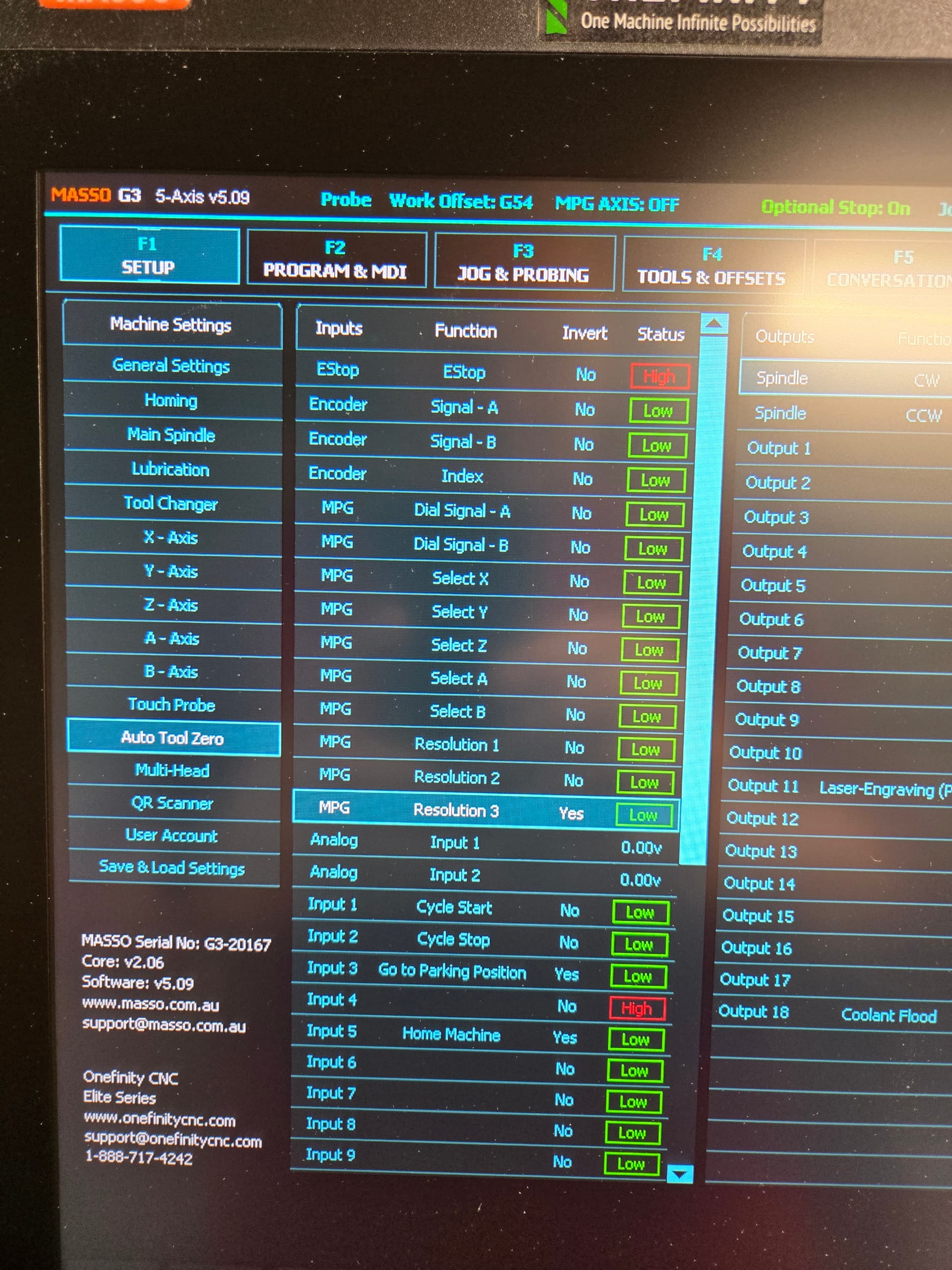

I just installed the tool setter after receiving the Redline spindle. The tool setter triggers when I push down on it. The XY coordinates are positive. As soon as I
enable the tool setter in the F1 screen and set the XY coordinates and try to home it gives me a homing error. If I turn tool setter off I can move the machine around just fine and it homes like it should.
After the homing error if I try to move it its like the Y motors are moving in opposite directions. Then when I turn the tool setter off again it moves fine.

A few thoughts…
Was your machine homing correctly prior to installing the tool setter?
Are your axes moving in the correct directions when jogging i.e., X axis positive moves to the right etc…?
What input have you assigned to the tool setter? I could not see it in your screen shots.
Is the designated tool setter input low, and becomes high when you trigger the tool setter?
We can dig deeper after these are answered.
