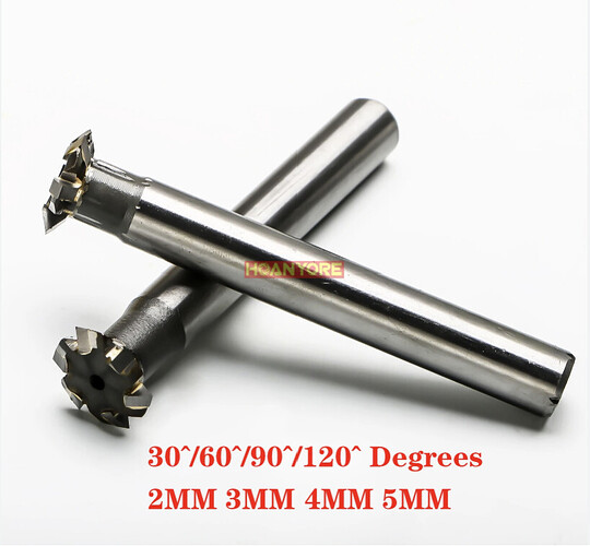

That’s next on my mental challenge. I noticed that’s an option on my Vcarve pro. Will eventually pickup a bit to learn the technique. Just wondering if it’s possible to use a 60 degree bit for a 1/2” to 1” hole?
Hand tapping is hard to keep straight.
Do you mean like a 60 deg. similar to these? Sure, I don’t see why that wouldn’t work as long as the cutter fits into the hole you’re going to thread.
I had seen this option on Estlcam, and was curious to try it out. So I bit the bullet and bought a rather expensive thread mill for this special thread, I think it was something like 40mm x 2mm pitch. But it was a cool experience to do that operation.
