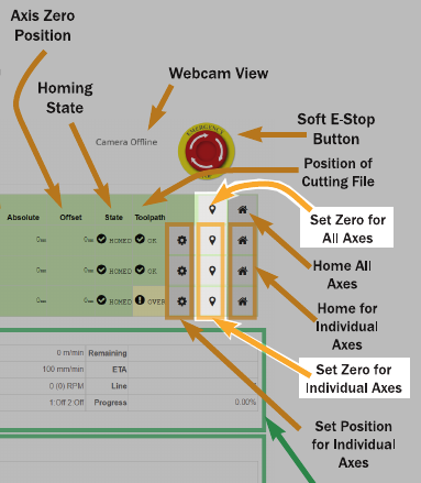

I am trying to carve a bowl on a 18”W x 9.875"H x 2”Thick material. Using Aspire the imported STL design shows perfectly centered. I am setting the XY Datum to the lower left as I always use. After importing the STL I centered it relative to the material. As I said the shown carve in Aspire is centered. When running the carve, it does not center in the material. I rebooted several times, homed the machine and reset the XYZ probe. Same problem. Never had this problem before. Any suggestions?

Hey Richard,
the zero point must be set on the machine to the same position on the real workpiece as the zero point in your software 3D model.
Probing with the touch probe will set zero on the axes you request, but if you probe X,Y on the left corner of the workpiece, the workpiece zero point of course cannot result in being located in the center of the workpiece.
Probing with a touch probe is only one of several ways to locate workpiece zero. In some situations using the touch probe is not possible.
The most simple way to set the workpiece zero point is to manually (gamepad, arrow buttons on Jog Pad on display) move the X,Y axes to the position on the workpiece you want the zero point to be, and then click “zero” on the corresponding axes on display:
Onefinity_Controller__Control_Screen__Mark_on_Zero_buttons_cropped1
Then you can zero the remaining Z with the cnc zero paper method.

I agree there are several ways to locate workpiece zero. I have always used the left corner of the material for XY and set the Job Setup in Aspire to recognize that. It then has always centered the model in the material and cut accordingly. In this instance Aspire is showing the model in the material center as desired. I have contacted Infinity support for their input. As a last resort, I may have to use the method you stated below of moving the axes to the center of the workpiece and probing from there. I just want to understand why this time the carve deviated from what had been working correctly for me for two years.
