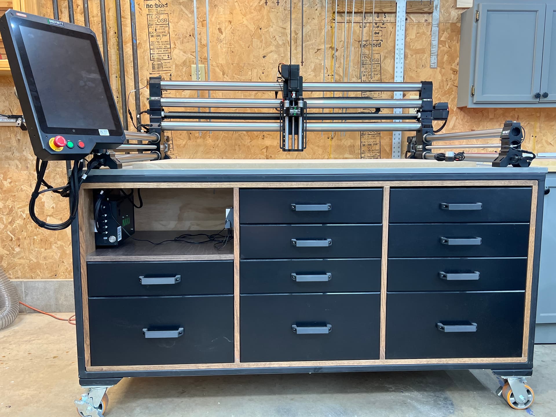

I took a lot of inspiration on all of these table builds so here is my take on a table build. It’s 65x48 and the frame made out of 1" square steel tube. The front half is all drawers, and the back is completely open. Will eventually add a vertical cutting area and a hose boom once I receive my redline spindle. The machine I have is the Journeyman.
Just finished the enclosure. Sides and rear are accessible via sliding doors, and front has bifold doors. The hose kept binding, so I had to raise the middle height with a canopy.
