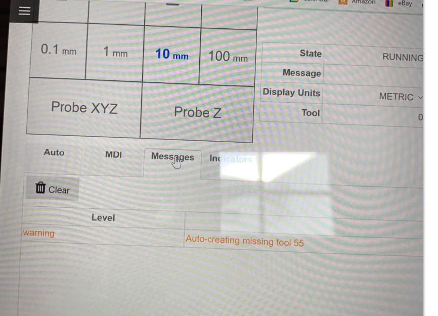

I tried again and got this in messages:

I just tried a new toolpath using a different bit and still have the same problem - same warning just different tool number for the warning. AAAAHHHHHHHH
The missing tool number warning is not an issue, the controller doesn’t use a tool table. I would recheck the connections to the Z stepper motor since you changed that.
Also note the “Probe Z” box is lit up green indicating the touch plate and magnet are currently completing the circuit - if this is not the case there might be something electrical going on.
