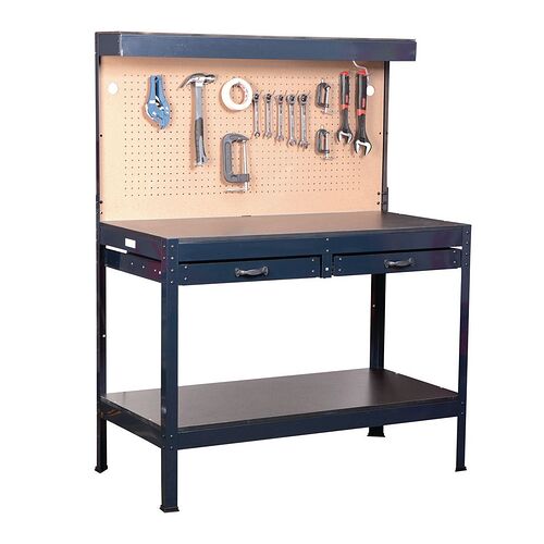

What do y’all think of this welding table from HF as a potential stand-in? Obviously it doesnt roll. But it does support 350 lbs and seems sturdy. With a couple of layers of MDF could work in a pinch… Thoughts?
The dimensions are not so clear but seems like maybe the table top is 30"x20"? Width seems fine but depth? Depending on how high above the pivot a Woodworker might be it could tilt to the max degree and take up somewhat less space. Seems ideal for a machinist btw.
No way. That thing is very unstable for a machine like a CNC. And I am basing that on first-hand experience in that I own one and do not consider it a stable work surface. Plus I don’t believe it’s big enough, even for a 1F Machinist.
If you want to use HF you’d be better off with one of these and it’s not that much more in cost. but you get more work space and a more stable surface. You have a shelf below which you won’t with the welding table, and a drawer. Leave the backboard off if it gets in the way. And it has a light positioned right above the work area.
I’ll agree with Bob, that thing’s going to be way too lightweight. Nowhere near enough rigidity.
Even with using a couple of the basic workbenches as supports, I’d still think about the best way to get the stiffest horizontal surface possible. Torsion boxes, etc.
OK all, makes sense. I actually have one of the other HF tables posted and like it just fine. Fingers crossed that OF can actually get the materials (or whatever) they need to start shipping tables and frames.
