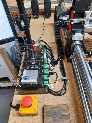

I have a X50 Journeyman and am using Scienci’s Longboard, I have the SLB on order expect it in a week or so.
The Buildbotics controller lacked standard CNC functionality.
You’ll be happy with the SLB, and also gSender for CAM (free)software. They also will have a version without stepper controls that will be used on their AltMill CNC that uses closed loop motors.

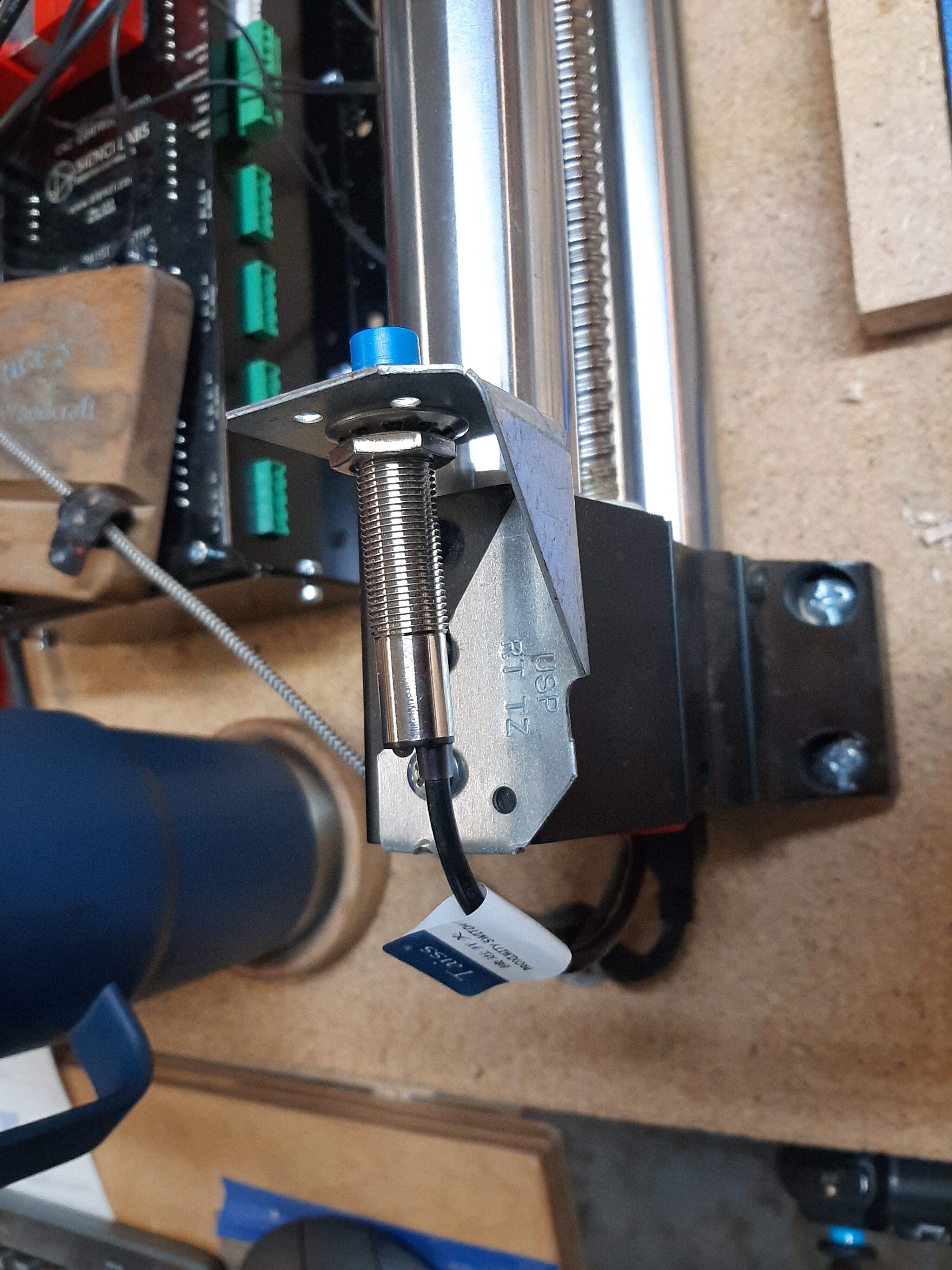

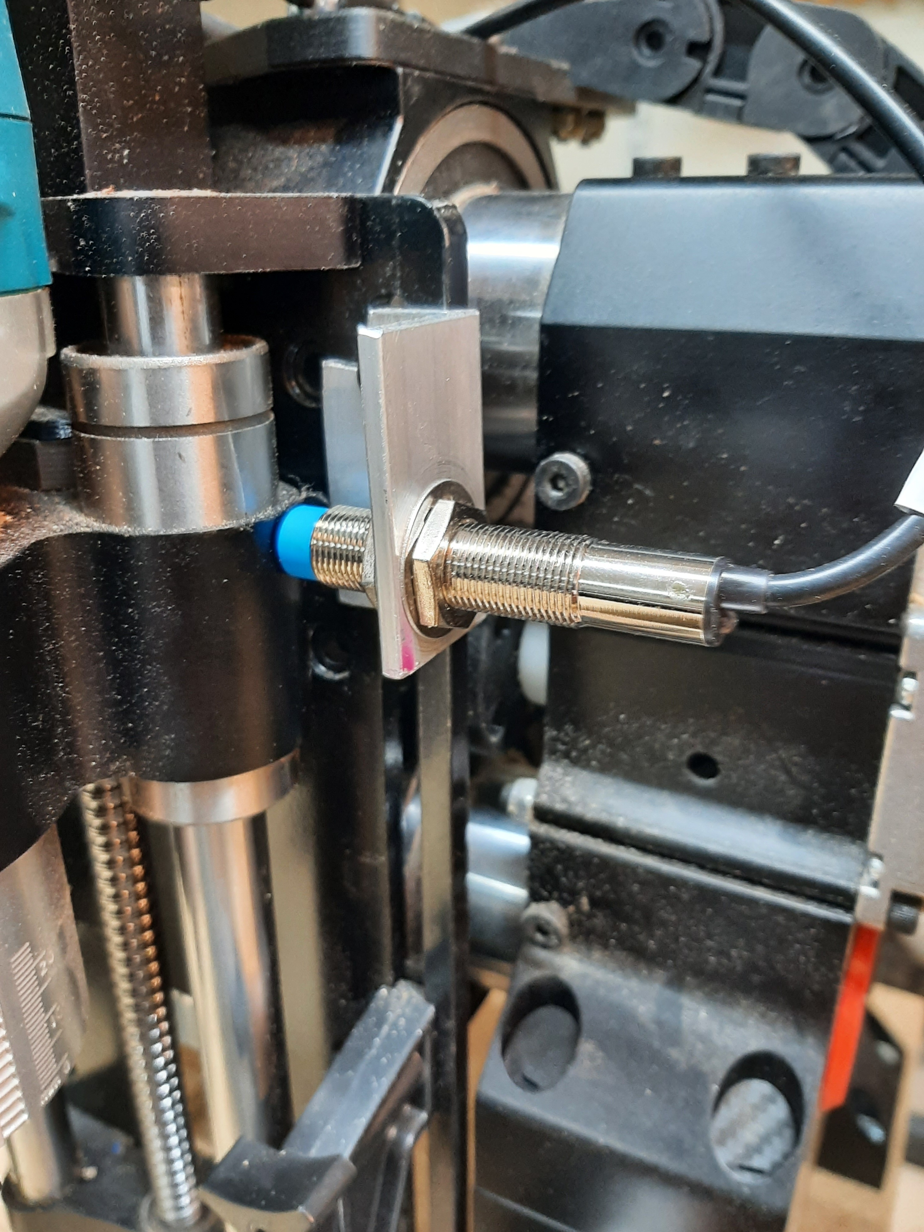

Had to install prox limit switches and install cable adapted for plug type.
See attached pictures. I’ve been working with AtomicCNCDesign on Etsy to make prox switch mounts. I fabricated mounts just to get it working, but you should be able to get some from him. I also got the x axis drag chain supports through him. Check his Etsy shop, tell him I referred you.
I love how the Longboard works and am looking forward to getting the SLB within a week or so.
Also, download the gSender app from Scienci Labs and check it out. I love it, and they’re constantly improving it. They have fantastic support.
Hope this helps.

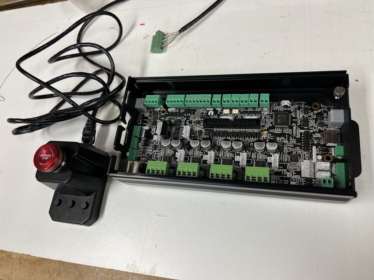

I also purchased my Onefinity without controller, and will be using the SLB as a stopgap while I build up a ‘proper’ controller (since I managed to cleverly fry my G540…). Mine has finally shipped out and should be here mid-week.

I’ve finally started moving on getting my SLB working, and I’m experiencing similar behavior. Lots of variables since I hadn’t completely dialed in alignment, but I was able to jog Y forwards/backwards in 5mm steps without any problem, but any rapid movement immediately stalled the Y motors. I dropped my acceleration down to 300 and this ‘seems’ to work - I’m able to rapid now - but I only got to this point late yesterday and so much more testing is needed. I’m hoping to spend some more time on it today. (I didn’t change my speed settings, but my rapids are short enough and accel low enough that I’m not getting anywhere close to max speed anyway)
I will add though that I originally had my machine set up with an XPro V5 controller, and while it was somewhat less fragile than the SLB, I also ran into Y stalling problems. So, this doesn’t seem to be unique to the SLB (but, the XPro is also a 24V machine)
