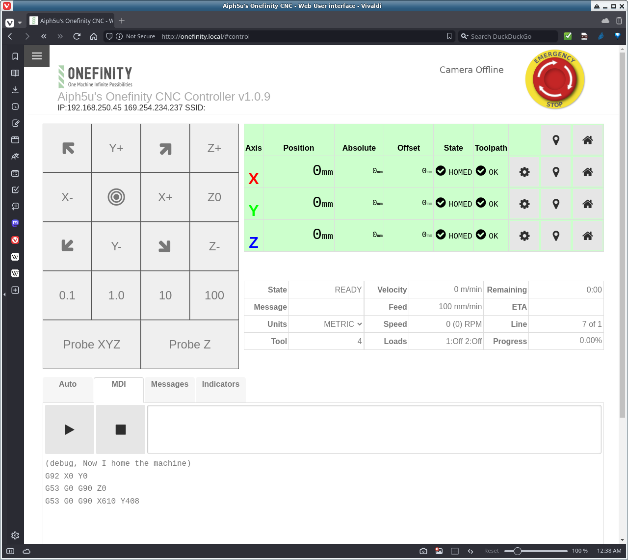

Hey Francis,
I try to reproduce your error, however no limits error appears. Here is what I tried:
G53 G90 G0 Z0
G53 G90 G0 X610 Y408 ; I go to somewhere in the middle of the machine - journeyman
G92 X0 Y0 ; I set an offset here
(debug, Now I home the machine)
G53 G0 G90 Z0 ; I reproduce your position in machine coordinates
G53 G0 G90 X0 Y810 ; I reproduce your position in machine coordinates
(debug, Now I load small_program_journeyman.nc)
; this is small_program_journeyman:
G53 G0 X1220 Y816
(debug, now I execute it – no limits error)
So I don’t exactly understand in what the error you mean consists. I did not find that the subsequent movements referring to G53 (move in machine coordinates) based on the offset. They were obviously based on the machine zero, which is what you expect. Maybe you tell me more exactly what error you see.
