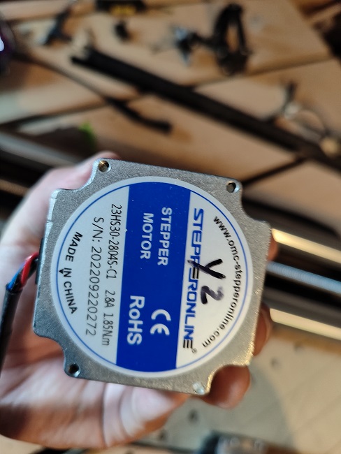

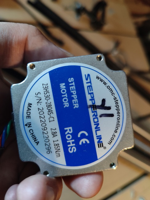

TKC, just had this issues and it took me months of round and round, video after video and tried everything that 1F support threw at me, The end result was the wrong Y motors being installed during manufacturing. Can you get me a pick of the Y motors?
@ScottB Tell me about it, I have been going back and forth for the last week the machine is completely stripped down at this point and just been swapping the motors back and forth. I will play around with the joystick and 1 will stall, swap it to the other set of wires and the same one will stall.
I would say that means its the motor, but something else is funny about this entire situation that I can explain later.
Both Y’s and the X are all 23HS30-28045-C1 but the Z is C5

Well It appears Support confirmed The wrong Stepper motors were shipped out, and replacements being sent.
What Made the issue so difficult to track down, was when I started first being able to trigger the issue It was always happening on Y1 Motor. Both motors were marked to ensure there was no mix up, and after tearing down both rails completely and checking every fastener and putting back together (The first time), The problem mysteriously jumped from Y1 to Y2 motor, and no nothing had been swapped everything was on the same wires. So naturally I thought maybe I need to check all the fasteners again, and did and could find nothing.
I then pulled the motors out and just plugged them in by themselves, and the problem came back to the Y1 motor swapped the motors (Not inner tube wires) so it was just the motor being moved over and the issue would occur again on Y1. So that got frustrating, and the last thing I noticed if you slightly moved the motor it would halt, or if holding it, it would halt and that went for both motors. So yes its been a ride but thankfully they are shipping out the correct motors now. Though I thought I would post my additional findings for anyone else that stumbled upon this thread having the same issue and finding the T.S. process to be conflicting.
