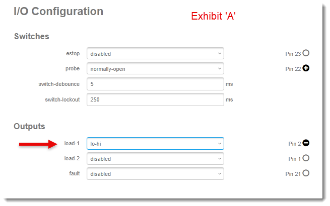

If this were yesterday and the “Buy” button were activated, I would have been all over this. However, the delay gave me some time to think about whether this is really an “upgrade” or a “downgrade” from Buildbotics, which I have now. I love the visual interface of Redline but I have to wonder if there are some real shortcomings elsewhere.
For instance, from what I have been able to glean from the marketing material, there are several things that I am led to believe that Buildbotics excels in that Redline may be a bit short in. Specifically, Buildbotics offers a tremendous amount of flexibility in I/O configuration. For example, if you look at Exhibit ‘A’ and Exhibit ‘B’, Buildbotics allows you to configure outputs to be active logic High or active Logic Low. This greatly increases the level of compatibility when trying to interface to various attached devices. From what I gather from Redline, their outputs just sink to ground and that’s all you get. There is no active logic high, so you have to get a wall wart power source to provide that capability. As if I need something else to plug in, in addition to the CNC controller, VFD spindle controller, laser, air pump, water pump and vacuum…whew, did I forget anything?
Exhibit ‘C’ allows you to configure the output to a cooling system or shop vac that will be controlled when the spindle starts/stops. In my configuration, this is set to logic high when the spindle is on and it is wired to a solid state relay that responds to logic high to turn on the shop vac. The point is, not every manufacturer designs things the same way and removing flexibility really causes you to have to engineer all kinds of kludgy workarounds.
In addition, in reviewing the 25 pin connector on Redline’s motion controller, it would be advantageous to provide a dedicated +5 or +3.3 volt output to one of the unused pins that could be used in conjunction with the outputs.

We produce the motion controller hardware (and software) used in the Redline system. I can answer some of your questions/concerns.
In terms of the I/O configuration (your Exhibit A), Buildbotics does allow you to set the polarity of the output. At the moment, our outputs are just “active” which means the output switch (a solid state relay) is closed when active. It would be an easy addition for us to add selectable polarity. I have added it to our feature request list.
One important difference between the Buildbotics controller and the RTCNC controller is the number of outputs. The RTCNC controller has four outputs versus two outputs on the BB.
Another important difference is the BB outputs are fixed at the supply voltage (36V). This often means level translation or current limiting is required to interface to lower-voltage control hardware.
The RTCNC outputs are dry-contact outputs which, as you pointed out, acts like a switch that can be closed. The RTCNC outputs are also optically isolated from the controller. The BB outputs are not. We feel this makes the system more robust when faced with loads that could cause EMI issues or ground loops.
We went with a dry-contact arrangement so the end-user can easily interface it to any control voltage in their system. You are correct about there being no I/O voltage supply in the controller. This was intentional because including an I/O supply forces the user to a particular voltage standard (see BB above) and adds to the base cost of the controller. The outputs are compatible with voltages up to 50V, so it can be used in 3.3V, 5V, 12V, 24V, 36V or 48V systems (with an external supply).
A complete description of the outputs with interfacing tips is available in the manual here: Inputs & Outputs - RealTime CNC Documenation Hub
This is not entirely accurate as the outputs can be wired to sink to ground or source from an external supply. If you are interested in a schematic for the latter, check out this article from the manual: Connecting an IoT Relay - RealTime CNC Documenation Hub
Let me know if I missed anything. I’m happy to answer any questions or suggestions.
