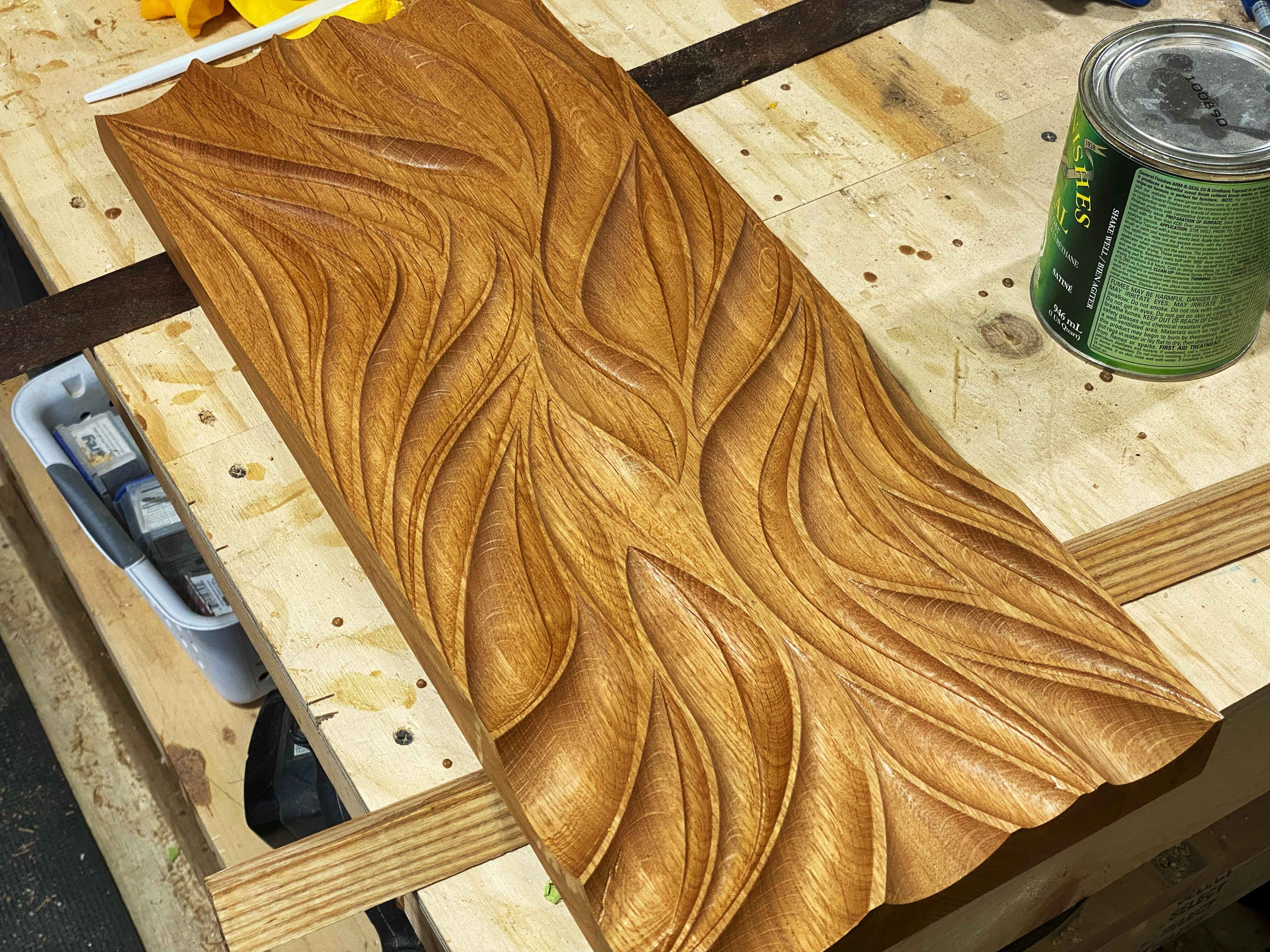

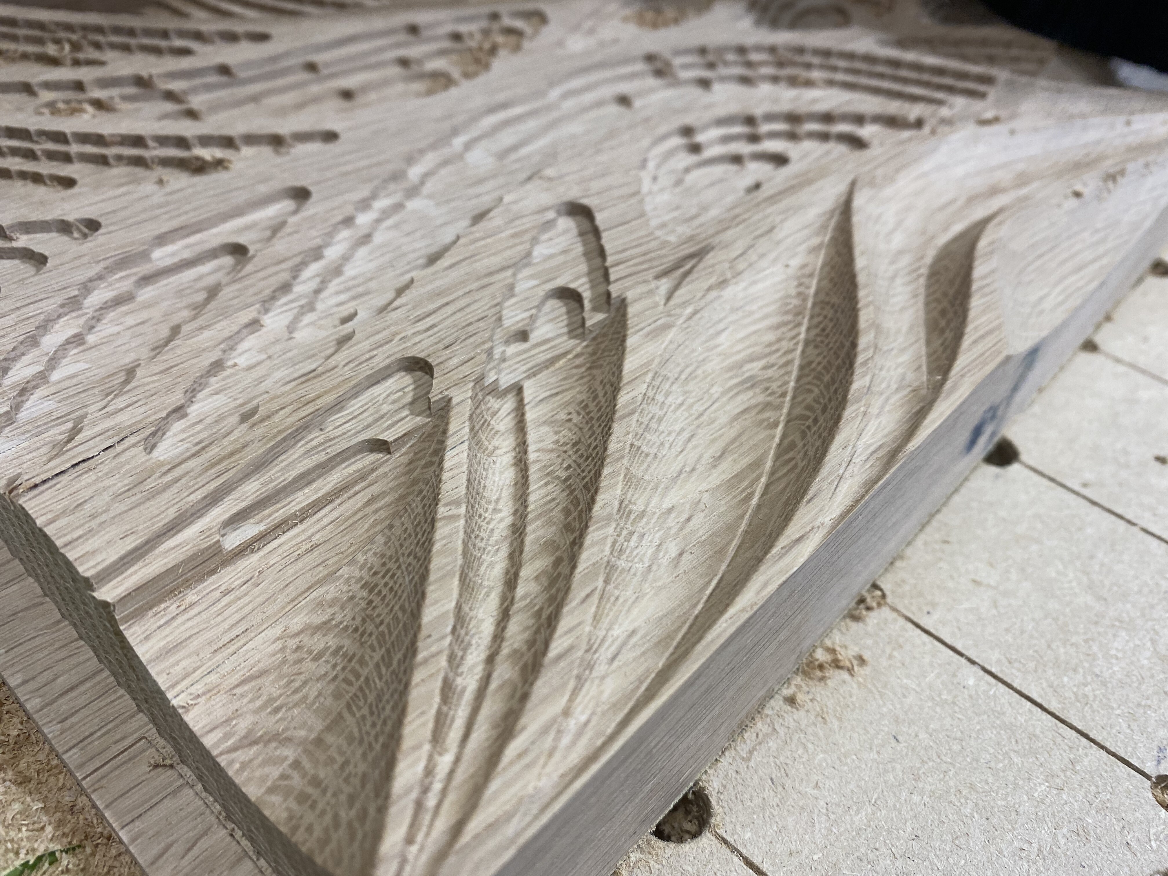

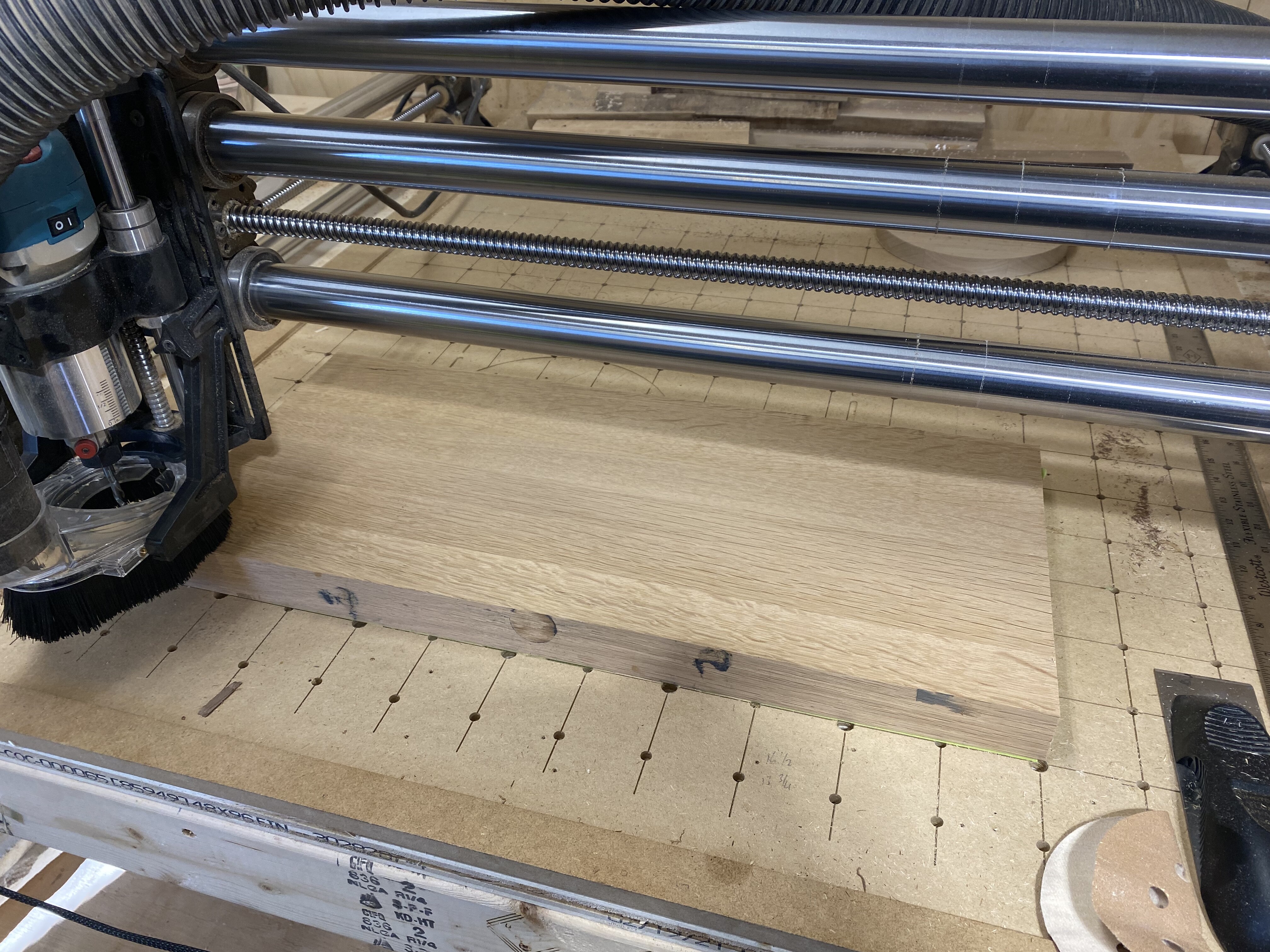

I purchased this dxf file on Etsy. My daughter wanted this for her room. I’ve been struggling with getting this done. After finally purchasing a used PC (I’m a Mac guy) and getting Carveco Maker+, as well as ditching Easel, I successfully made a small test piece out of pine. I’m now in the process of a large test piece made from oak. Total carve time will be approx 10hrs.
Looks like it is turning out really nice! What are the bits you used?
Thanks
Thanks, time will tell! I used a 1/4” down cut for the rough out and then the finishing is with Amana 46280-S

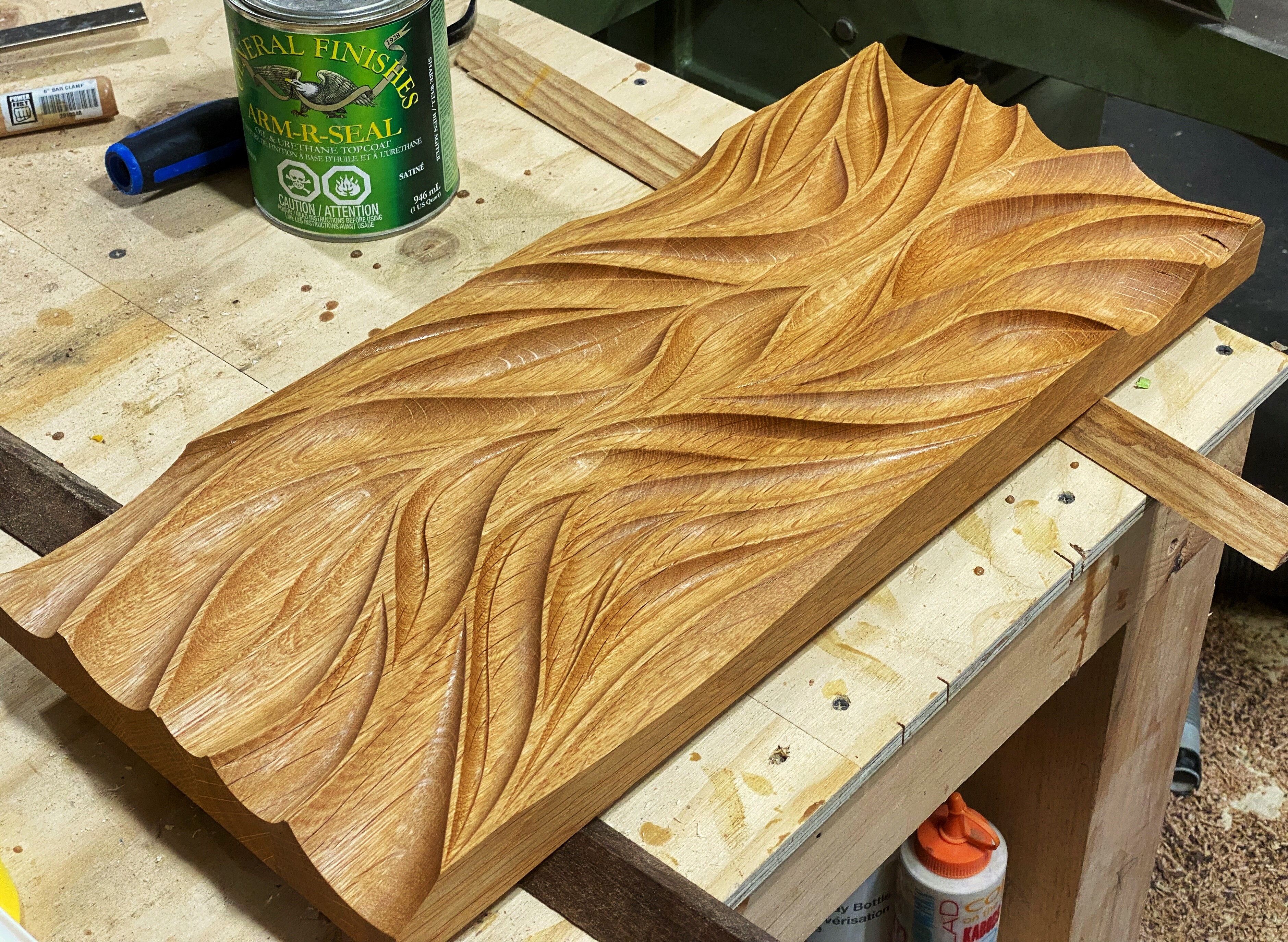

I was going to wait until this was completely done and I took proper photos in my studio before I posted more pics, however I couldn’t help myself. I am so happy with how this turned out.
DXF files was purchased on Etsy. I used Carveco Maker+ for adjustments and creating the code for the machine. Next up will be same style piece but in black walnut.
The finish is incredible, is that out of the machine or did you sand it?
Prior to putting the finish on, I just gave it a light sand with 220 grit to clean up a few rough spots from how the grain was running. Overall, it came out fairly smooth to the touch. I was pleasantly surprised.
