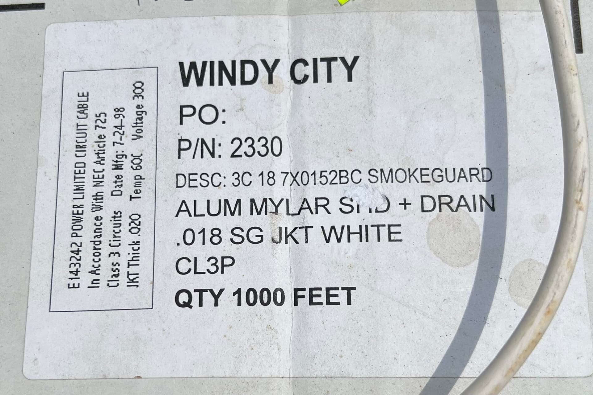

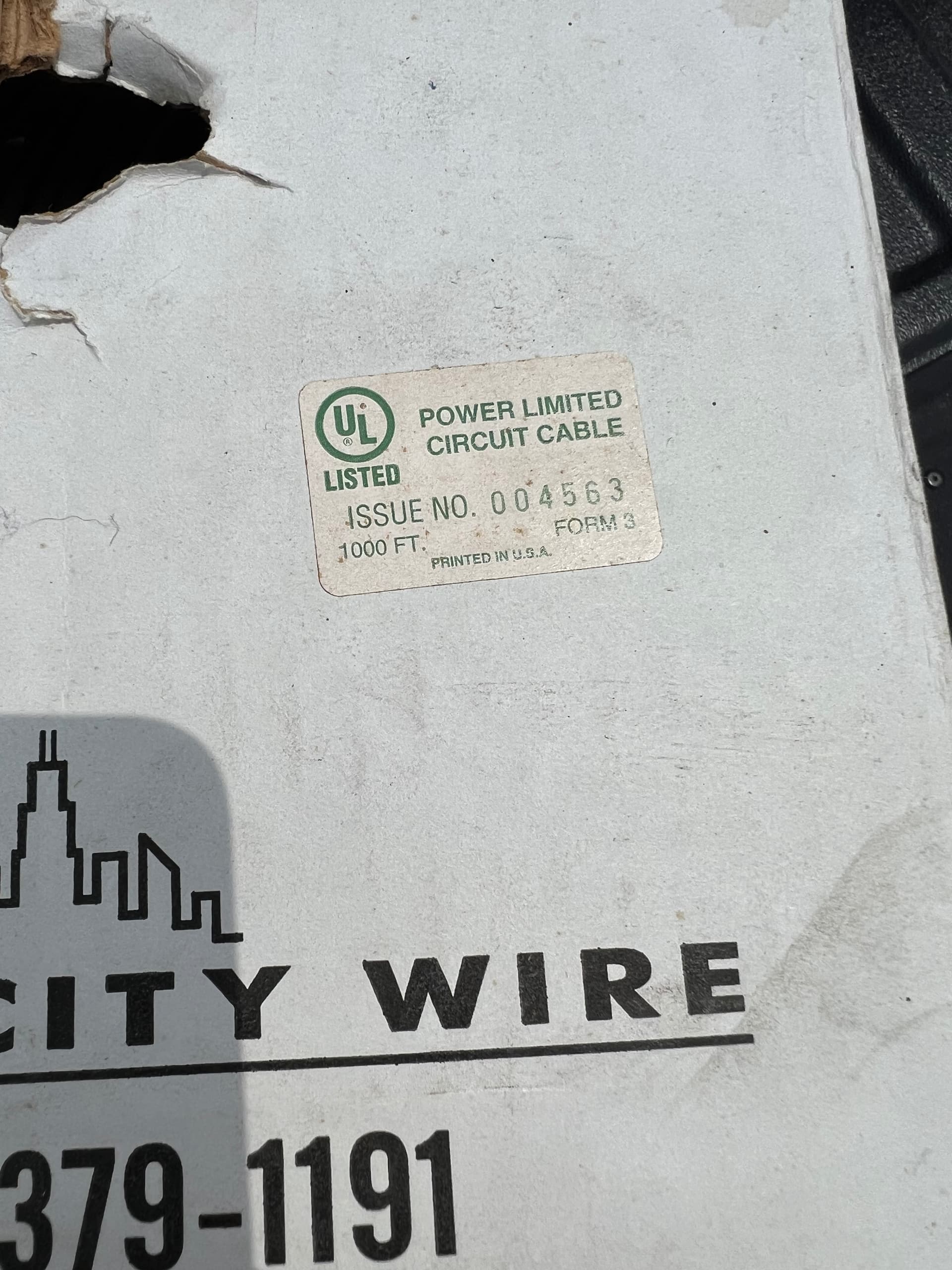

I picked up a spindle/VFD kit. The 18 gauge cable they provided for the control circuit is unshielded. Before buying a replacement, I looked through the cable I have and wondered if the following will work. I understand it is not specifically made for drag chains, but with just under 1000’ at my disposal, I can swap it out as needed.

- How many wires are inside this cable?
For a VFD to spindle cable, you need four wires (3+PE), plus shield.
Could you show the cross-cut?
Hello. From the VFD to the spindle. They provided 18 gauge unshielded cables which I will replace with a shielded cables. The cable I have has 3 conductors so I would run two from the VFD to the spindle.
Hey RikR,
seriously, you need only 5 m, why not buy a real spindle cable. Using two conductors where you need one is nothing serious.
Also this cable is not made for any sort of motion. And seriously, is it really a solution to have it break all the time just because you have 300 m of replacement?
