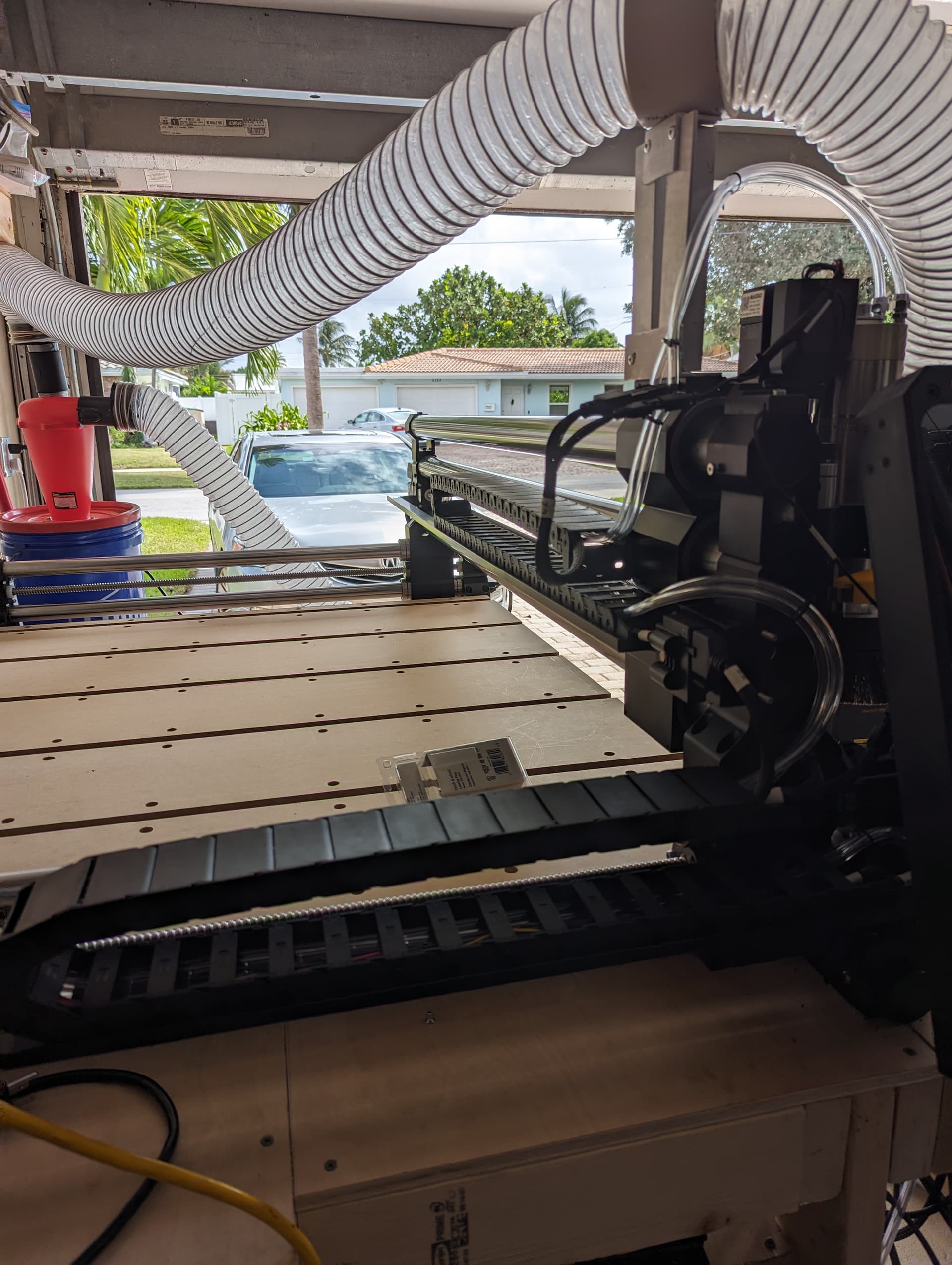

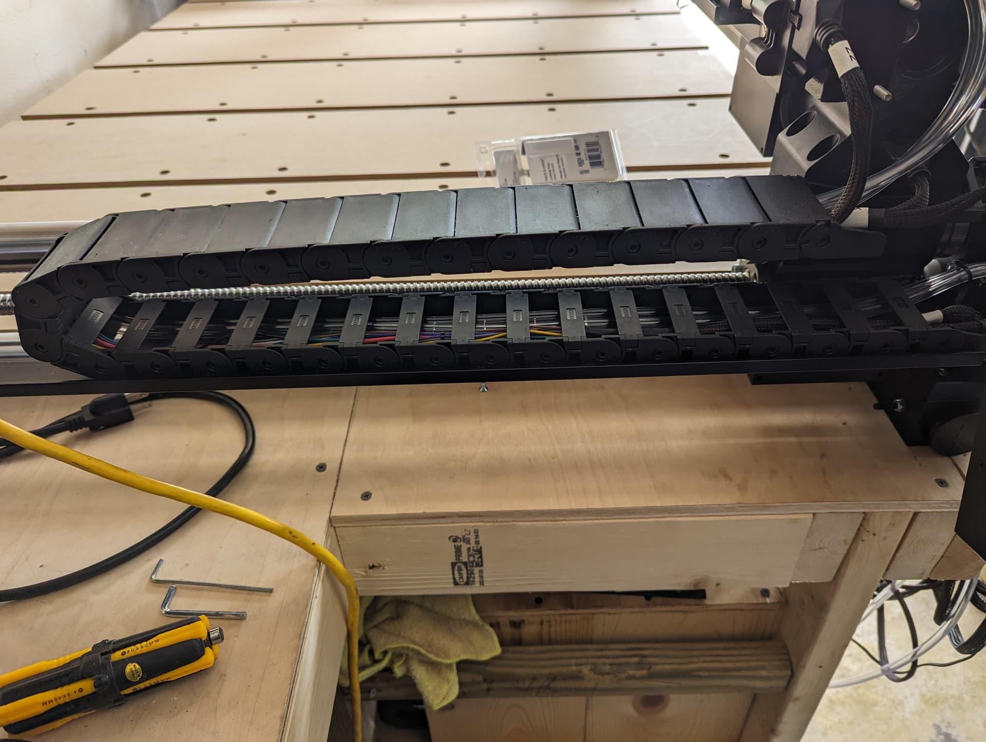

For the hobbyist like me, it is important to note that this cable uses the H17 connector, which is what you need if you have purchased either the 1.5 or 2.2kw HuanYang spindle and VFD.
This cable is not the super flex custom-built one that Vince (Corvettguy50) sells, but it is less than half the price of Vince’s. I have replaced the standard drag chain on my Elite Journeyman with Befenybay R28 Internal Size 18X50mm 1Meter Length Black Plastic Flexible Drag Chain Cable Wire Carrier Inside Open Type for 3D Printer and CNC Machines (18mmX50mm-Inside Open) Amazon.com: Befenybay R28 Internal Size 18X50mm 1Meter Length Black Plastic Flexible Drag Chain Cable Wire Carrier Inside Open Type for 3D Printer and CNC Machines (18mmX50mm-Inside Open) : Industrial & Scientific. I bought 3 meters and used all except about 7 inches of it. This way, I can house all wires, including the spindle, and cooling hoses without using hose clips on the less sturdy original drag chain. I have not yet received the spindle cable but expect it to work perfectly with my setup. I will update if there is a problem when it arrives.
I do not have a 3D printer, so I crafted all the attachment parts for the larger drag chain out of 1.5’ angle and a bit of flat aluminum from Lowes. Had those lying around from other projects. I also built 4’ hose clams from a piece of 4’ PVC I had lying around. I have attached pics for anyone interested. I used aluminum pop rivets to connect the two braces that have two pieces of angle aluminum joined. I used the drag chain base that came with the Journeyman. It is just bumped out to accommodate the wider chain.
Hope this is useful to others like me who don’t want to build their own cables.
