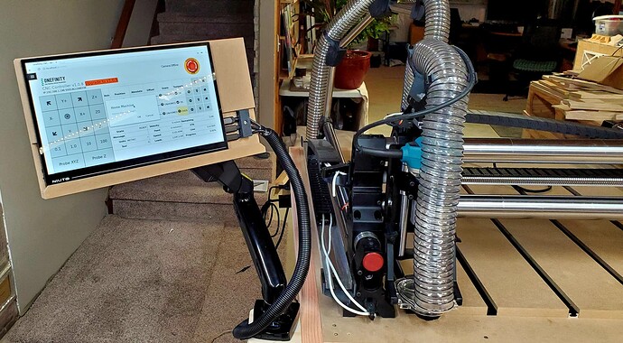

To your point of the cords coming from the right side. The fact that the cords extend as they do from either side makes me nervous. Flipping it would just move what I already consider an issue.
I built this prototype holder. After doing so I think I prefer the cords coming out the right side because they are protected between the monitor and the machine (soon an enclosure). My setup is not as clean as some I have seen but so far its working great. Once the enclosure is done the monitor will be able to fold up flat against the enclosure when not in use.
My shop is smaller and everything is mobile. So I am concerned with things getting wacked as they are moved.

where did you buy the holder and arm for your monitor?
Amazon, here you go [HUANUO Single Monitor Mount - Articulating Gas Spring Monitor Arm, Adjustable Monitor Stand, Vesa Mount with Clamp and Grommet Base - Fits 17 to 30 In https://www.amazon.com/dp/B07T3KCQ94/ref=cm_sw_r_apanp_T52WZEWKKmXdm](HUANUO Single Monitor Mount - Articulating Gas Spring Monitor Arm, Adjustable Monitor Stand, Vesa Mount with Clamp and Grommet Base - Fits 17 to 30 In https://www.amazon.com/dp/B07T3KCQ94/ref=cm_sw_r_apanp_T52WZEWKKmXdm)
I purchased both on Amazon.
