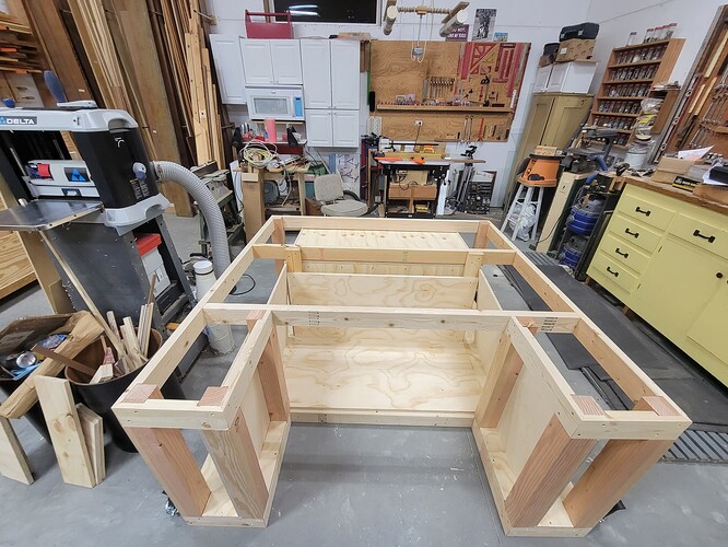

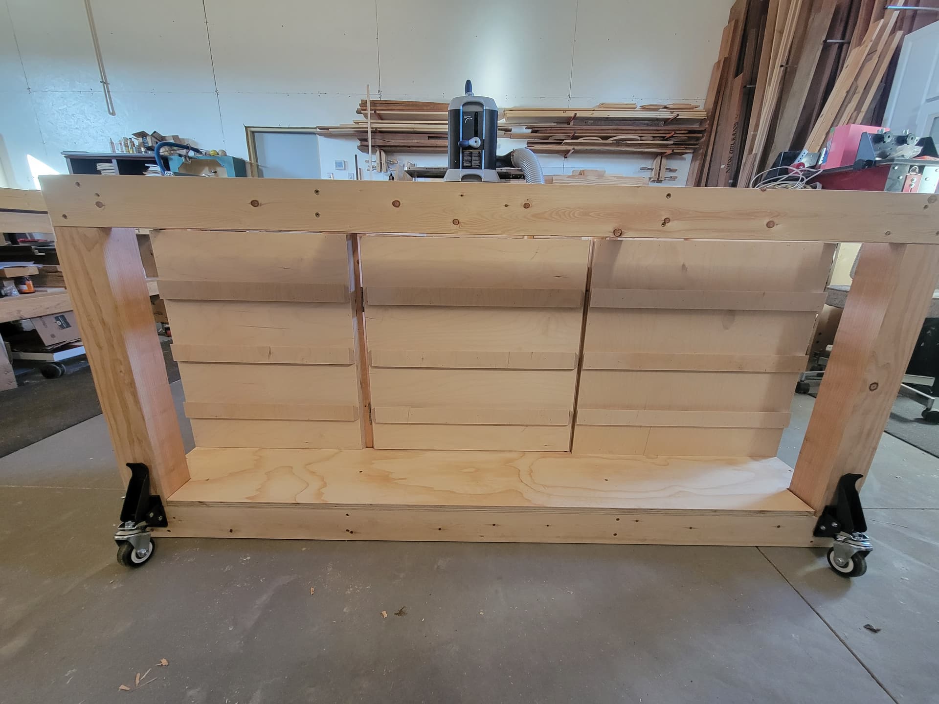

Okay, it’s been a minute since I updated my progress. I the pictures below you’ll see that I made my table 70x70. I have 2 large storage cabinets, french cleats for flex storage and a vertical clamping space at the back of the table.
I have a little trim to add to protect the mdf, but should all be ready when my Foreman arrives on Tuesday.
Hey Wes,
I like the joints you made, and the table looks good.

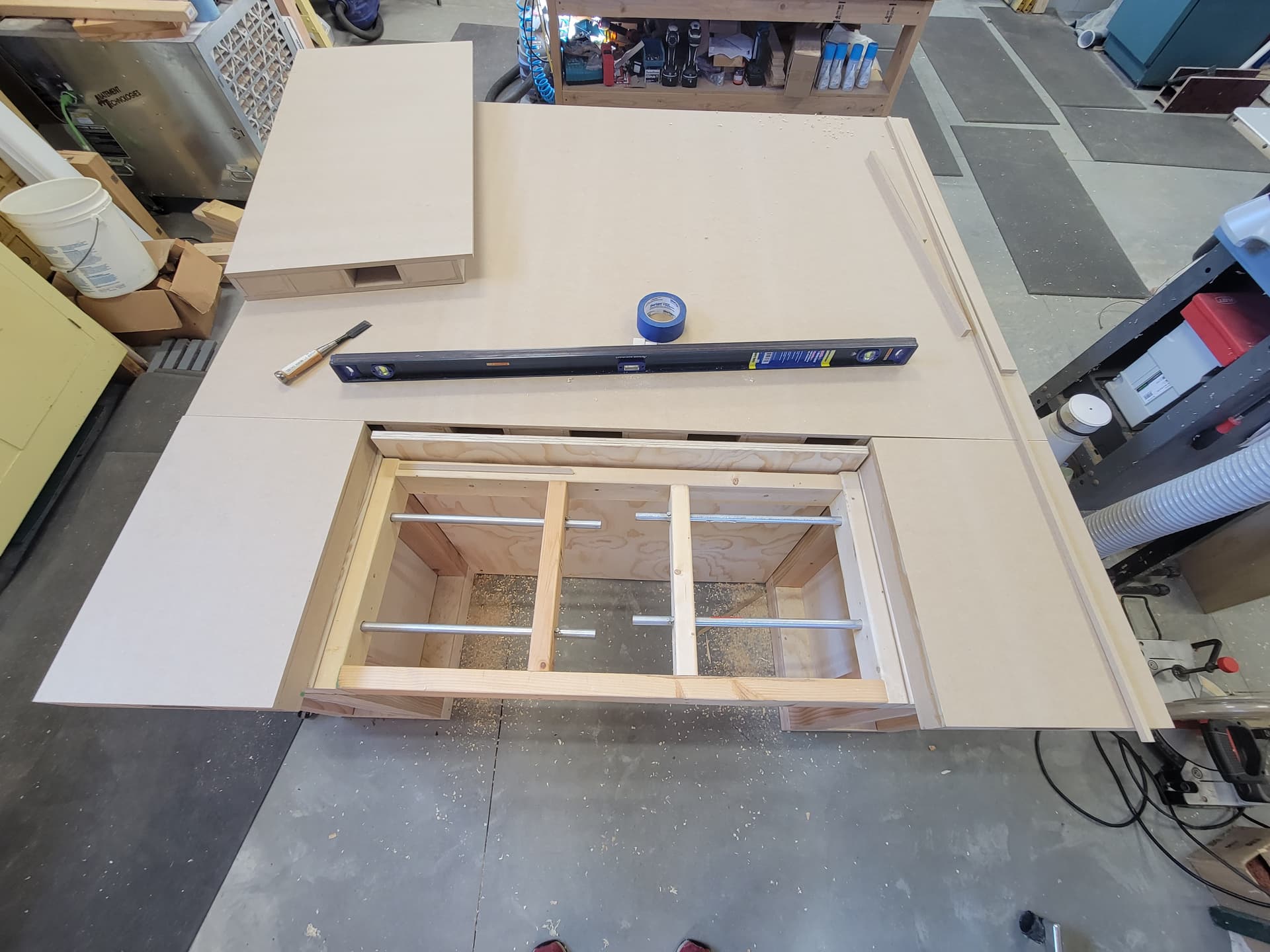

I hope you don’t rely on your floor alone when it comes to adjusting the coplanarity of the machine. Do you plan to use the QCW frame with the leveling feet with this table?
Funny you should ask, on my assembly/finishing table i put leveling feet in the torsion box top, but Ive checked level across the top of this table and everything checks out as level. I was curious if i would need to use leveling feet.
Hey Wes,
since you have casters it is imaginable you move the table around, and usually the floor is not always the same everwhere. Also I don’t know how you check for twist of the machine, but checking with a one-bubble level is not accurate enough. Usually to detect twist (which is to eliminate before use of the machine), the fishing line method (over the rails of the machine) is much more accurate.

So ive put my Foreman togeter on my table and im glad i made the top 70x70. The larger footprint provides an extra buffer to protect the motors from being bumped accidenttly.
Now I’m thinking that ill need to make the spoil board a full inch. The Makita doesnt seem to reach low enough with the z slider in the lowest position.
