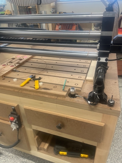

Here’s a few shots. Of the setup without my dust collector hose hooked up. As mentioned I’m glad I went with 70 inches square. The motors are within the footprint and there’s just enough room to set a tool or tape measure alongside the machine.
Posted table with elite journeyman mounted finally on another thread.
Its tight. Would recommmend going a couple inches wider at least.
Also will need to add some stability to it. Wobbles back and forth more than i like. Seems to work fine but would just lile more rigidity.
Also not able to flip x&y like i was planning until extension cables are available… not a huge deal.
Looks nice. How do you stow the controller in your storage position?
Thanks. I do like how the overall turned out.
Well. Havent tried storing it yet as ive been trying to cut with it and havent wanted to put it up yet
but for the time being i will have to remove the masso to flip it. That is unti extension cables are available.
When i was installing the machine i did test it and the flipping worked fine. Very heavy with the gantry at the bottom so it wouldnt move. Will fix it to the centerpoint when i do it again in the future to help center the weight on the piviot point.
Well for anyone following the flip top elite build thread i actually put in the store position today to move some stuff around. worked better than i expected.
I made inserts for the gantry so it wouldnt move and stayed on the pivot axis to make it easier to flip. Still heavy but manageable.
Had a verticle hold only on one side which works but with the weight its too much and would flex the table if i left it. So thats on hold till i have a more robust holding solution. May just have a stop block on the other side to keep our from flexing.
I did have to remove the masso but isnt that big of a pain and my lower drawers are the perfect storage for it while stored.
Granted it’s tight but fit like a glove
