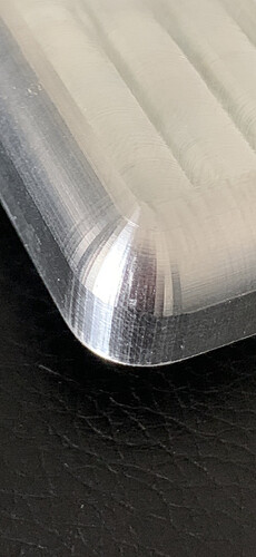

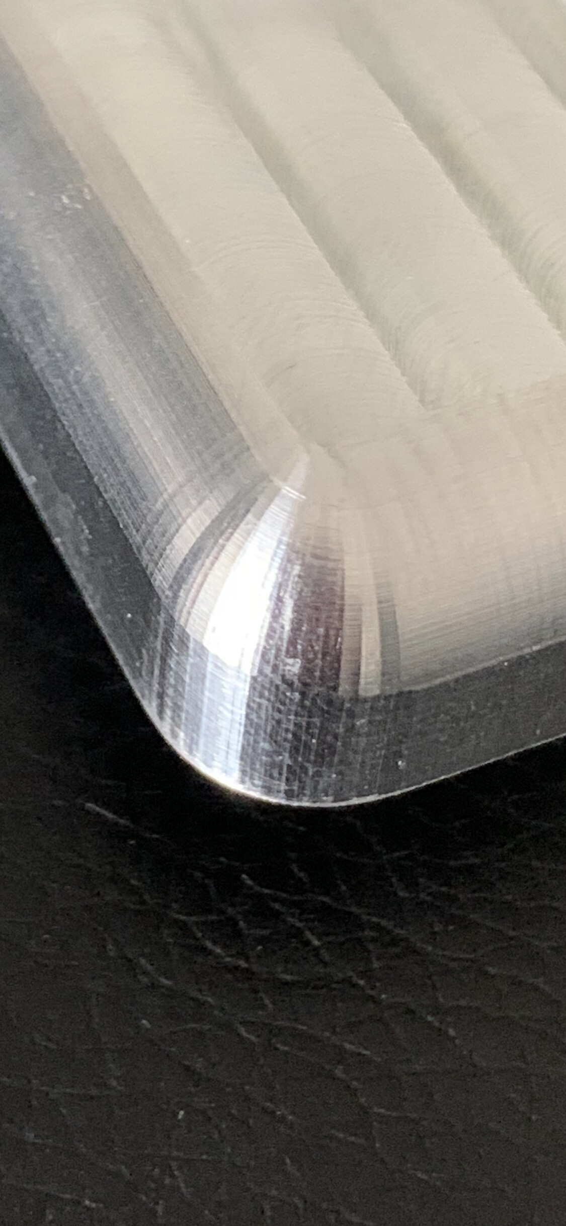

@Techrise No not in any sort of detail. Talking to 1F support is like pulling teeth in my experience. The only thing they added was to update to 1.0.8 (I am still running 1.0.7) as they have made some changes to try and decrease the faceting/stepping around corners. I have increased my microsteps in the controller to try and increase the resolution to combat this. I found the machine runs much smoother and the finish quality even on roughing passes is greatly increased but the stepping around corners is still there, plain as day. In wood, completely unnoticeable. In aluminum, sticks out like a sore thumb. This is why I decided to omit the controller when I ordered my Journeyman model. I am going to upgrade to the centroid acorn and a set of digital closed loop stepper motors for my machinist model and use this 1F controller on the Journeyman.

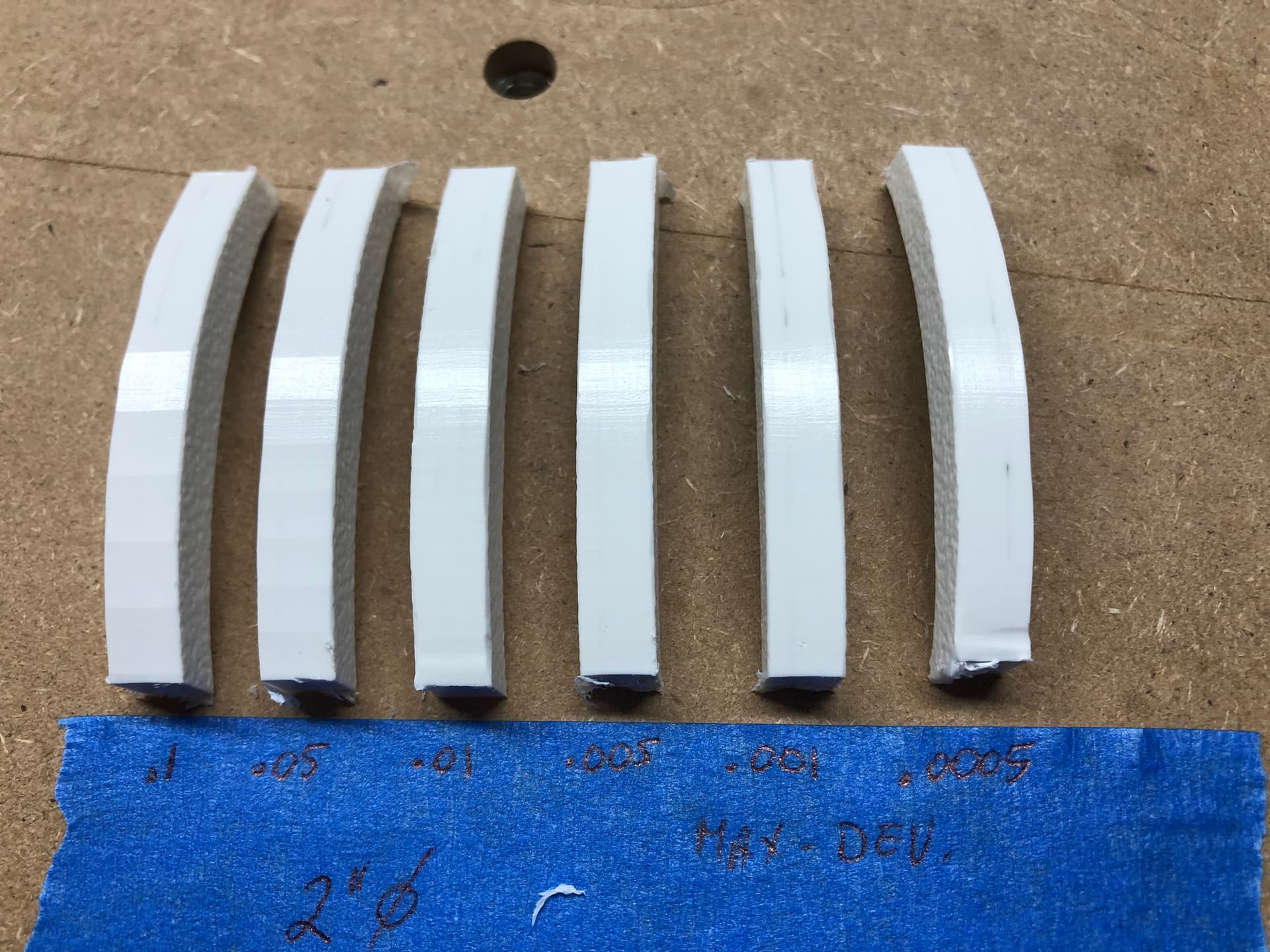

@WaywardWoodworker do you have any pictures of the aluminum milling around corner segments for comparison? This is the faceting/stepping I’m referring too. If 1.0.8 is all that much better I will consider installing it.
I’ve not cut anything with a radius less than about 2 inches, I didn’t notice anything like your picture but I can’t say it wasn’t there. Next time I cut a part I’ll take a closer look at it.

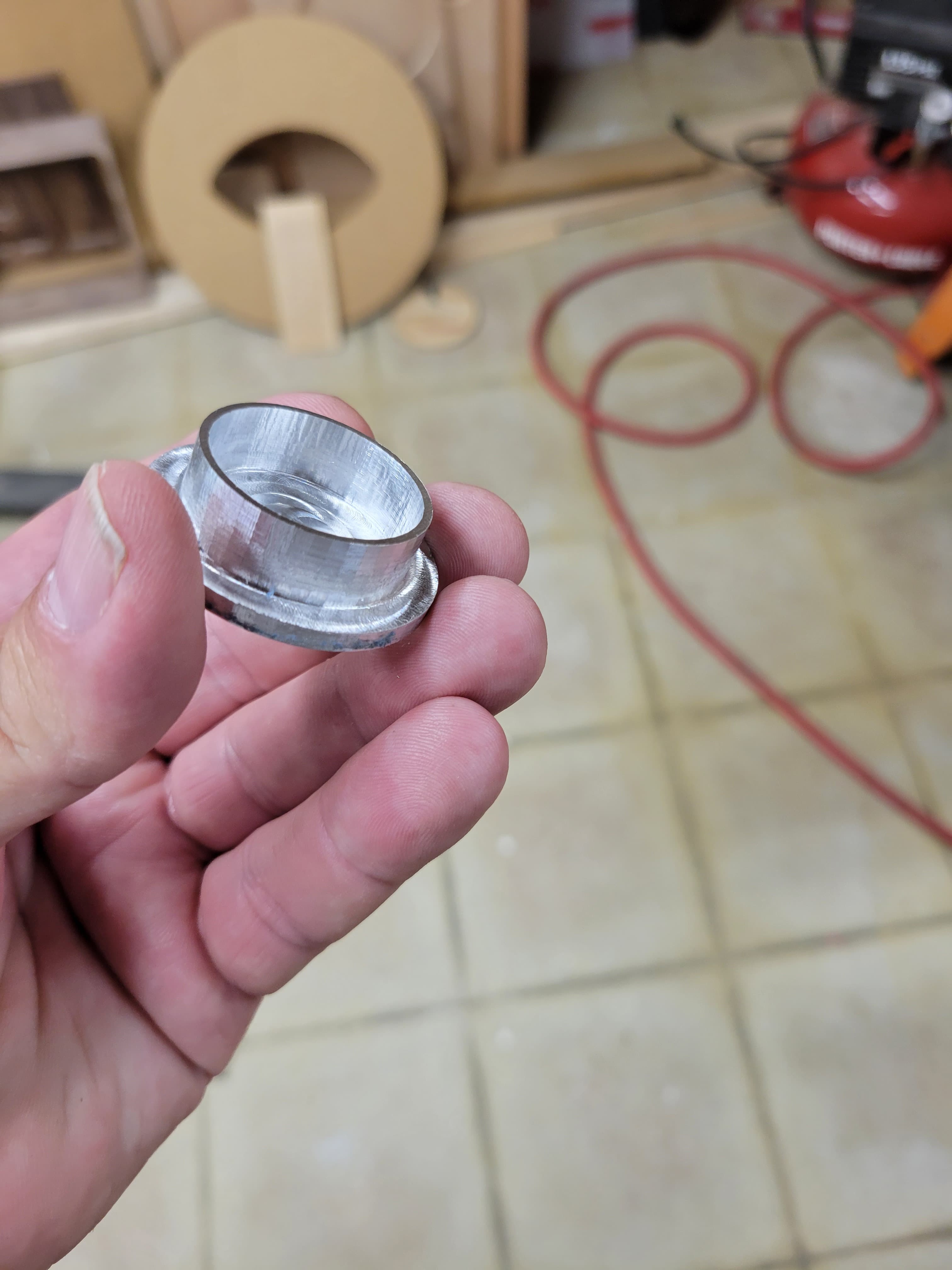

Nice plug none the less, good job. Is that an end cap for the 1F? Also gotta ask, are you running 1.0.8 firmware?
@alldaysammyj. Yes it’s a cap for 1F. Diameter is a little big so need to make one slightly smaller. Yes I am running 1.0.8.
