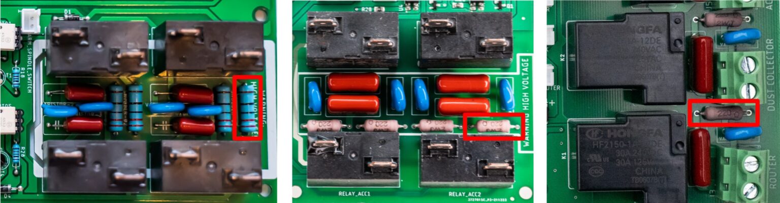

Hello ! I followed your tutorial to hack my Makita router, and everything goes well until I plug it. Then it blinks red, unless I unplug one of the black wires on the relay. Wich means that even if the relay is of, I have a contact between my two black wires. I tried with two différents relays and the result is the same… Have you an idea of what I did wrong ?

Hi, Just like Sebastien (May 23) I have followed (closely I believe) the clear instructions to hack the Makita RT0702C and the result is the router doesn’t work and the blinking red light is all I get. Any ideas why?

If you are using my remote control panel -pcb the problem is probably the snubber circuit on the relays. these prevent sparks and electrical noise. However, this circuit can create a small leakage current which might activate the anti-restart function failsafe on a Makita router.
If the router’s red LED is blinking, you must disable the snubber for that relay. Because the Makita has its own internal soft-start motor controller, the relay does not switch the inductive motor directly, making our board’s snubber circuit unnecessary.
To fix the issue, use a small wire cutter to carefully cut one leg of the snubber resistor for the router’s relay on the circuit board.
Cut one leg of the resistor in the red marked box. From left to right: PCB V1, PCB V3, PCB V4
